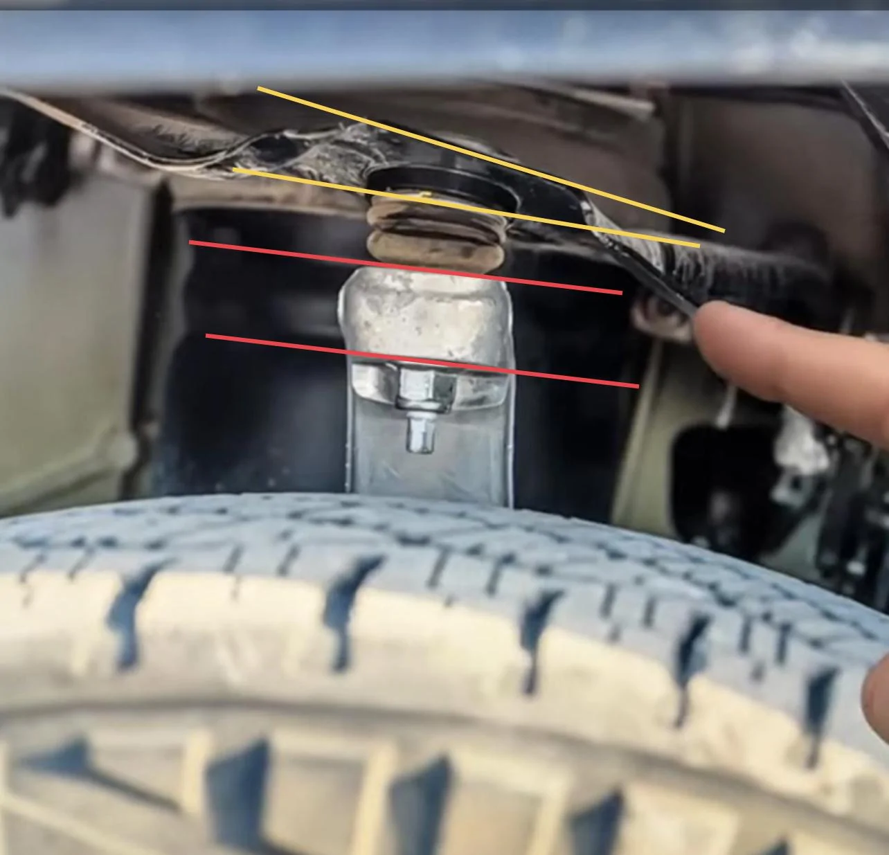

The upper is not bent, IMO, simply a different viewing angle causing it to appear that way. You would have to ask yourself, what would have impacted it to cause it to bend upward? Other components would have needed to fail before the upper control arm could have been pushed upwards by an outside force. Launching the vehicle in Baja would not have done this either, as this is a pivot point for the upper ball joint. Rather, the strut tower would have likely blown out, or the chassis control arm mounts would have ripped. I'm leaving it at that...

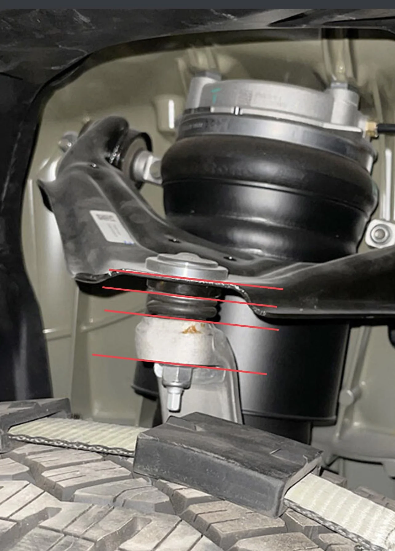

It’s absolutely bent. Don’t focus on the arm. The Ball Joint is destroyed.
7,153
13,769

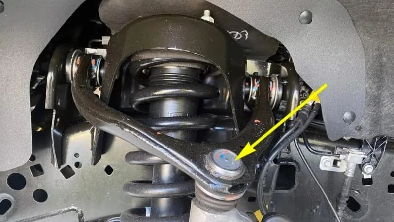

Those pictures aren't from the same angle so they won't line up like you are showing. You can't even see the label in the top image.
the picture isn’t intended to show the angle of the yellow line, though
it’s intended to show the departure from the yellow line, and the angles of other pieces relative to it
maybe it’s better displayed this way, here with these red lines all being erfectly parallel:

in contrast:
Tesla Cybertruck Cybertruck engineers bend upper control arm in testing 6B45D1E8-BA24-4F5C-8CC1-F2E33AD206C0

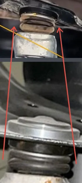

@cvalue13 did a nice job with the pictures and lines.
Just look closely at the rubber protector and you can see it is deformed/compressed pretty differently.
Hard to believe people are defending this at this stage of development.
Tesla Cybertruck Cybertruck engineers bend upper control arm in testing 1flOvLI
Yes, the two photos are at different angles, so no, I don't see how it's deformed.
The lines of the lower bulb (in the supposed upper image) are parallel. They wouldn't be if the arm was bent.

Great close up’s. You can see the difference in the upper ball joint rubber boot.
The Cybertruck would have to encounter one hell of an impact to bend an upper control arm.
Tesla Cybertruck Cybertruck engineers bend upper control arm in testing 1698272485523
Tesla Cybertruck Cybertruck engineers bend upper control arm in testing 1698272534028
Curious. To me one looks compressed and one looks opened up.
Yeah, but do you see the difference in photo angle? Look at the wider shot and the distance between the arm and the well cowling in the two images.
Can you show the line that's supposed to have bent?
'Cause I'm not seeing it. Is the bottom one normal?
I was going to ask this yesterday already:
You really can't see how it's bent up on the end?
