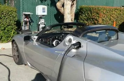

You need to show your work. All I am finding is this: https://www.tesla.com/blog/smarter-charging
Tesla’s V2G Strategy
Tesla Cybertruck Cybertruck needs to have vehicle to home charging (V2H) v2g_test_vp10
Test setup with VP10
Tesla’s initial approach to exploring V2G is to focus on ancillary services that can be performed with the vehicle operating as a grid-controlled load, rather than as a system capable of feeding power back to the grid.
