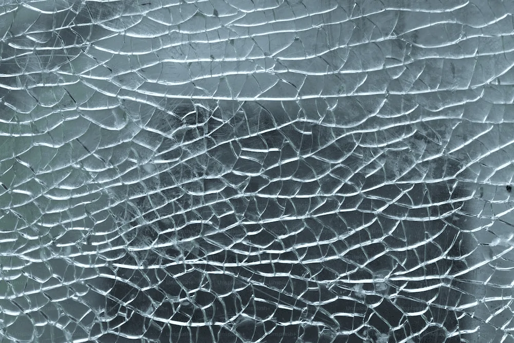

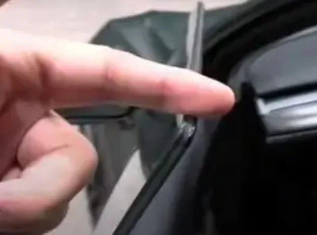

I'm not sure which is worse, "glass beak"
Tesla Cybertruck Cybertruck Prototype Glass Window Manufacturers -- AGP vs FUYAO 1689985747748
or lamented glass
Tesla Cybertruck Cybertruck Prototype Glass Window Manufacturers -- AGP vs FUYAO 1689986024560
Tesla Cybertruck Cybertruck Prototype Glass Window Manufacturers -- AGP vs FUYAO 1689986324093
I think lamented glass is when you're really sorry you broke your neighbors window.
