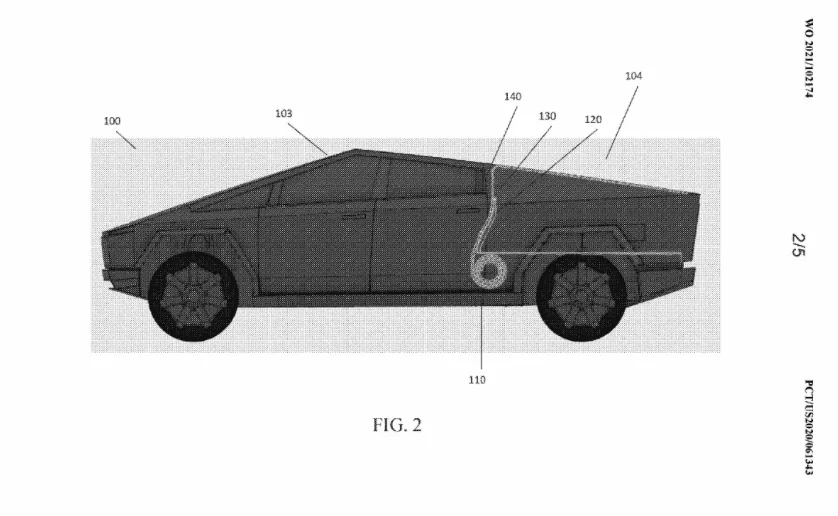

It also doesn't have to roll...could just open and close like a garage door..travel path like a C. I'm thinking if u roll the cover over itself more chances of things getting caught inside the roll creating a jam...vs a C much smoother and less things over lapping. But who knows ?
That would be a really terrible shape, structurally.

Was it the patent which showed it as rolled ?
Almost forgot :D
Tesla Cybertruck Cybertruck Range Prediction + Cell Calculation + More [Sources] 1658929185860
Big flat voids would be structurally unsound. It's bad enough it's going up through the middle of the truck.
True, good point.
I think the cover can be wound and still have room for the pack underneath. I feel very strongly that the structural pack will be the length of the inside wheelbase, casting to casting.

Tesla can just uncoil that patented disappearing cover and reverse it. Mirror image reversed at rear execute the 90° bend foward toward the passenger compartment between the tailgate—casting distance. Once engineers overcome that bend in a 5” round mechanism, the cover can be stowed horizontal flat beneath the bed. Residual cover length can park/rest on the roll.
Yes, its more complex, involving additional power at terminal ends rather than patented single motor mechanism. So split the tonneau. Baby partition for pass-thru security and Bed tonneau only driven from rear.
Firetruck41
Ben
Jan 1, 2021
247
451
SW Washington
2013 Leaf, 2017 Bolt, 2010 Ram 2500 Megacab
Doesn't make sense to me, I'd rather be able to partially close it as it is shown to operate in the patent. When partially open (partially closed if you are a pessimist), it would still substantially protect items under it from the weather, while driving. The way you propose, it seems it would collect rain/snow while driving and funnel it towards whatever was under the partially open cover.

Having the partial opening at the tail gait is critical for carrying longer items. Pipes, lumber, and other items need to hang beyond the bed by resting on the tailgate. If it opening is at the top of the vault you can't do this.

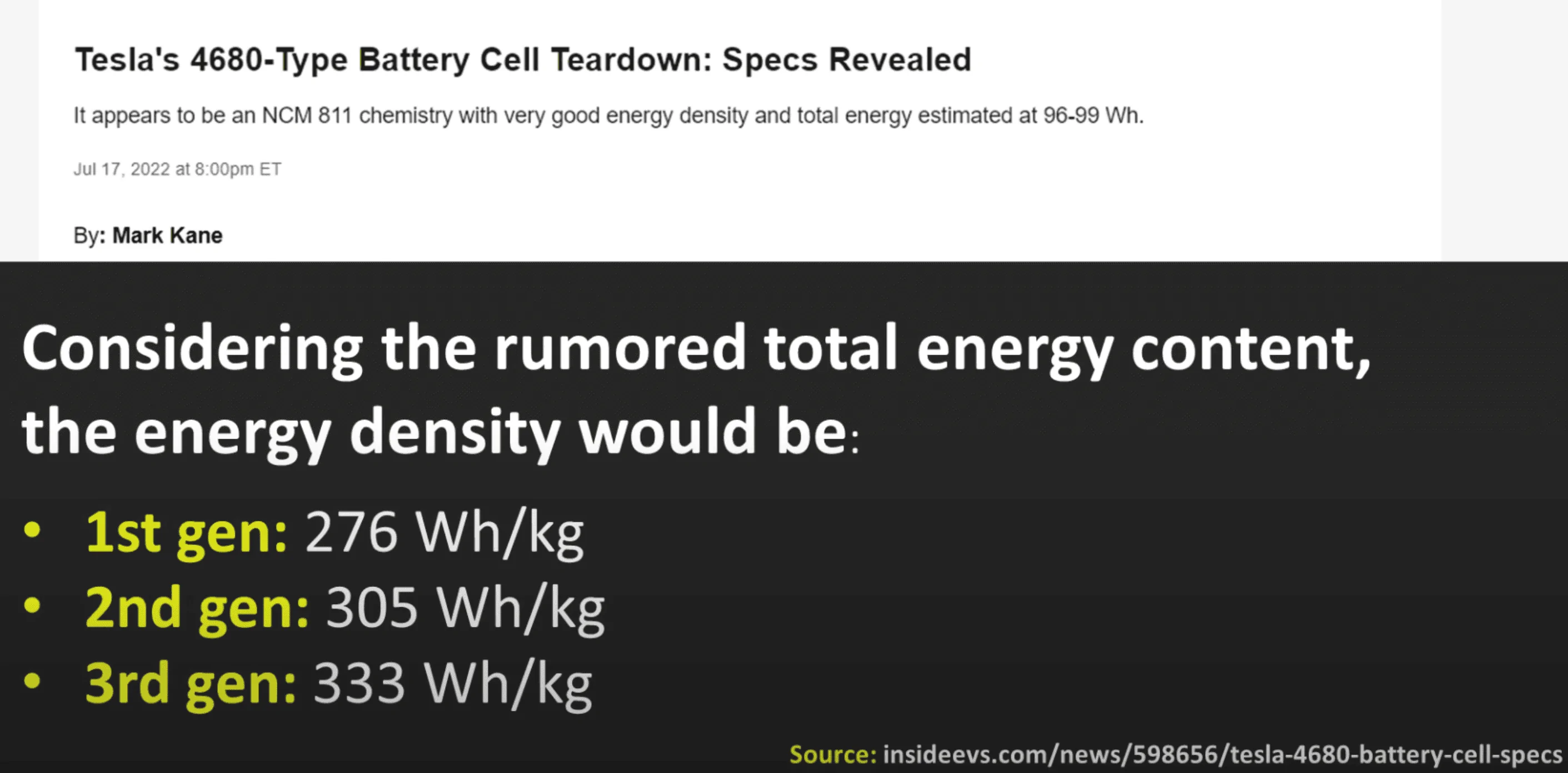

Just want to update this thread, based on Generation 2 4680 cells that are starting to be produced at Kato Rd it is rumored to be about 10.5% energy density improvement over Generation 1. That implies a minimum of 110.5wh of energy capacity per cell. For 1450 cells that would equate to a ~160kwh pack. For 1520 cells it would be ~168kwh. More accurate estimates to follow after Munro breakdown of Generation 1 4680 + another limiting factor analysis.
New lower-bound range estimate: 400 - 420mi

I feel that Tesla will keep the vault cover within the hinged section that folds down. Think a U shape. I mean, the cover will have to be 6.5 feet long. The height from the front of the cover to the bottom of the pass-thru door would be more than 3.5 feet, enabling the cover to be retained into the folding door beneath the window... Why even have a window back there? If it's anything like the rear window in a model Y, it'll be basically useless.
Yeah I see your point. I think i'd still like a window just in case I want to roll up the bed cover and get some cross breeze or extra sunlight on a nice sunny day. But your logic is sound!

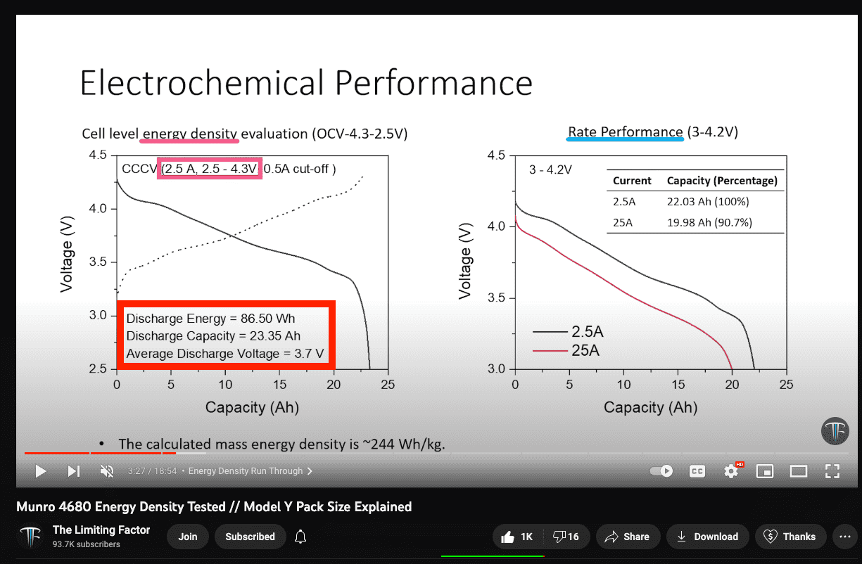

Unfortunately in the latest teardown of a brand new 4680 cell from Jordan at The Limiting Factor it showed a total capacity of 86.5 Wh per cell. This is lower than expected. And while I still believe Tesla can easily move chemistry and move that capacity higher it likely won't be substantial enough to break 500mi on a single stack pack.
Some have predicted that the Cybertruck may sport a double stack battery pack - I am still skeptical. All this said I will have to revise my range estimate down to the lower end. 369-420 miles of range.
