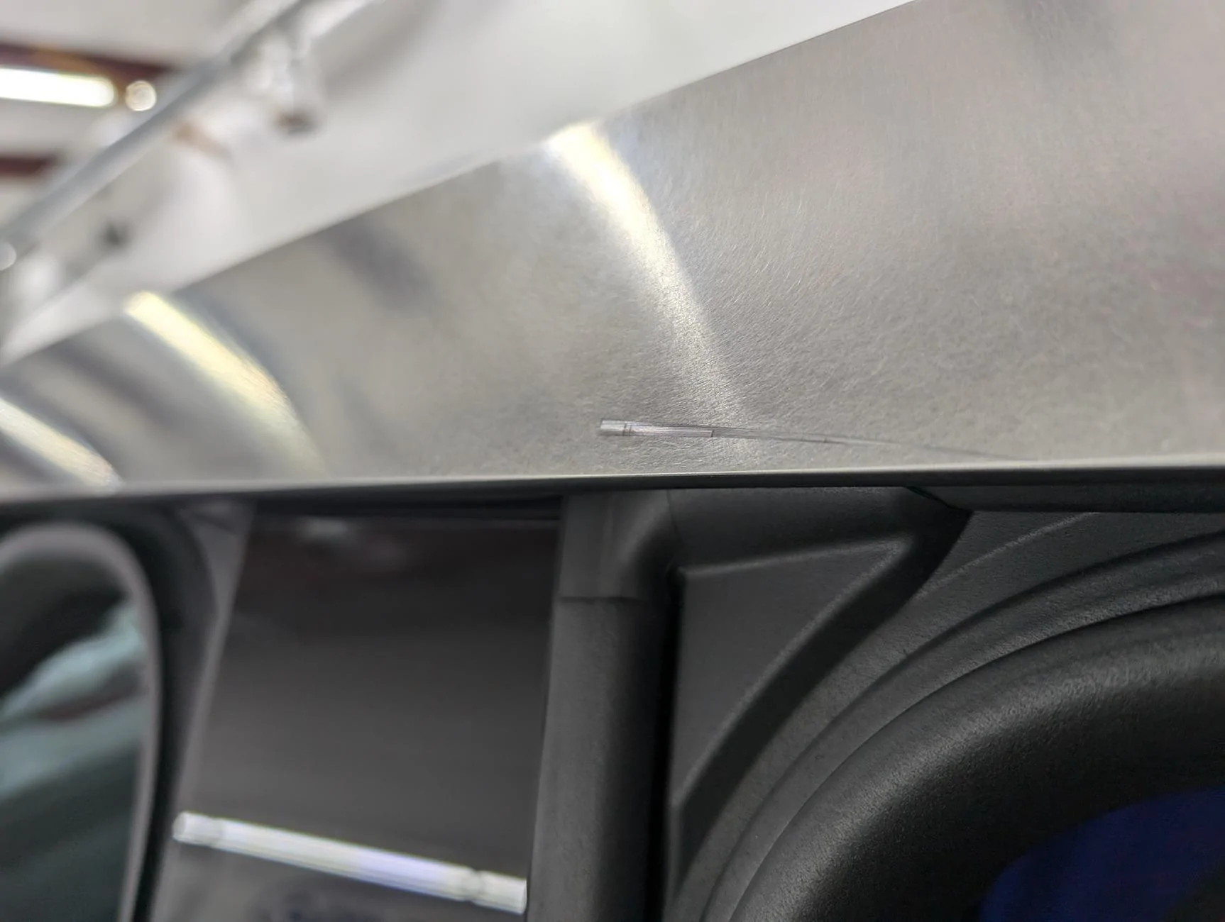

I would agree except somehow it isn't detectable to the touch. Sure looks like a deep scratch from the images. Maybe discoloration from solvent/acid on the rag?

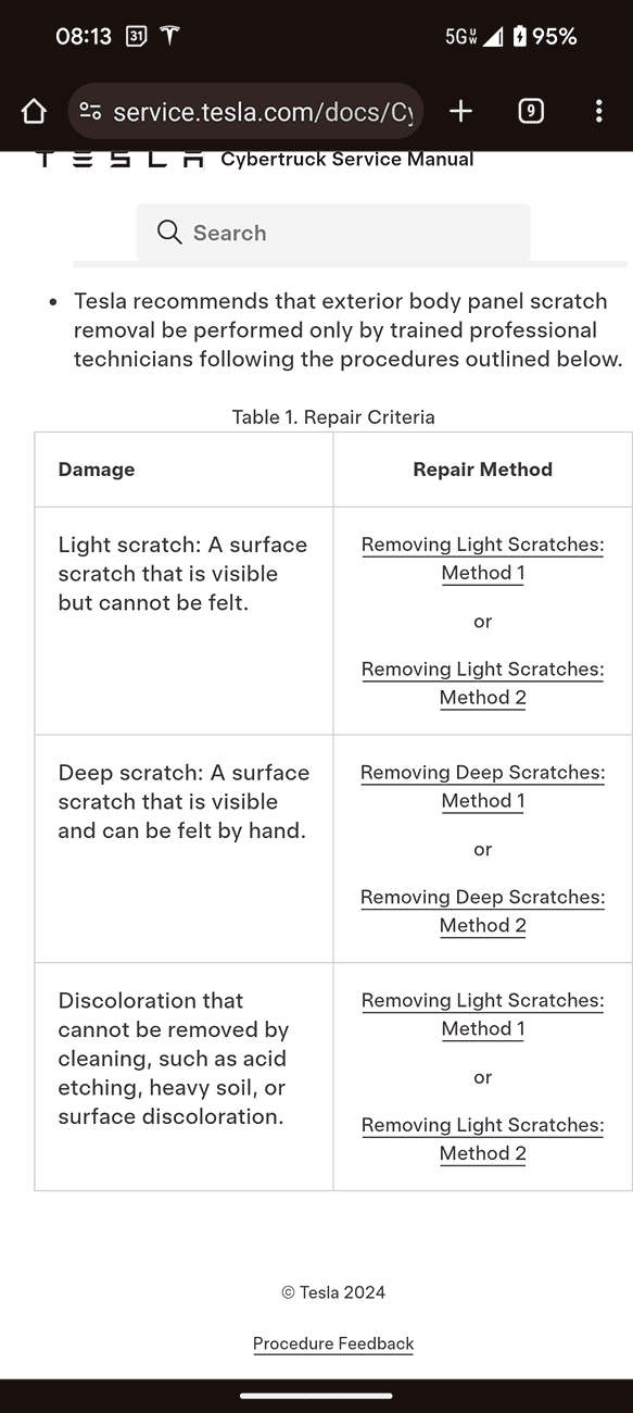

On the Tesla service link that was sent above, it specifically has instructions for "light scratches: ones than can be seen but not felt"

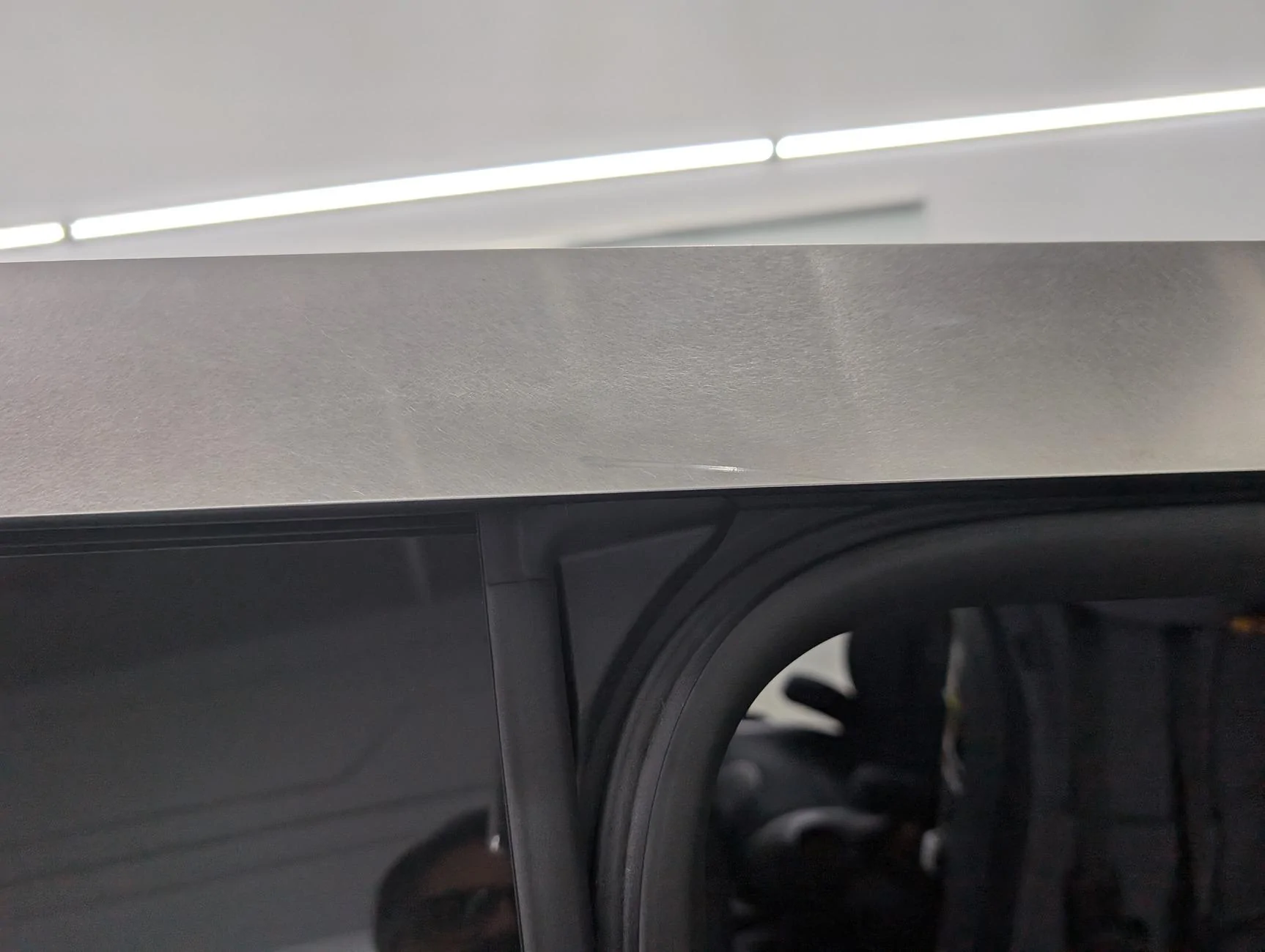

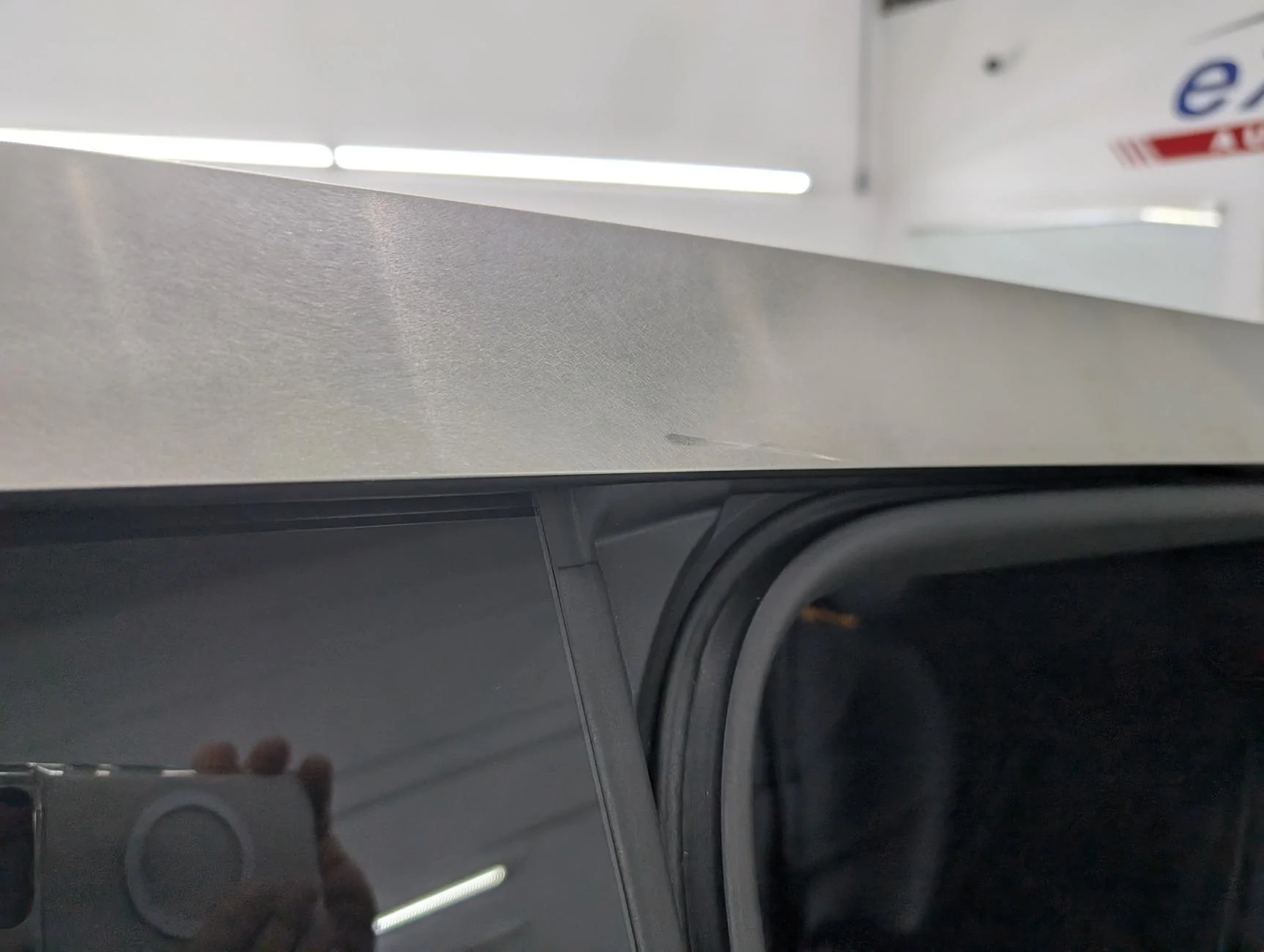

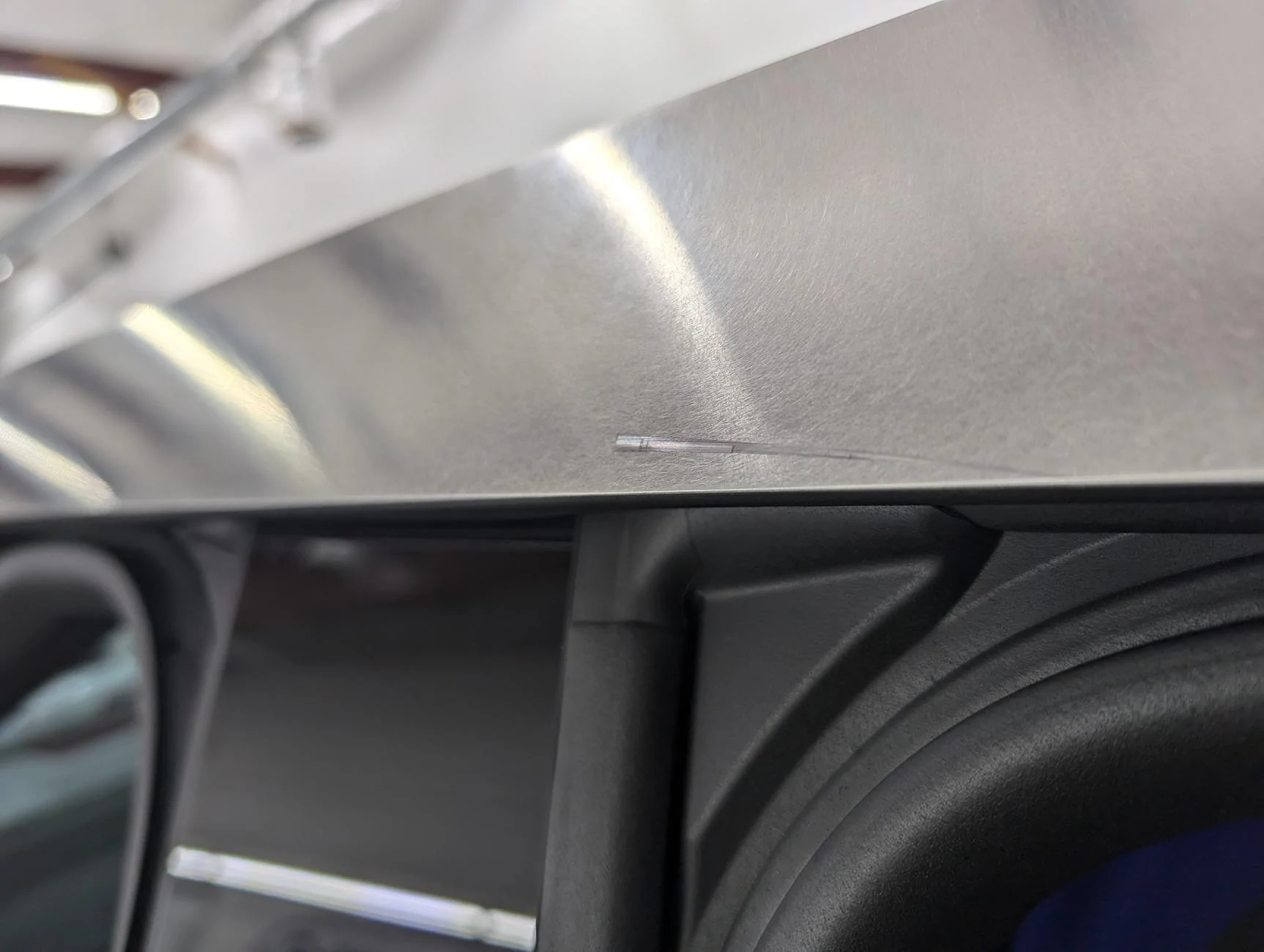

While getting the windows tinted someone at the shop didn't realize the windows were raised above the normal level and closed the door. The window scratched the top sail (whatever it's called) there's absolutely no texture to it (completely smooth) and it's only visible at some angles. Anybody has any recommendations? Is there something i could use to buff/polish this out? Should I just get a service appointment? The shop will pay for it but the other things is that I was getting it wrapped in color next week and before anybody says; "who cares, it's getting color-wrapped", I will probably take the color wrap in a couple of years and get clear PPF.
Tesla can reapply the texture using an air sander. Not sure what the cost is. I would ask the tint shop for reimbursement.

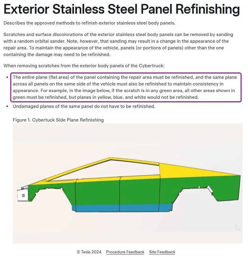

Did you read/see the section of the service manual on what Tesla recommends? They provided a lot of details.
See link or PDF here:
https://www.cybertruckownersclub.co...tting-windows-tinted.20368/page-2#post-360922
