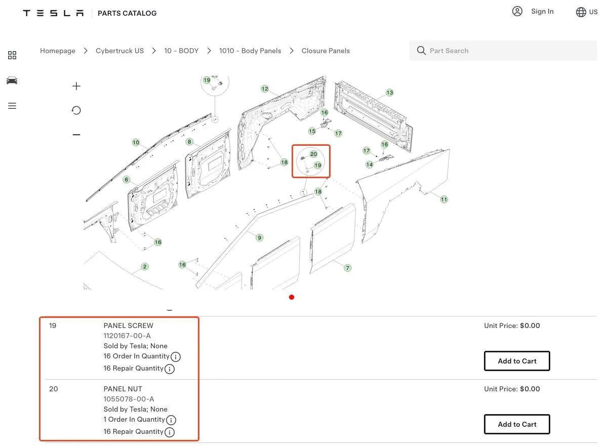

Tesla's service manual and parts catalog are both publicly accessible. The Cybertruck parts catalog shows that this small panel's official name is ROOF RAIL TRIM—LEFT/RIGHT HAND (#9 and #10).
Tesla Cybertruck Cybertruck Stainless Panels are falling off ...Is this a new phenomena? 1738949957579-i
Now, note parts #19 and #20: PANEL SCREW and PANEL NUT.
Tesla Cybertruck Cybertruck Stainless Panels are falling off ...Is this a new phenomena? 1738949877294-7x

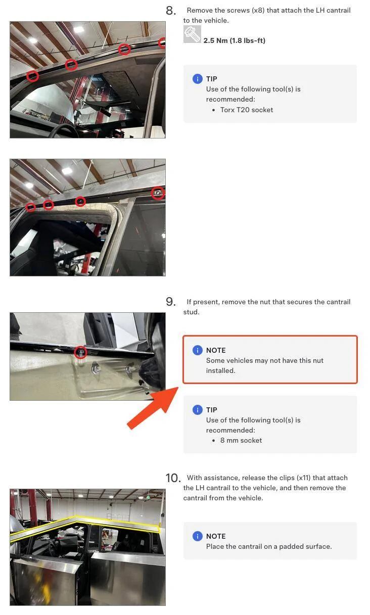

Given this information, you can find the removal and installation instructions for the ROOF RAIL TRIM in the Cybertruck service manual:
Tesla Cybertruck Cybertruck Stainless Panels are falling off ...Is this a new phenomena? 1738950130749-2e
Here comes an interesting note: Some vehicles may not have this nut installed.
So my hunch is that some early-stage vehicles may have the ROOF TRAIL PANEL glued, but later vehicles had this issue fixed. If you are an early bird, maybe check with your service center and see whether they can replace these parts.
That appears to be the procedure for a complete trim piece which includes the surface SS piece which is glued to the steel substrate. That entire unit is held with clips and studs. What this thread is discussing entails only the surface SS trim peeling off of the clipped and bolted substrate.
