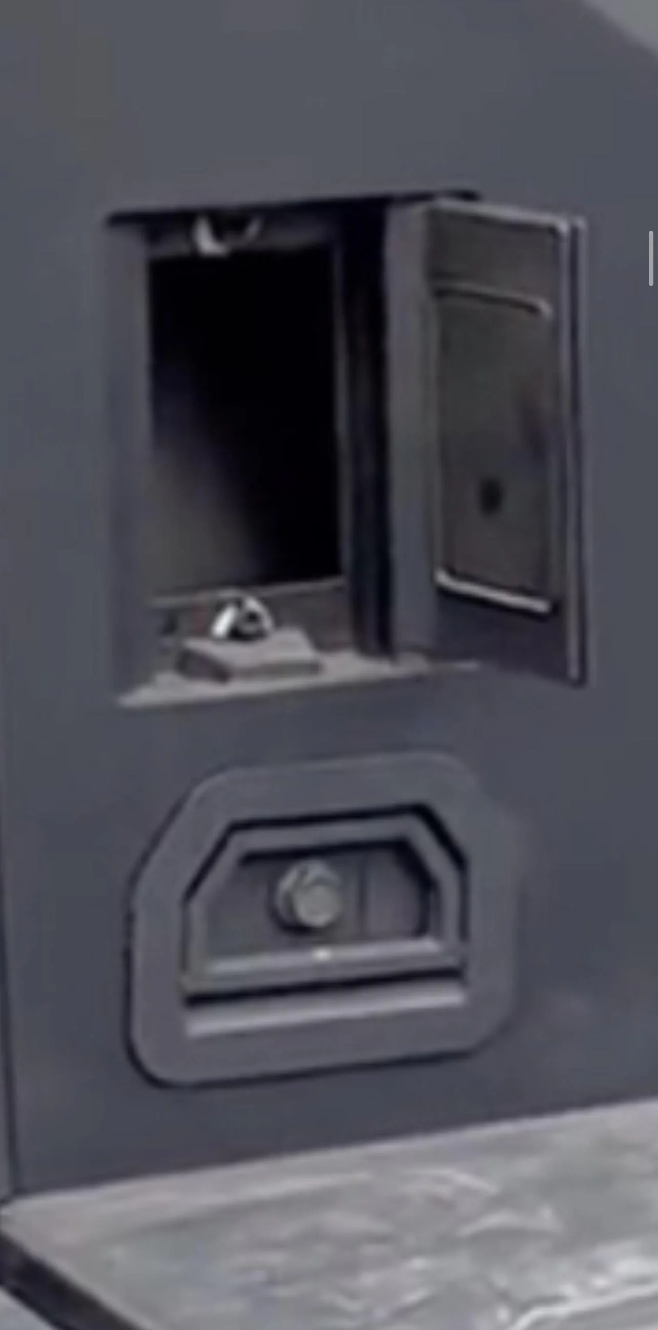

That would also be my first guess as well, but seeing what Ford has included in their 'Pro Power' (panel), I wouldn't be surprised if Tesla also did something comparable.
Back to this Cybertruck Prototype - there is more room for an extended layout of additional receptacles in the flat area where the empty hole is located, and it would be very easy for Tesla to change that layout any time they wanted.
Actually, I may do a quick design of a triangular shaped recess flange panel with NEMA devices that would likely fit in that area, and then post it here just for kicks. Might take a couple days or more, need to fit it in my schedule.
Let's hope Tesla will offer something like Ford's 'Pro Power', or if not, at least a two phase 240volt outlet with an adapter accessory maybe. Either way, it's not a 'deal breaker' for me, but some buyers may be stuck on that feature.
- ÆCIII

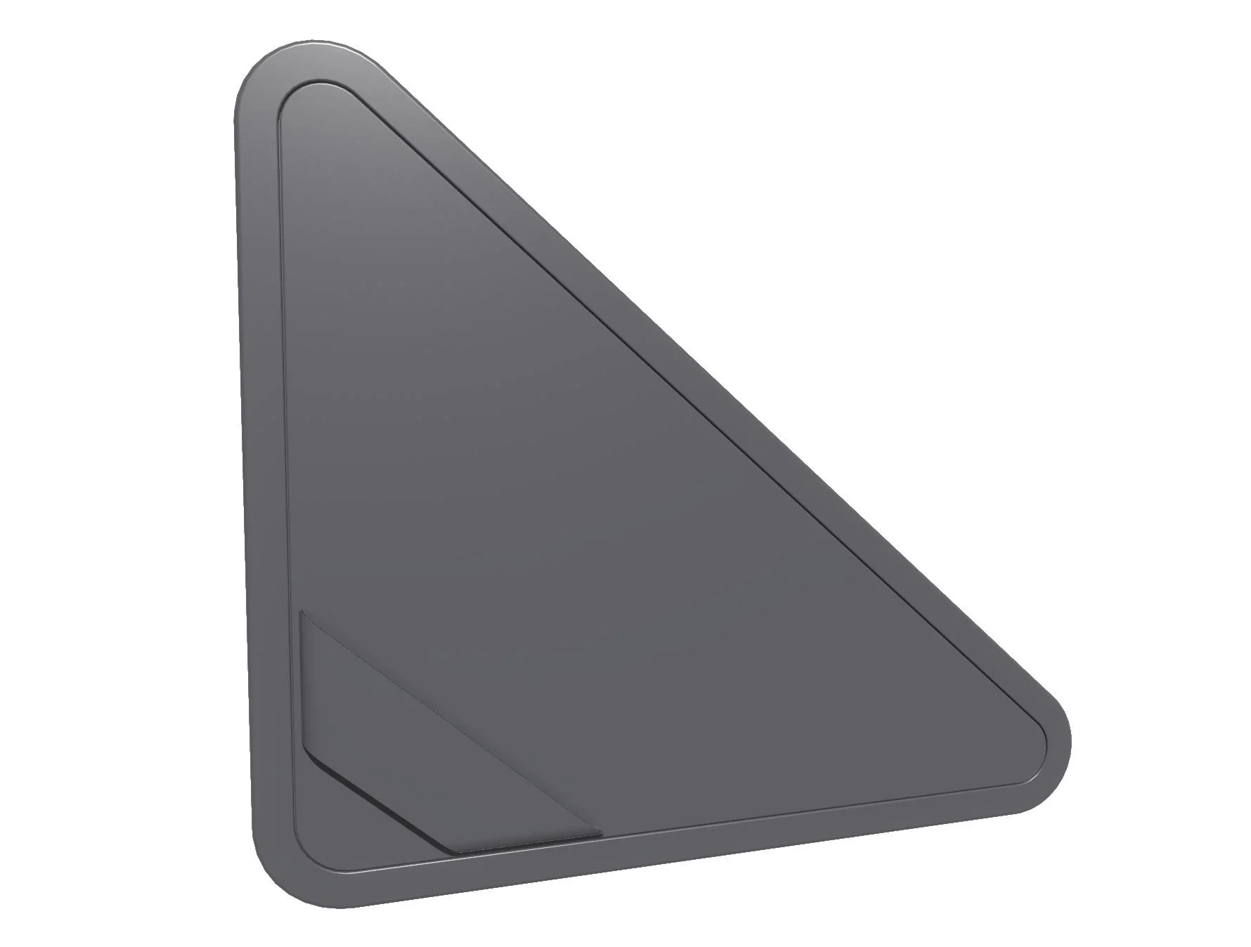

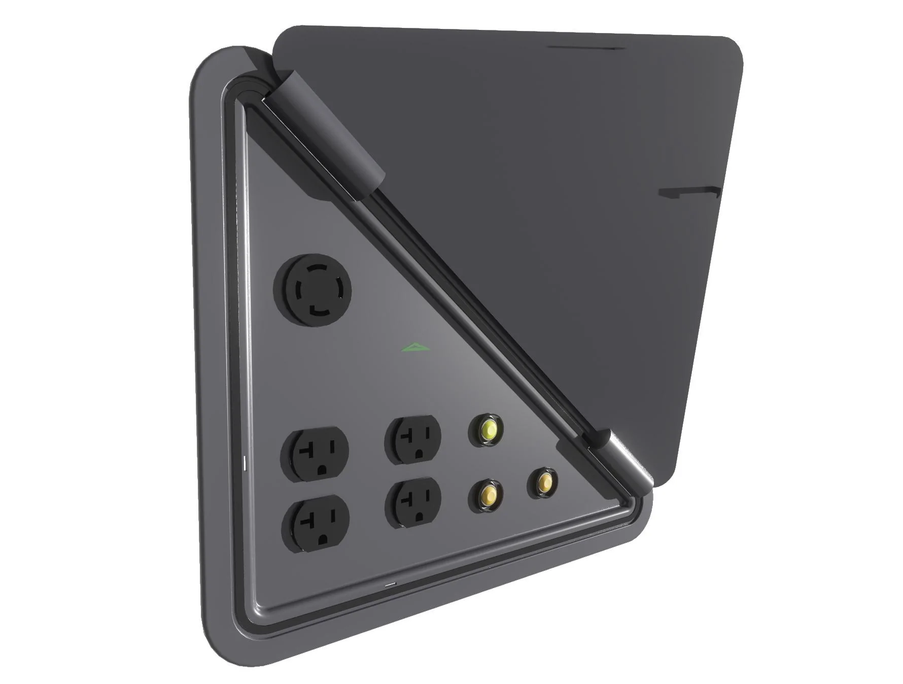

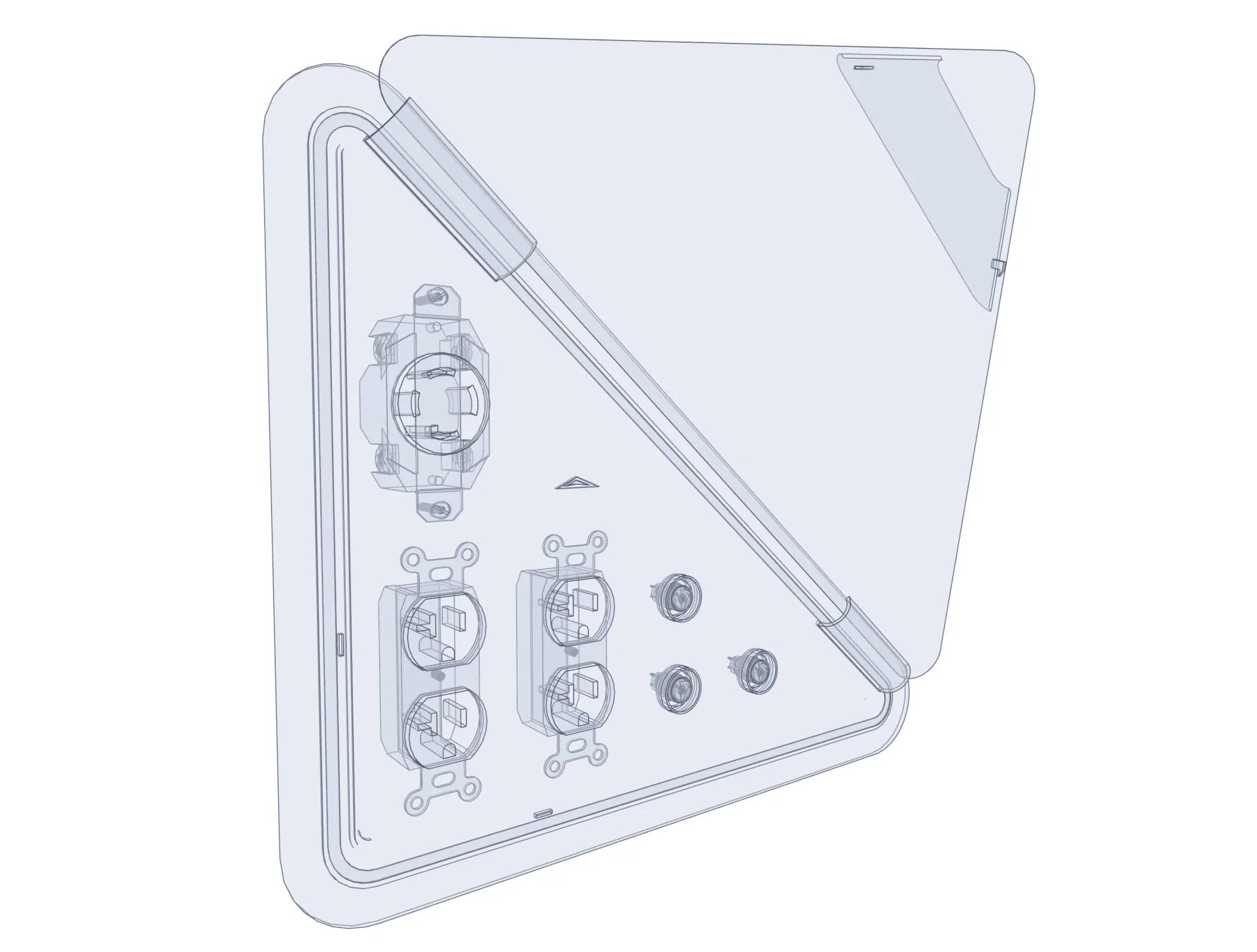

Some renderings below, of a form factor I was thinking of, to mount receptacles in the Cybertruck, comparable to the F-150 Pro Power complement (vault/bed receptacles only).
However, this may not be possible as there are many unknowns to us 'armchair' fans out here. Cannot see what's behind/inside the vault inner walls and surfaces, so internal casting structures might conflict with available space.
Size and scale are not verified accurate by any means, due to photo shopping onto images and challenges inherent to that method. Good for presenting concepts though, for subsequent accurate modeling and feasibility testing. However I attempted to guess the size as best I could, with the L-Track intervals being understood to be 1 inch, and the 110volt outlet protrusions measuring 2 5/8" from top edge to bottom edge. Some areas may be close to accurate, but some areas are also likely distorted.
I am assuming any inverters for such circuits are located near the battery management system or with other power conversion components, and not inside the vault walls. Depending on inverter current capacity, additional outlets may be installed in the cab or other locations.
A similar form factor recessed opening mounted in the other side of the vault, could possibly be adapted for compressed air connections. We still do not know for certain if Tesla intends to make some features or accessories accessible from sail pillars on the outside, but we haven't seen any evidence recently.
These are only photo shopped renderings as without actual access to the truck or geometry, it's not possible to design anything with production intent.

I can see the love there! I'd like some status lights. Tesla doesn't, but it's nice to know there's power flowing through them or they're off when they should be. And you'd also want double weatherization; nothing more annoying than getting sand in your plugs (I know. I have an all-electric camp set-up.)
5,370
Nice work

Great work. GREAT work.
and if they chase the lightning approach, this would be it
If Tesla took a more minimalist approach, aided by better software:
Most people need no more than a triple gang 2X 120v + 240v
For the relatively few people needling eg 4X 120v outlets at once (in the bed), you also offer an accessory inverter that plugs into the 240v providing 2X more 120v - leaving very little use case capabilities of the Lightning - if any - that the CT couldn’t match. Or a creative gang of outlets (see final picture below).
But for the majority of folks, a clean tripple-gang cluster (2x 120v - 1X 240v) would be a standardized approach to CT mass production, with fewer parts and lower cost, but covering >90% of use cases.
And I think with not much design application it could elegantly fit in a panel this size (assuming that’s even the production panel)
