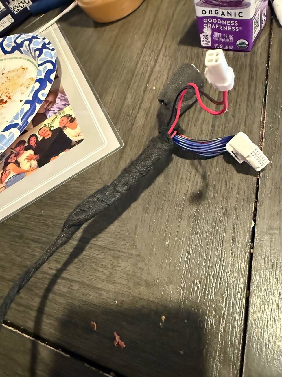

Hey, does anyone have any photos of the harness for the s92 that they sent? they sent me 3 new ones and I turn the mirror on and it turns off right away
I do not have a photo but I helped install Hemiarch’s. The new harness does not have 2 sub-harnesses. It has a small 2-conductor power line and a larger single harness.
The old harness has two sub-harnesses.

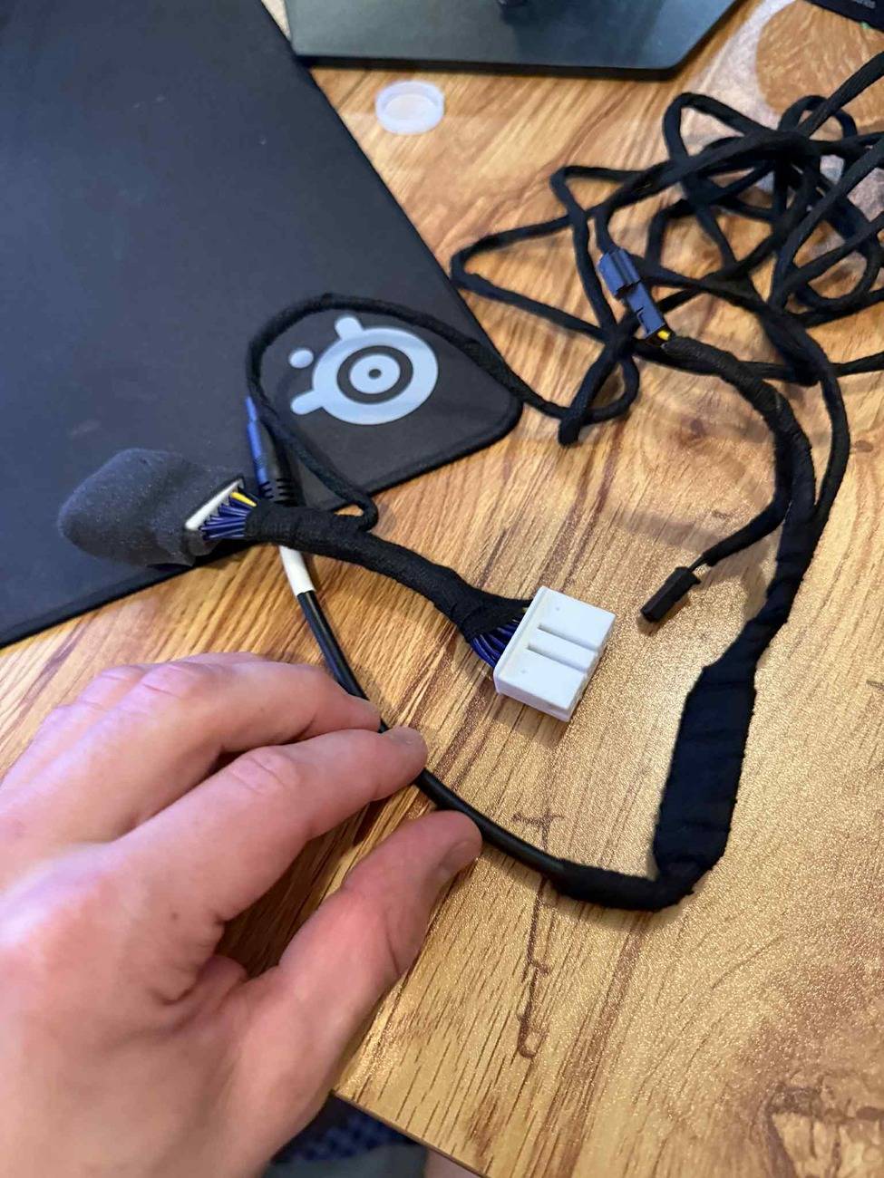

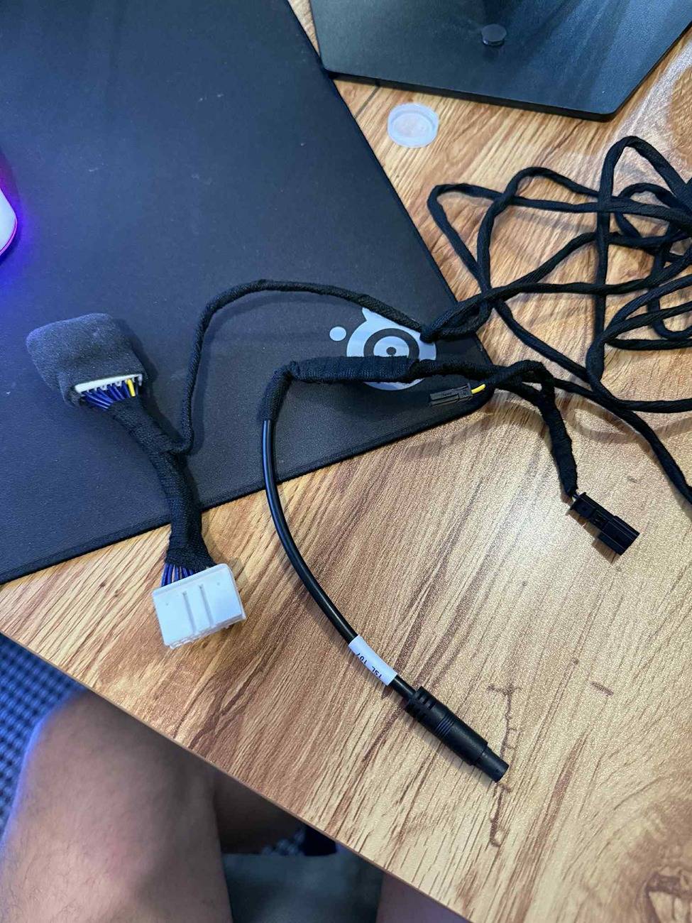

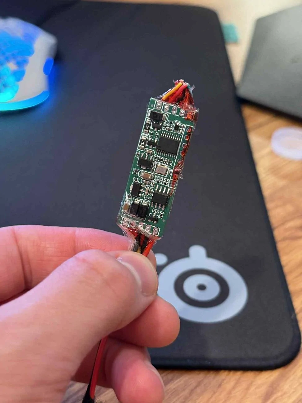

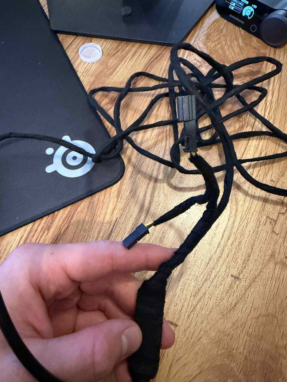

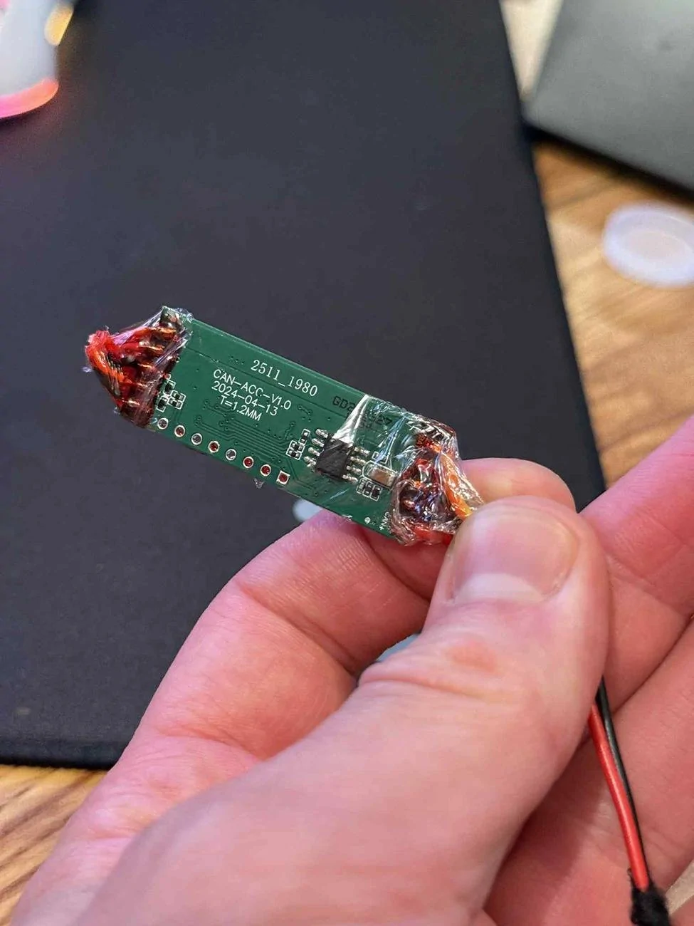

Here is the new one they sent me and it turns the camera on and then off, it plugs into the car computer and mirror power tap.
So what does it do? get's power from the mirror area and plugs into the computer to know when the car is off? I took the chip thing apart to try to see if I could see anything that was messed up and could not find anything
I hope that is helpful.
Take a look at the photos I posted to see if his looks the same
The photos of the harness that includes the mirror power tap and the footwell computer harness tie-in are identical to what we installed in Hemiarch’s truck to alleviate the audio alerts that were occurring with the Harness 1.0.
I’ve not seen the cable with the exposed circuit board that you posted.

Red wire is for power. If yours is turning on then off after 5 seconds than it’s plugged into the right spot.
The other two plugs are a jump in the middle of the connector by the passenger footwell.
This is where the “car on/car off” signal comes from.
When that’s correctly plugged in, the mirror will not turn off after it gets the initial power signal and after you press the brake pedal to start the car.

No. If it is plugged in correctly it will only work when the car is on. In mine, I press the brake pedal, put it in gear and then see the Cybertruck logo on the screen. Several seconds later I have a mirror.
