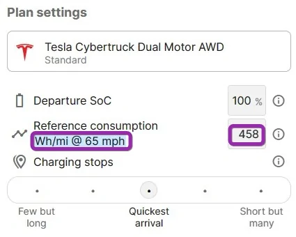

that was true for first few runs i did, then i realized, set to 80F, and no change in results
my battery deg is untouched default of 5%
otherwise, unsure why my ARBP if spitting out such materially different conclusions than yours. what, again, is your efficiency assumption setting?

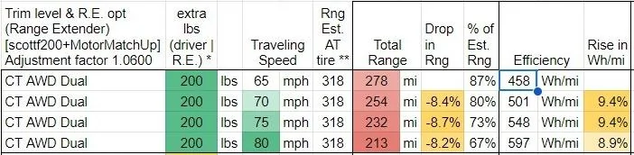

Did you at least like my spreadsheet? Geez, I worked hard on that along with all my testing (hahaha).
Do you mean "Reference consumption" I'm guessing.
I used Wh/mi @ 65 mph from my MotorMatchUp data since that was what ABRP is asking for as it's base reference. I assumed it would adjust that based on any speed you went from 1 mph to 80 mph.

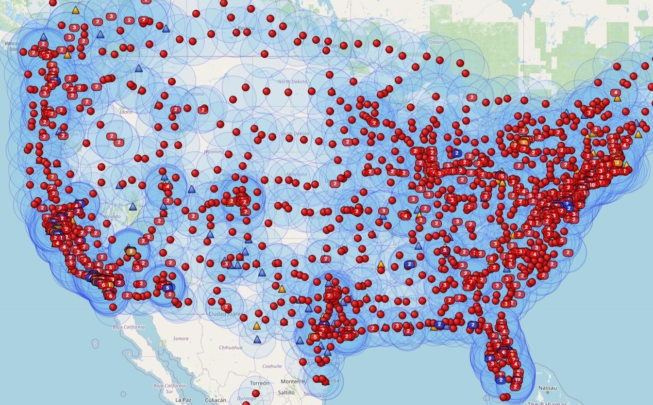

Radius on these circles is 100 miles. Pretty amazing how many major roads are covered by 100 -150 miles.

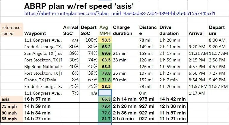

Overview: I downloaded my examples and did some spreadsheet string/data parsing ('## mi' & '# h ## min') and math to come up with a formula for average MPH. This let me compare charging and drive durations for all 4 of my examples. Also showed my max speed was working as expected.
Interesting are you saying that the faster you go, the faster you get there? Even though you may have to charge about an hour longer? That can't be true.
But yet in practice it is true.
Tesla has built the network to support at least the RWD Model 3, with a 272 mile stated range.
And they are growing every day.

yes i do love your spreadsheet, sorry, and thank you!!
btw, reviewing your chart, i think i realized what may be one delta in our 'experiments'
appears your default setting is to a 200lb driver and no other payload?
mine assumes a driver plus 660lb of additional payload. i honestly don't know if that's the app default, or if some time years back i entered that as my working assumption (given that when i go long distance, it's with some stuff
do you think that plus the 5% degradation assumptions combined would be enough to make-or-break?
As we know, there is always a point of diminishing returns in travel speed vs time it takes to recoup/refill that kWh energy at the charger. It has changed over the years as the cars and batteries have. I recall long long ago so may threads and spreadsheets on calculating the 'best' speed limit to travel the 'fastest'. At one point in time it was ~72 mph.

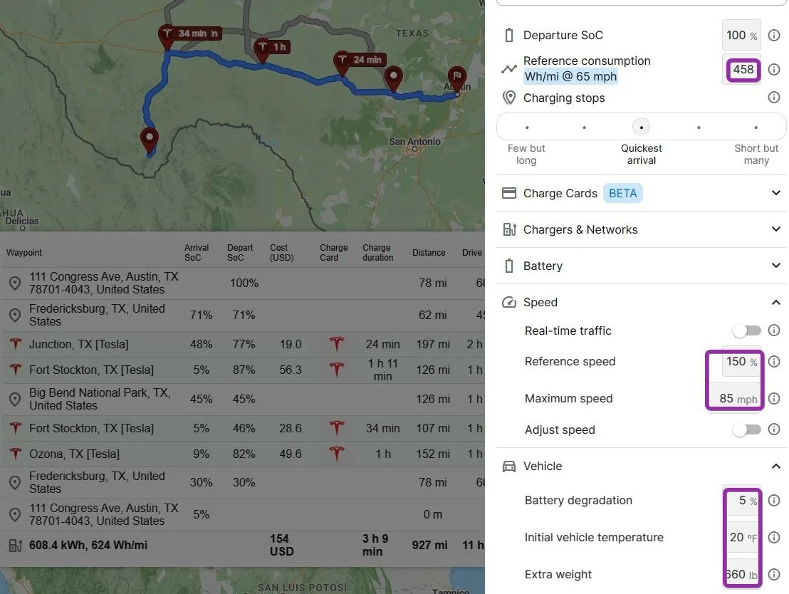

I still had that screen up so I tested with these options (matching above) but it still worked. You got a lemon, man.
