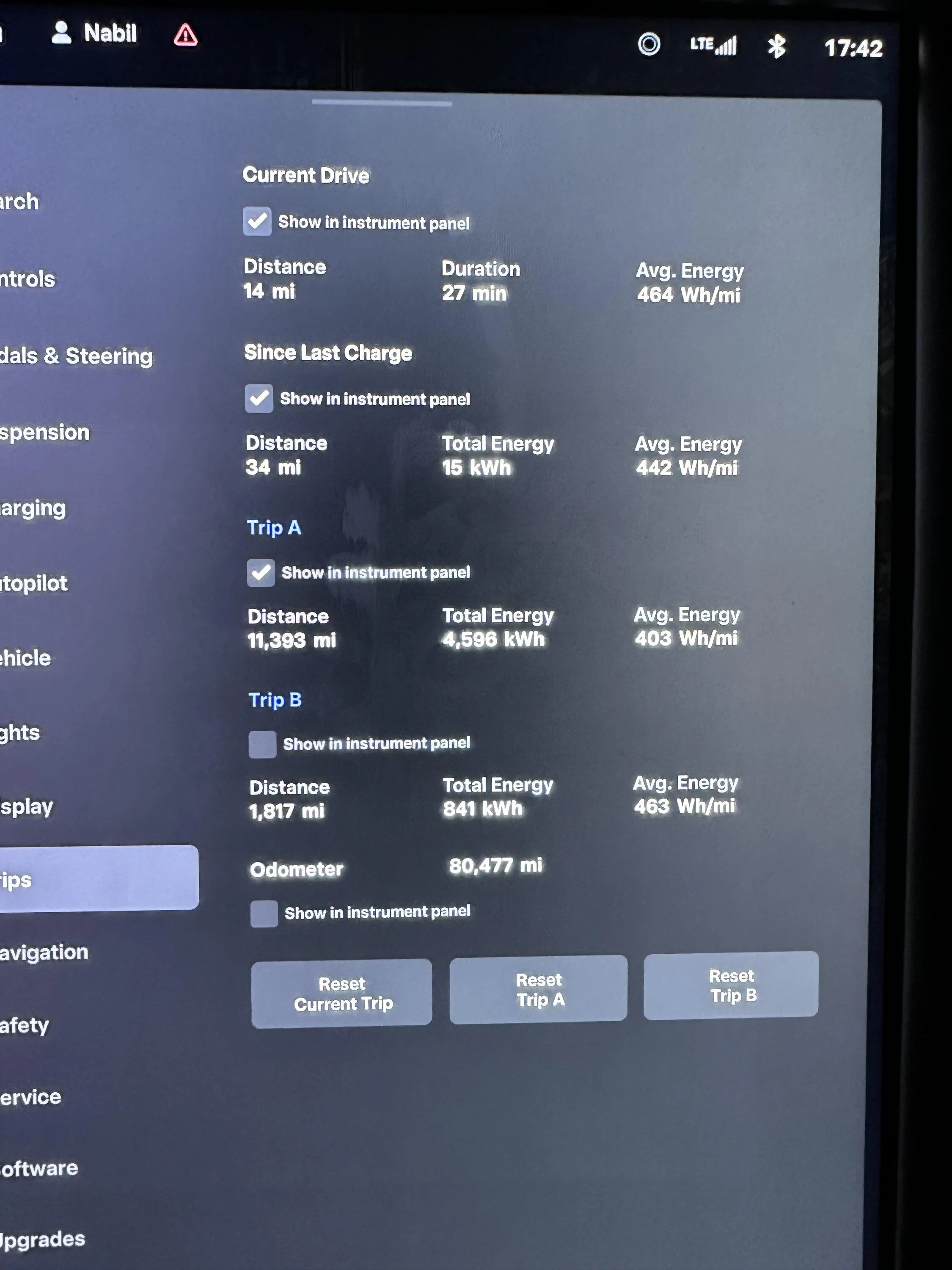

I have been driving EV since 2018 and still own and drive Model X and reserve CT
Also I pretty much know how the EV science work.
I was replying to you real world post.
Following is the screenshot my model x driving , which I have driven 80,000 miles
Tesla Cybertruck Foundation Series Remorse IMG_0687
The average 403 wh / mile after driving
For cybertruck it is 590 wh / mile
Or say 550 wh / mile
For full battery 100 to 0 will be 123000/550
= 223 miles , so one does not charge 100% and empty 0, assume 10% before recharge
So effective rage is 200 miles
PS: I have converted my Porsche 911 to fully electric using Tesla drive unit and LG batteries , all by myself so I understand the theory.

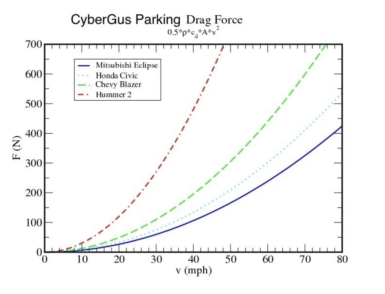

Go be mad at the EPA if you want, but direct your anger/disappointment at the right place.
I’d suggest instead be mad at the real culprit: physics
a sedan (yes, also looking at you Model X), with a small frontal plain and a 0.2 Cd will have more limited effects from temps, humidity, and speed
a truck, with a large frontal plain and a 0.34Cd, will be exponentially more effected by these things
this is not new or special to BEVs
Tesla Cybertruck Foundation Series Remorse 7CBE1E08-9063-44CC-9300-9ED8A600F35A
the ONLY thing different about BEVs is the relatively small “gas tank” and relatively limited charging infrastructure
when Tesla said the truck had 320Mi (EPA combined), ZERO about the above chart/physics changed
maybe I misunderstood
But showing me you understand Model X (~same frontal plain and Cd as a Model Y), doesn’t tell me you understand the effects on range of having instead a full sized BEV truck with materially larger frontal plain and an INORDINATELY larger Cd
Maybe you do?
but if so, it only leaves me MORE baffled
understanding range in sedans is not all one needs to understand about range in a BEV truck
