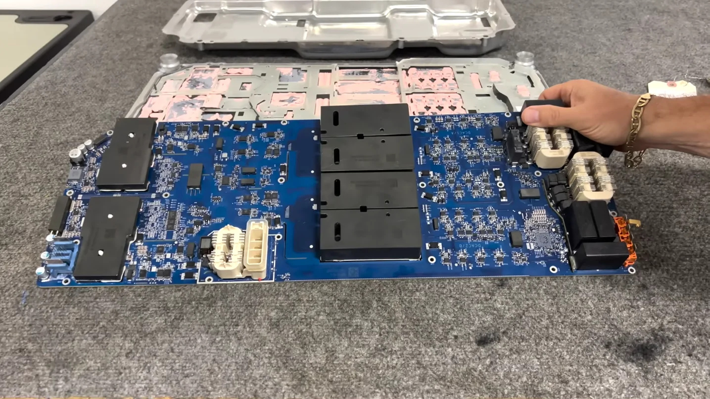

I just watched the Sandy Munro video actually twice more focusing on the toroidal transformer's new design. It maybe a totally new concept /design for the ferrite core windings being replaced with printed circuit board copper traces. I'd never heard of that before and it makes me b suspicious of that being the problem. what if the distance between ferrite and circuit traces become inductively uncoupled with the ferrite due to the looseness of ferrites on the board that Mr. Prucha or the other guy mentioned. would not that make a failure?
unless some electrical engineer gets ahold of the failed pcs units and evaluates for a root cause, the public may never know why this is happening.
