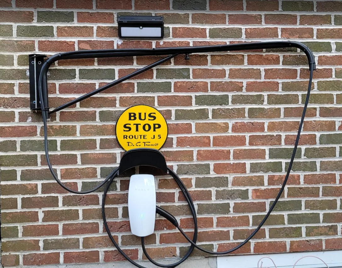

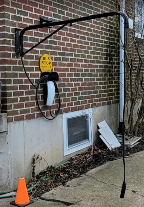

Here is the perfect and cheap device to keep your charge cable off the ground and out of the way. This is from TRACTOR SUPPLY and costs a bit over $50 bucks. I originally zip tied the charge cable to the boom but in the fall I took the Wall Connector apart and disconnected the charge cable and ran it through the metal tube so now if I need it longer to reach the car or truck I can easily pull more cable through as well as pull it back to shorten it.

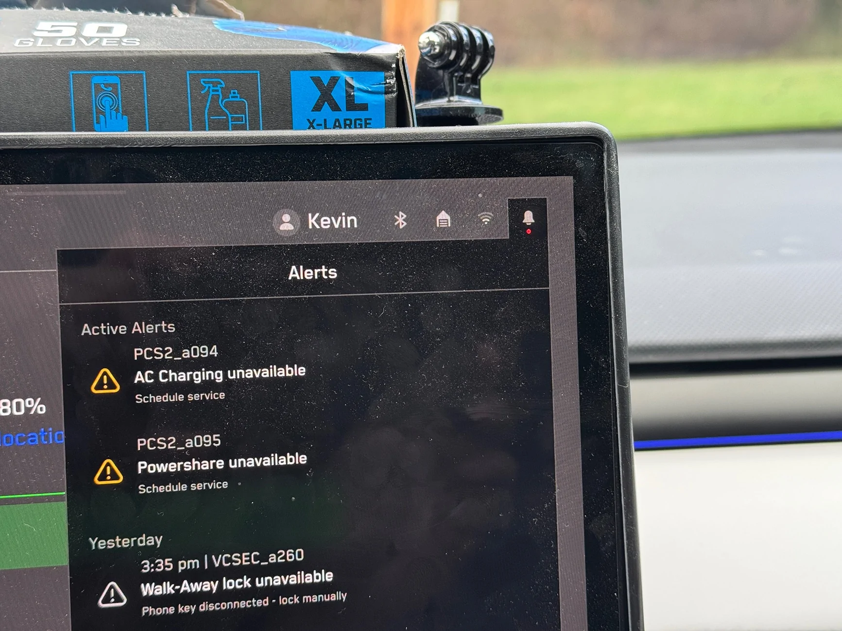

I had intermittent power drops from PowerShare last outage. A couple days ago I got a notification through the app charging at home had stopped. It ended up resuming charging several hours later that day since I left it plugged in. Earliest my service center had was January 20th. 28K on the odometer.
