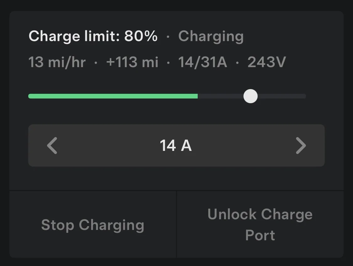

At 240 always set to charge at half the available amps.
Tesla Cybertruck Is charge rate linked to PCS failure? IMG_3429
