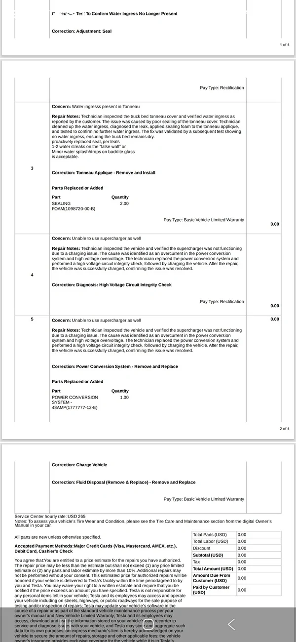

Mine is at service center right now and estimate is for $0 and I have 37k miles on it so it must be under warranty. I pick up on Tuesday per app.
Mine was just replaced
All of a sudden noticed even with a long preconditioning I was only seeing at best 110kw
now with it fixed, 325 kw max

Power Conversion System failure at 3100 miles. Fixed and all good now.
Interesting
Mine is a July 2025 build
Also 3K miles
Part is a Rev G
hopefully this will be the last PCS replaced

More like get it fixed now under warranty, and later out of pocket. From my understanding there is no updated PCS, so it is just a replacement.
I think if something fails and its replaced under warranty and fails again, it still falls under a warranty repair. Im sure if its lik 15 years later they wouldn't but if it fails a year or 2 later, or 10,000 miles later id think there would be a pretty good reason to ask for it

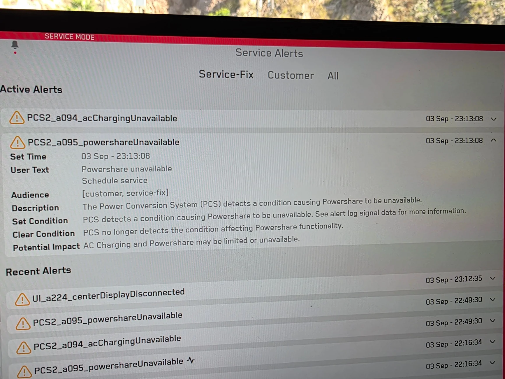

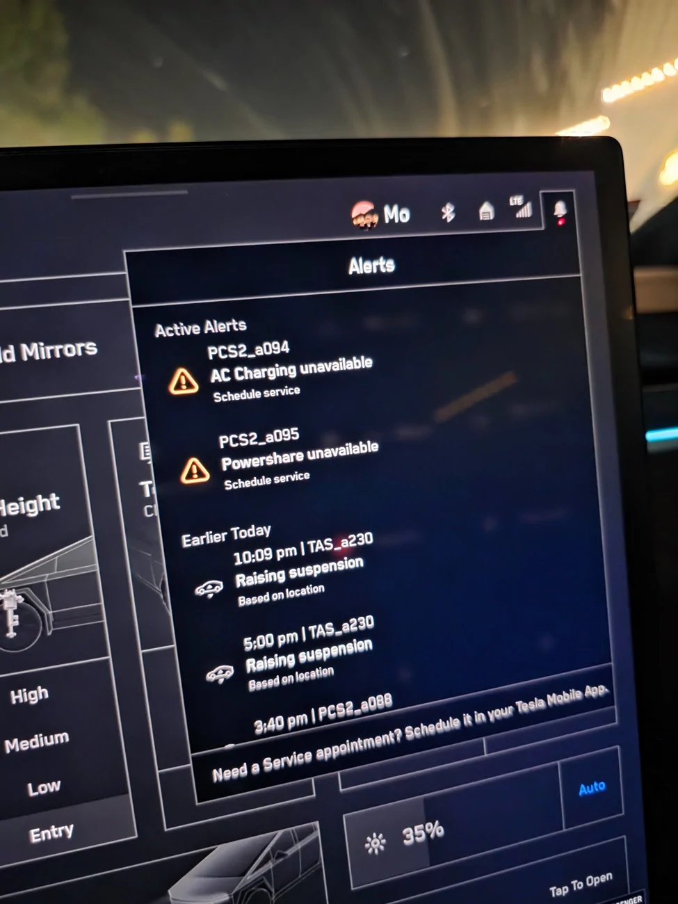

Well, I think I'm about to join the club. Last few days, all of sudden the truck won't go above 24amps. I have multiple chargers and they all doing the same, but 2023 MY is fine. Should I bother doing a test with supercharger or just setup a service call. No errors of any kind in the app or truck.

The errors that proceeded the failure
Tesla Cybertruck How many have had PCS malfunction/failure? 19490
Tesla Cybertruck How many have had PCS malfunction/failure? 19540
Mine started with limit to 24 amps and within about 48 hours no home charging or supercharging possible so it is in service center now. Go ahead and request service and try to get it asap.
