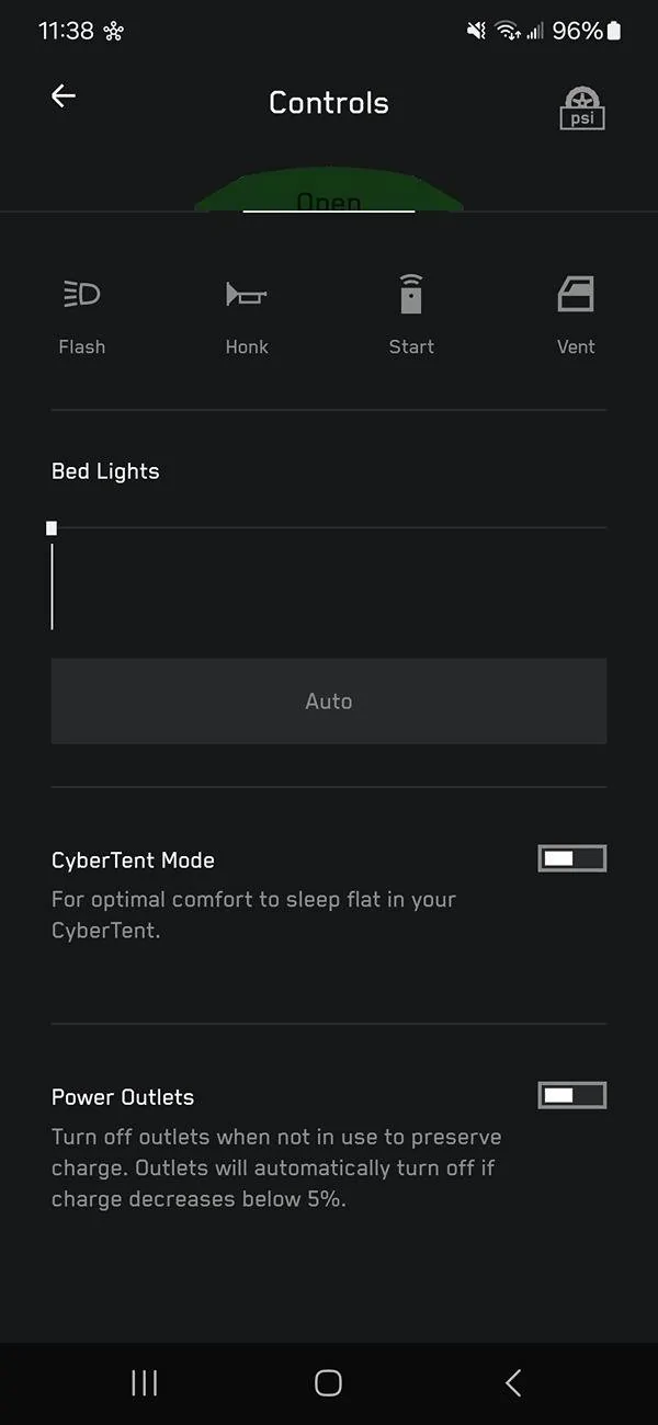

If your goal is to make the truck level on a slope, so it's easier to put stuff in the bed, put it in Cyber tent mode, under controls in the app.

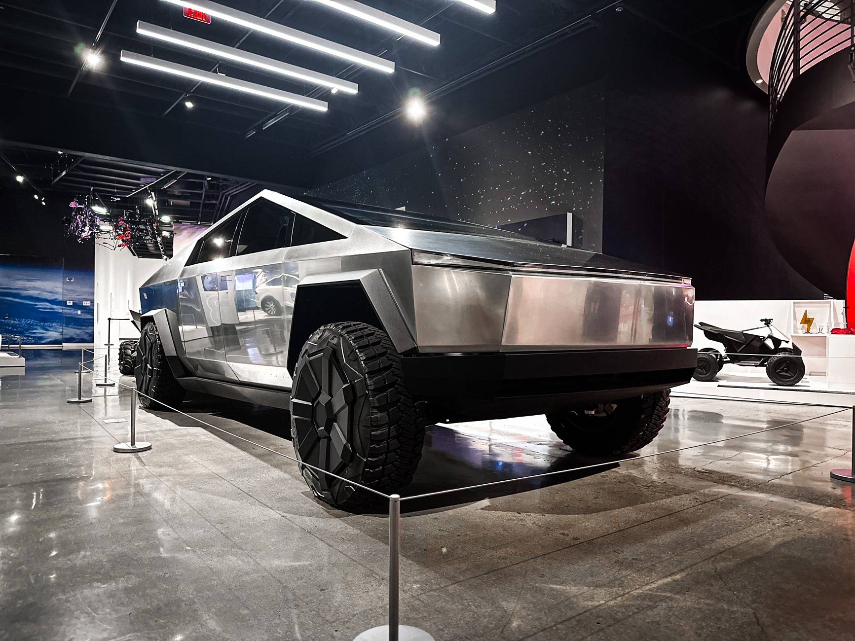

Thank you. I want to put the car on this position, like the prototype on the showroom. Here is a photo (front max up, rear lowest for the cyber quad on a flat surface)

There is a way to do this using the Service Mode, but I'm not familiar with it. I saw it on a YouTube video from sometime last summer.
I imagine, if enough people request it, eventually Tesla will provide us with a free software update to do this with the push of a single button. We need a name for this feature, how about "Squat Mode"?

They haven't enabled loading mode yet - presumably it became less important when the ramp was disincluded.
You could use our lift rods on the front and our lowering rods on the rear and then you would be able to drive with it, hope that helps.

This is a bad idea.

For those who don’t want to follow links…
1. Go into off-road mode, overland, extract height.
2. Go into service mode, suspension, deflate rear shocks.
It will stay this way after you exit service mode, until you travel a couple hundred feet, then it will go back to whatever ride height you have set.
