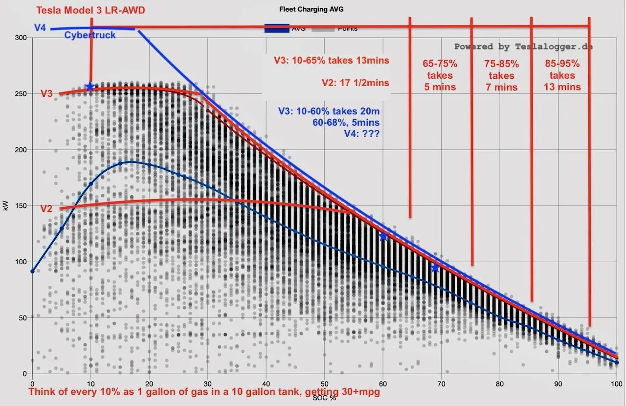

I don't know when we'll see 500kW, since V4 only charges up to 325kW, and that's only up to almost 20% before it tapers. If a V5 or other charger hit 500kW, it'd probably be for the briefest time.
And when you say, "fix", that implies it's broken. Is it broken? Because I've seen the same basic curve for the last 6 1/2yrs.
In fact, when V3 chargers came, the curve above 55% looked the same as V2 to me. And the data on the V4 curve I've seen, looks like it has the same curve after 30% as V3.
As far as I can tell, Tesla likes the taper, and its effect on battery longevity. Don't they have the most battery data? Do we have degradation data on any other mfrs with faster charge curves?
Here's a chart I made for people who ride in my 3 or CT that ask about charging to help them understand:

One, you can charge up to 100% if you need to, on a trip. But for longevity, don't let it sit at 100%. Plan to depart soon after.
Two, 80% is 80%. 48% is 48%, not 48% of 80%. There's no extra math. There's no estimate adjustment of 20%. You're overthinking it.
Three, in an ICE we can think of how many gallons or how full is it in fractions or percent. My tank is 3/4s full or 75%. The exact same thing can be done in an EV. Your battery is 123kWh full, or 100% full. No big deal. You can think of it in whatever units that suits you.
Me, I attached a chart above that I give to my passengers when they ask. Basically, I tell them to think of 100% as 10 gallons of fuel. And my truck gets 32mpg. More in the city, less on the highway. For daily driving, there's no need to fill it all the way, because I can refuel every night at home. For roadtrips, I can fill it all the way, but those last few drops take a long time, so unless I need it, I go as soon as I have enough to get to my next stop. That's it.
I mean I think it is pretty broken that if you pull into a supercharger with a very low SOC and need 100% or close to make it to the next supercharger with a trailer that you will have to sit there for 90mins in order to do that.
I don't think anyone can make the argument of "yea I need to stop to use the bathroom every 2 hours to charge for 90mins anyway, just relax and enjoy the trip"
Tesla promising 500kw charging almost a year ago and being nowhere close to that now and the charge curve on this new split pack, super future, 800w architecture system charging at basically the same speed as a 4 year old model Y is crazy to me.

It's still a big deal when it takes more than 60% (80 to 20), 80%, or 100% to get to the next Supercharger...
No doubt, the 500kw and decent charging curve needs to roll out nowish. This 800w architecture, split pack design, 500kw capable charging stuff has been advertised for years now, meanwhile we are sitting at a SC for 60-90mins which is insane.

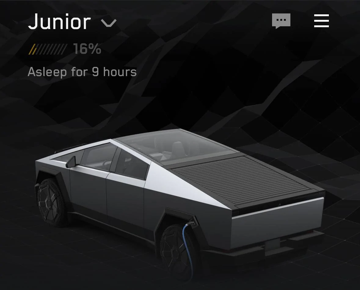

Being the thrill-seeking rebel that I am, I left town for two weeks with a 16% SoC.
I hope that phantom drain is low!
Looks like it's plugged in...
