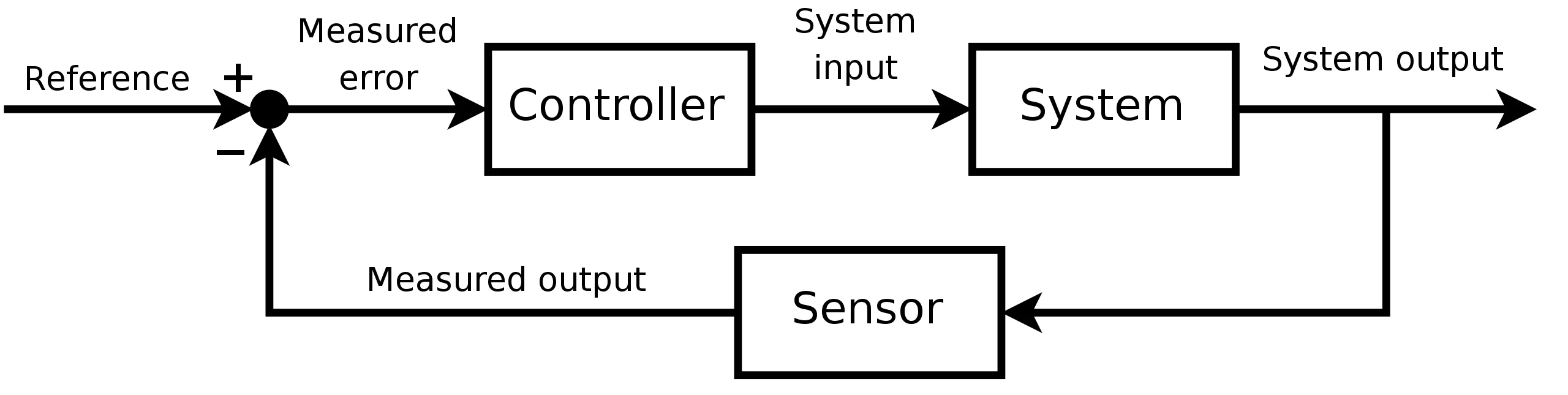

So really, the delay between steering input and steering action is induced by the code. With proper optimization, 5ms is an attainable goal.
The delay time in FBW/SBW is more than just a single code thread. When you add the feedback loop, you add in all the sensors and the servos and their ability to react. And then remember, every 11.7 inches of wire adds a nanosecond! Here is a generic feedback loop for FBW
Tesla Cybertruck Motortrend Piece on CT issues IMG_1854
With that being said, the best hydraulic power steering system on a sports car can’t meet that assistance speed, the valves and pressure wave don’t move that fast. But if that’s their target, expect some dang crisp steering.
You can see in the video (towards the end) where the system delay (intentionally built in) creates what is called PIO, or Pilot Induced OcIllation. It’s caused by either an excessive delay in the system, or gain is too high, meaning the pilot thinks he is moving the control X amount, but the system moves it twice as much, As a result, you create a system where there is just one over correction after another.
