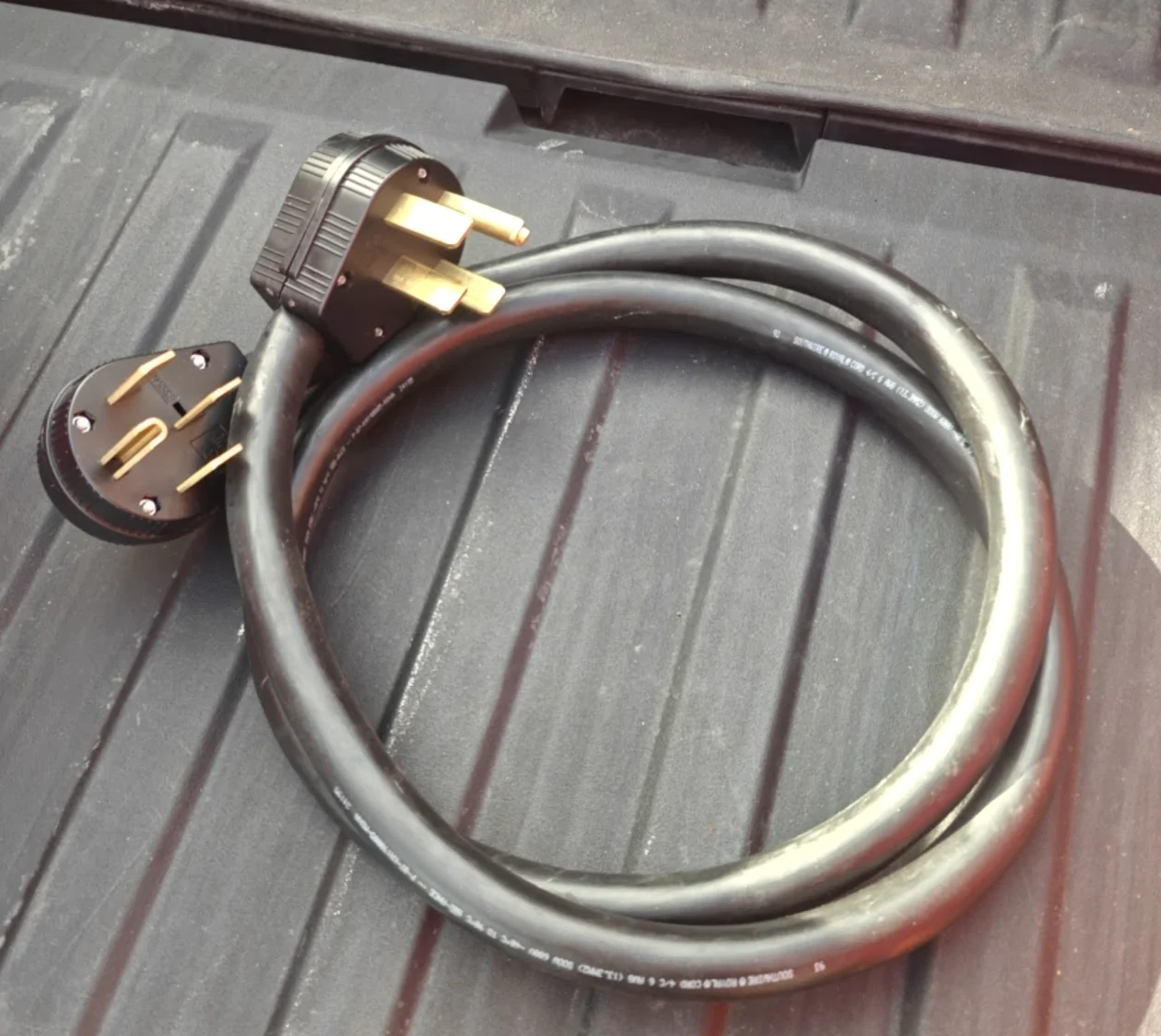

Well...if you already have a NEMA 50AMP charger outlet in your house and get into a jam, the absolute cheapest way (provided you fully understand all principles of electricity and safety) to power your house is this...and with adapters you can power up anyone's house with a 220V appliances plug :)
Tesla Cybertruck My home power backup without Powershare solution/ neutral-ground bonding/ transfer switch options/cold temps 1771269594473-bd
Has come in handy a few times, just sayin' :)
If I were the last man on earth, I might go this route. But knowing that other people exist who could one day attempt to use this, I can't.
