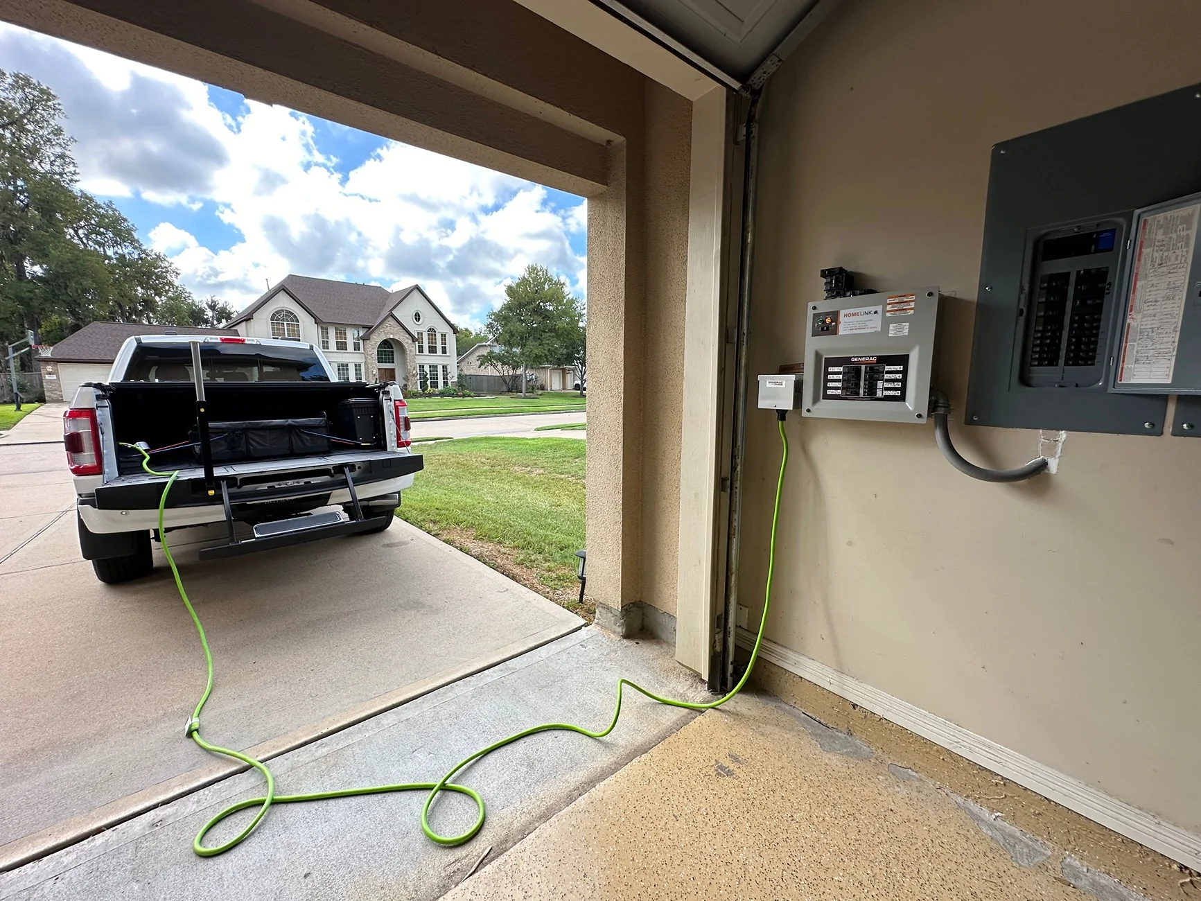

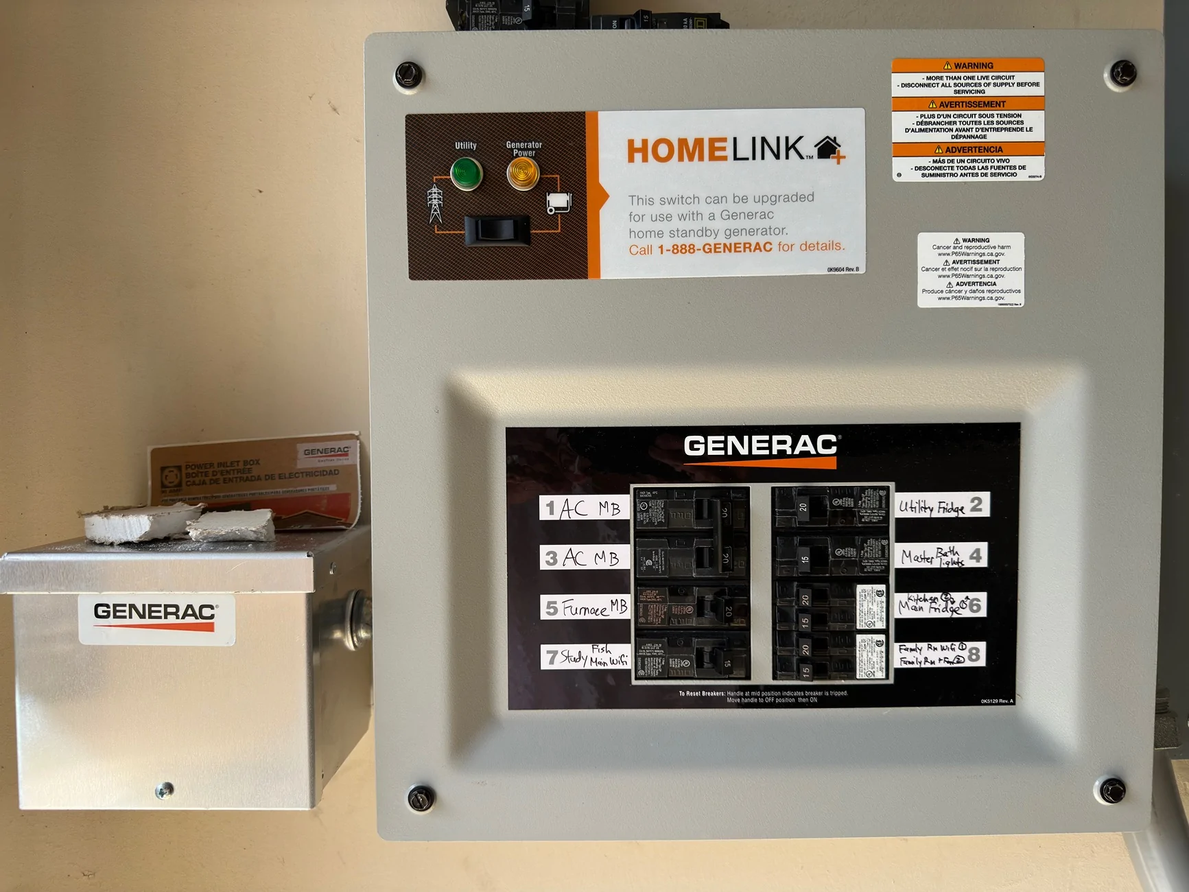

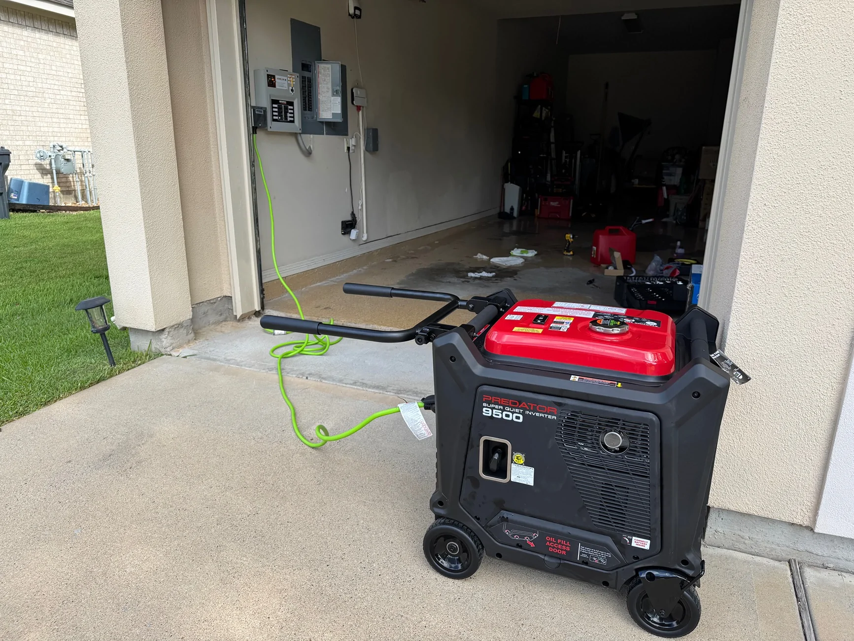

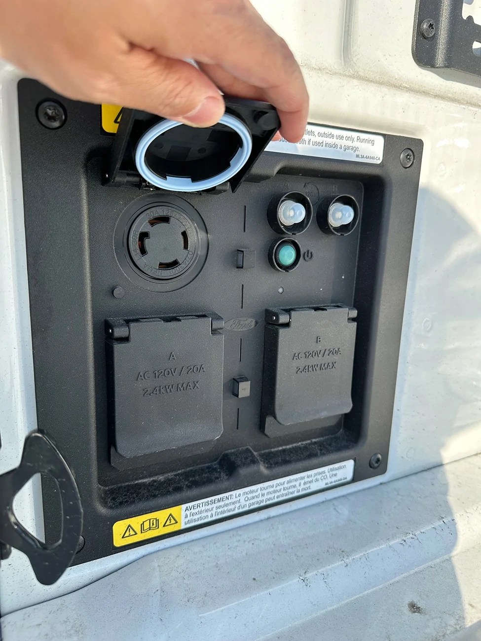

This is my setup...I did this because I have a Ford F150 Powerboost that has 7.2kW generator.
But now, I can use it with my CT as well. I also gave an independent generator.
Nice! I think that Generac unit switches neutral, right?
