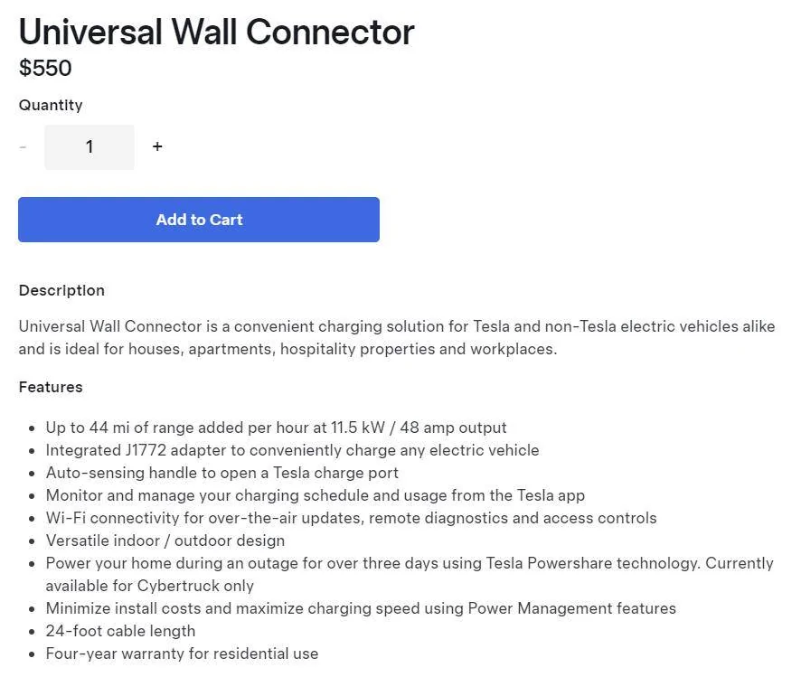

I'm waiting for PowerShare install date and using my old Tesla wall charger for now (48amp to CT)...end state I'd target a wall charger or PowerShare/universal wall charger...interim I'd do 110v/supercharging until you get something installed....yes you can use a 110v or mobile charger for long term, but for me I want max charging speed at home as I drive a reasonable amount and always want the truck at 80% as fast as it can be done....big battery and fun truck - want to use it!

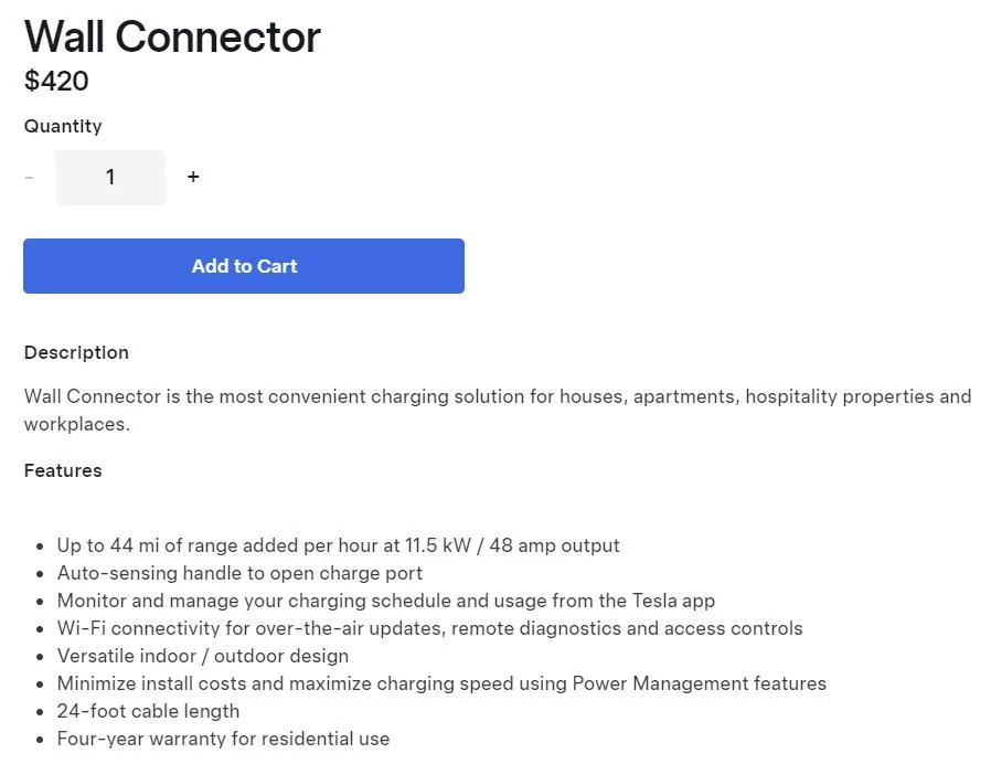

Note: This thread was started when only Foundation orders were available [and title refers to FS] Those came with the Mobile Connector and allowed for acquisition of a Universal Wall Connector.
Non-Foundation only comes with the J1772 adapter.
48A on WC is an important correction regardless. 40A is the CT bed 14-50 outlet limit.
MC is 32A max on split phase on included 14-50. Or 12A on standard 120V plug.
Understood totally and thank you for your input. I 100% agree. My FS did come with a MC 120v15a and 240v50a adapters but did not come with a WC of any kind but have a WC install from 2019. I understand that if I were to get PowerShare equipped ordered it would come in that ā€œorder.ā€
