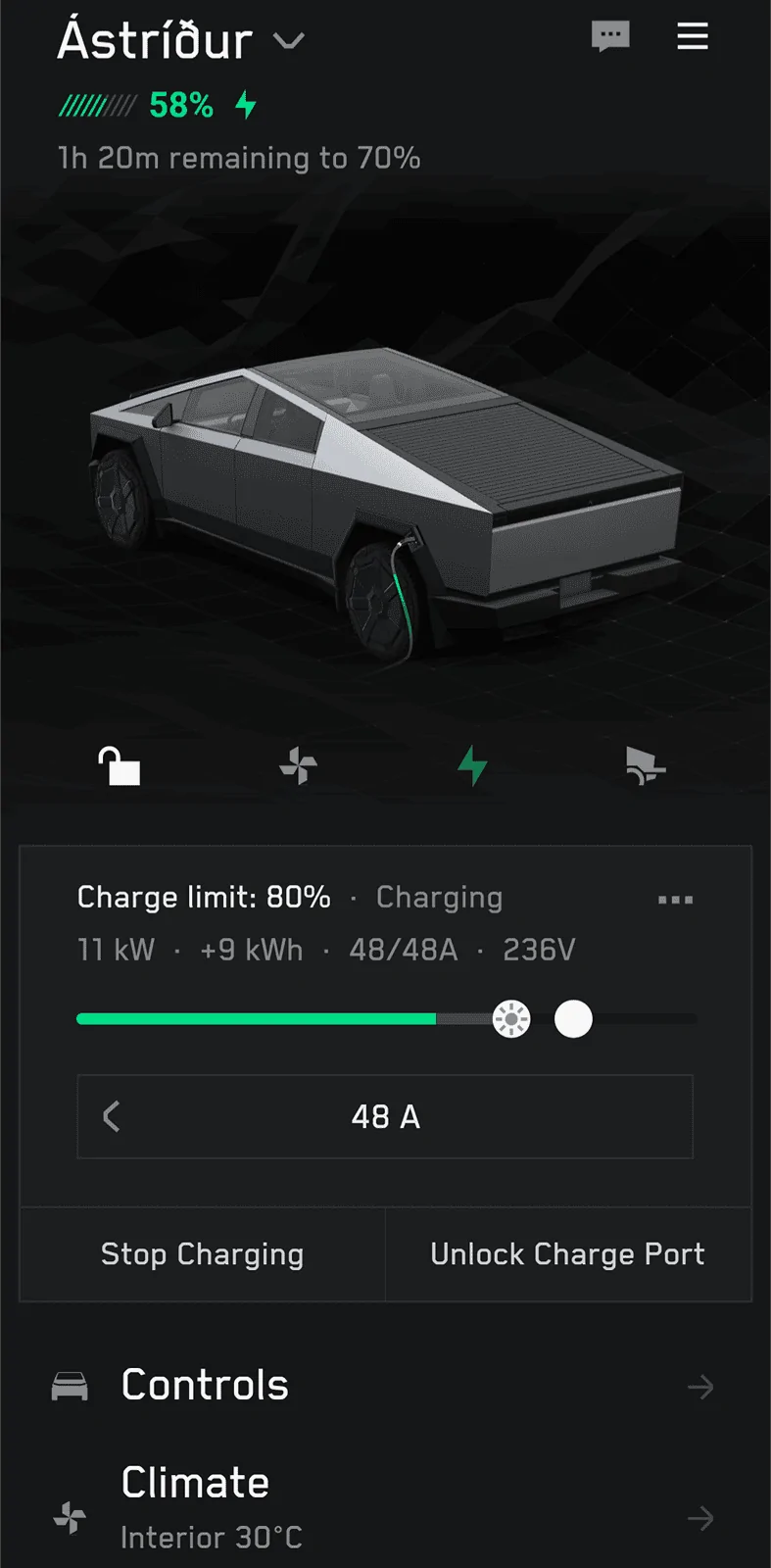

Wall charger from Tesla is 48a 240v on a 60a breaker. I'm not sure why they say 40, but it does a little better than that. (y)
Tesla Cybertruck Noob question but what charger comes with FS Cybertruck? Screenshot_20240625-091209
