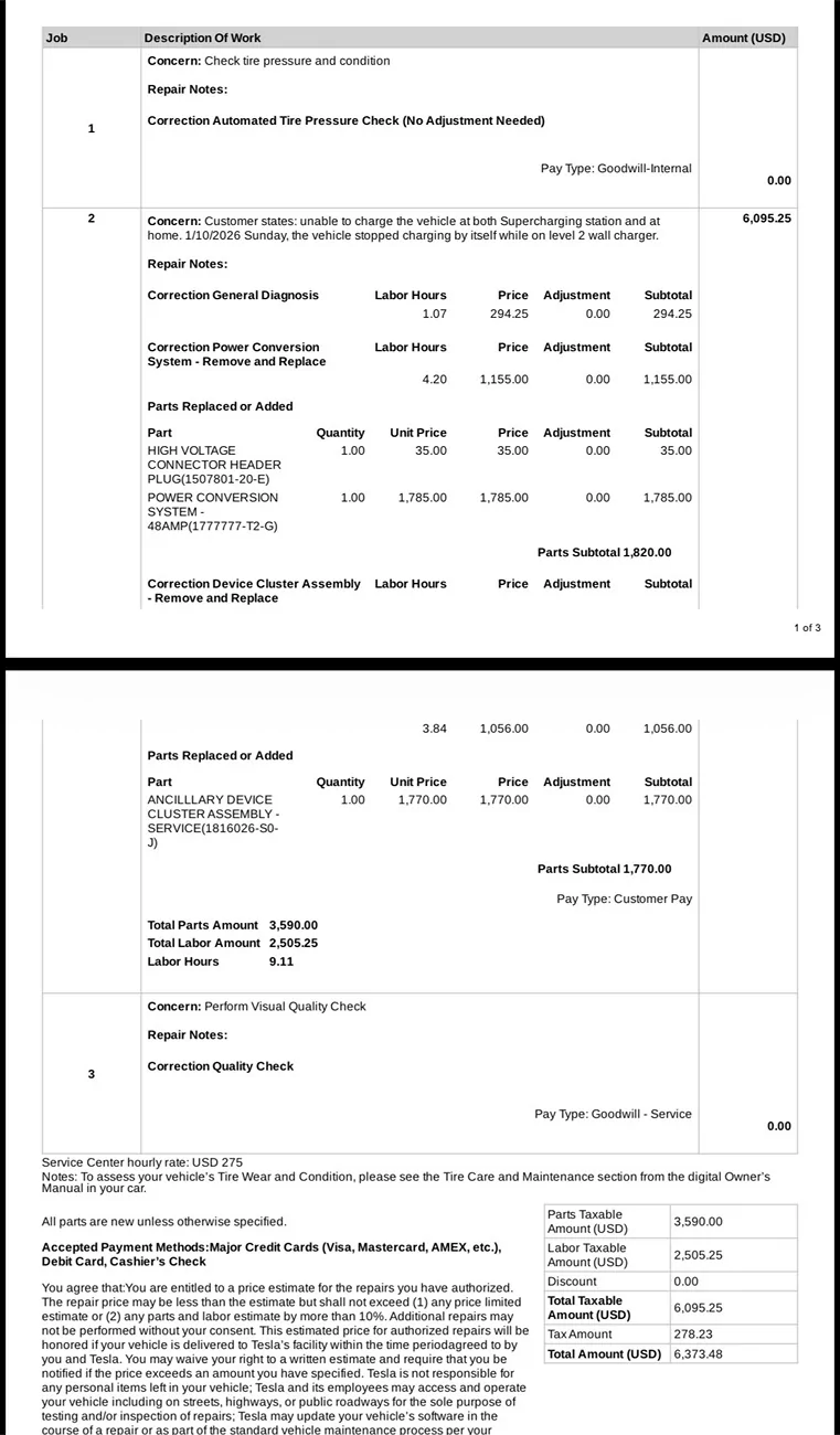

If my truck was out of warranty, I'd do it. Outside of coughing up $2k for a part, it'll be fun. 😁
I will have to pay the $6400.
:oops:
Part is $1.8k....labor is ~$1.1k (4.2hrs @$250/hr)... say ~$400 for coolant, sealant, tax, misc.....what is the other ~$3k for??

Device cluster assembly was also replaced.

Two parts needed replacing.
Looks like they are double charging on labor. Doesn’t make sense that it’ll take an additional 3.84 hours to replace the cluster when they’re already in there replacing the PCS. Unless the whole job takes ~8 hours and that’s just how they split the labor. Don’t know Tesla’s book time or if they even publish that info.
Great point, it calls out 275 an hour so 2505.25 is 9.11 hours.
Device Cluster is 3.84, PCS is 4.20 for 8.04 plus 1.07 diagnostic.
They should have adjusted the time due to the overlap of PCS and Device Cluster.
Removing/ replacing the cover is 3.18 hours.
Correction code 1630010101 1630010102
At a minimum , that should be subtracted.
Thank you and great catch! I’m going to bring that up when I pay my bill.
if this is Dustin on X you saw I helped push this to resolition
don’t forget to DM @Wes and get into detail, center address, your account, names handling the repair
best of luck
Yes that’s me. I’ll DM him now. Thank you for your help.
