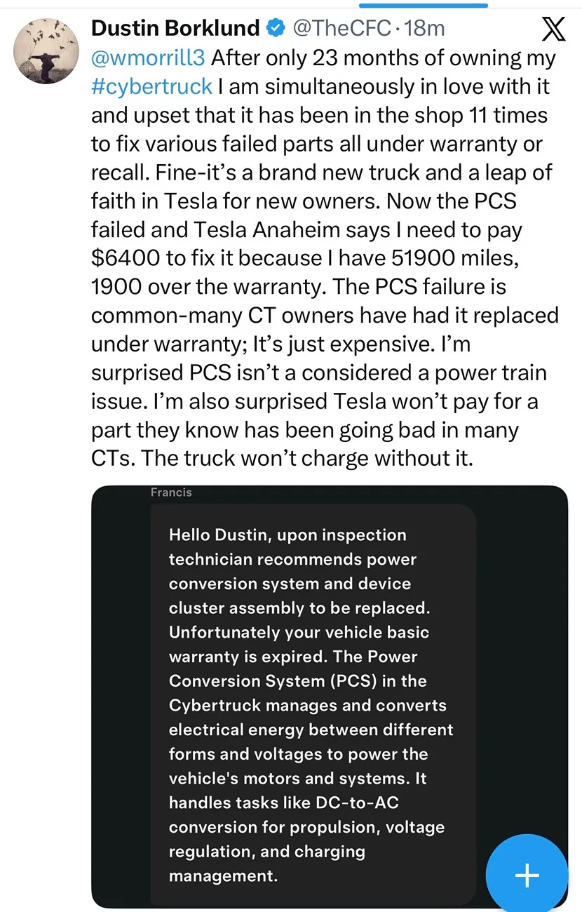

I had a conversation with the site manager of tesla Anaheim last night. He said they cannot cover it because I’m out of warranty. He’s truly sorry. I pick up the truck today at 5 o’clock. I will have to pay the $6400.
As someone suggested, I made a tweet to escalate my issue. I would appreciate it if anyone here would comment on it for extra visibility.

So I just dropped off my CT at Buena Park Tesla for the PSC replacement today. My CT has 56,000 miles. Just like you, my advisor first sounded like it would be covered under warranty but then I got a quote for about $3700. After letting them know how upset and disappointed I was, the service manager did give me a discount. But I think all the CT owners need to take their trucks in and have it replaced even if its not broken yet. Because it will. It's just a matter of will you be lucky enough for the part to break while its under warranty or not. And if the advisor says that he can't replace it, I would ask him to put it in writing that you don't have to pay to replace it if it goes out later. This is not a wear and tear part. It should last the lifetime of the car. The fact that Tesla knows about this problem but won't make it right with their customers is really disappointing.
This should be a recall issue. That's why I urge everyone to go to your dealers and demand that you get a new PCS module. I think if enough customers go in with the same issue, the manufacturer has to post a recall.
Also, some of you asked if there were signs of this before... my CT was charging at 24 amps instead of 48 for a couple of days before it stopped charging all together. So, yeah, take your car in and request that the PCS be replaced. For sure it will not go easy. Be prepared to put up an argument. Our only chance in winning this thing is strength in numbers, unity, and social media.
