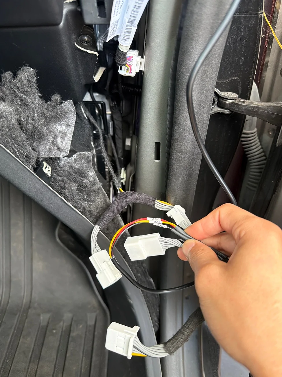

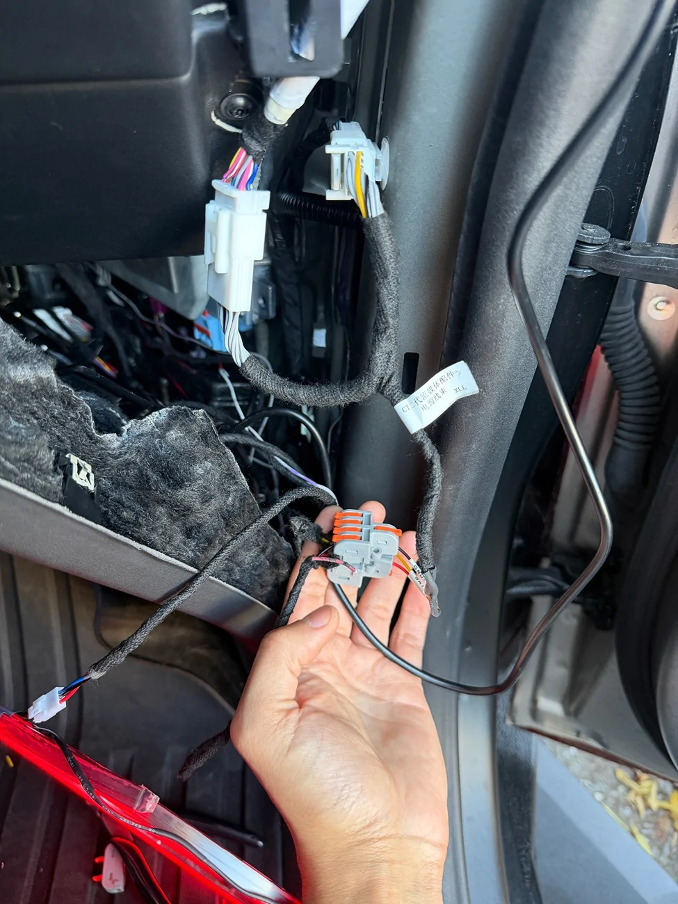

Welp it worked! (Speaker still has no sound though as expected)
But I spliced the BSD light strip and the 10.33” CarPlay screen directly into the 12” digital mirror cable for power. All 3 are working simultaneously now.
so ideally a new harness is made for each accessory for true daisy changing and no loss of power pass through. Or someone makes a splitter for this passenger harness so we can not have to worry about power pass through not making its way through the chain.
crappy I had to do this but glad all 3 are working.
Interesting about the tweeter. So it didn’t end up being the muffling problem you suspected? You could also just stop messing with the harnesses altogether and power all three and/or any other accessories you might want including the little CarPlay screen thingy using an auxbeam wired to the frunk feed and buck convertor. You’d still need the harness for on/off information and blind spot/indicator information but I’m guessing if you don’t rob power from there, the tweeter might work again.
All you’d need is a single button on the auxbeam you could label cabin accessory power or whatever.

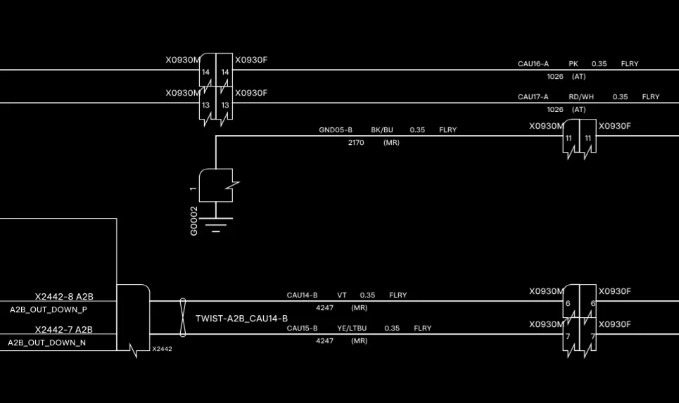

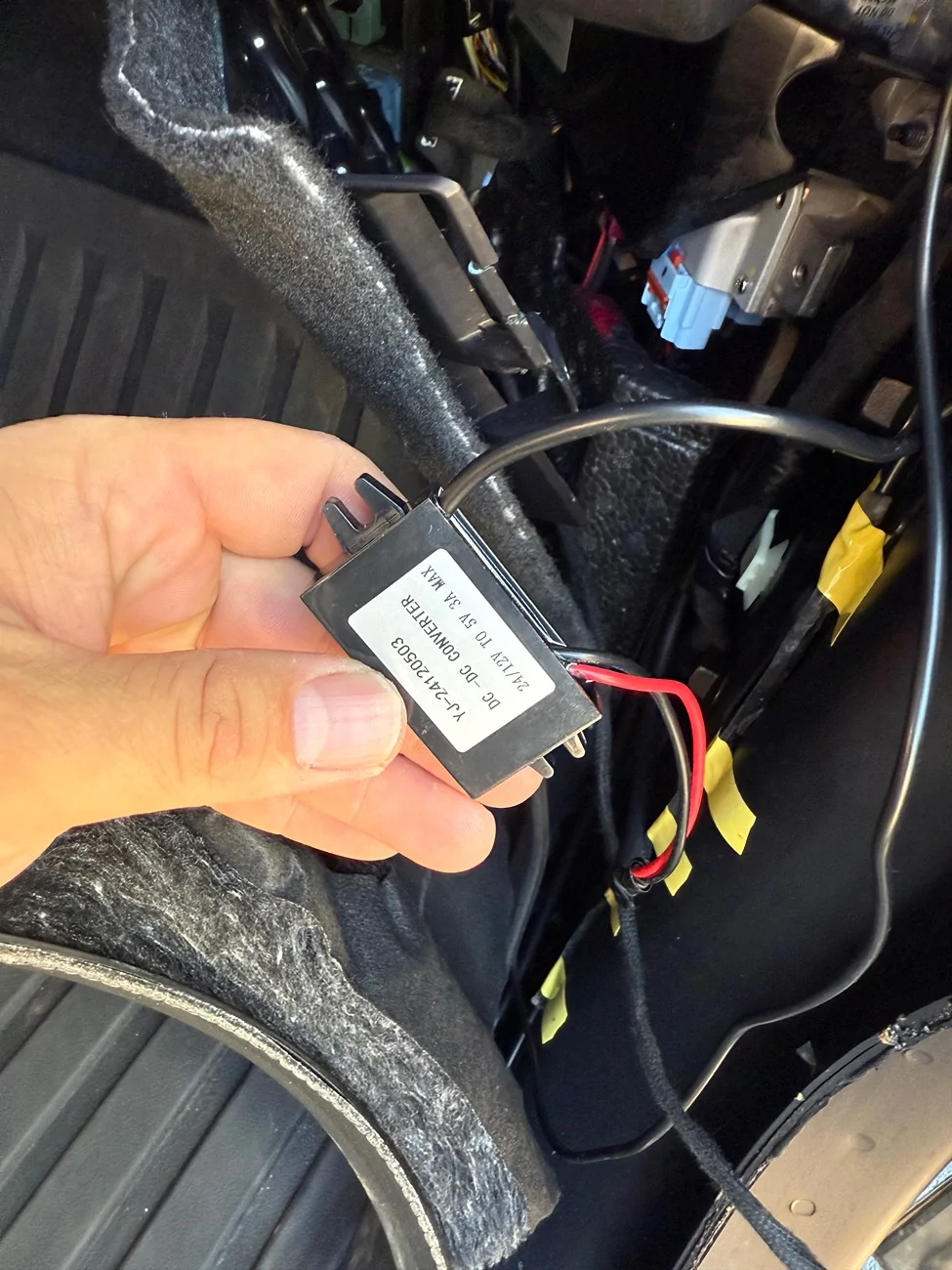

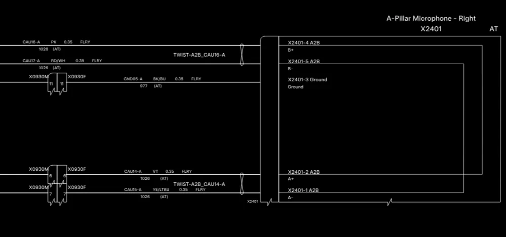

I've been digging into this and found out some interesting details on the Audio system tech.
Validate all this for yourself if you decide to do any of this.
First the short term fix for this harness issue is going to be DIY as Hansshow gave me the discount but no timeline for a harness replacement.
  1. Remove one of the unused pins from (4, 5, or 12) as they are unused. I haven't done this but without a removal tool you'll likely need some thin metal shims to release these - or - carefully use a super small flathead. Here are the pinout diagram to validate: https://service.tesla.com/docs/Cybertruck/ElectricalReference/prog-242/connector/x0930m/
  2. Cut and splice that onto the pin 8 feed that was pulled for the BAT + & ACC splice to the Hansshow power converter.
  3. Place that pin back into pin 8 of the of the X0930 male connector. This was the only one left off.
This will provide the pass through need for the tweeter feed to get its digitally multiplexed signal.
The audio system uses a digital network technology developed by Analog Deviced (ADI) called Automotive Audio Bus (A2B). In short its a digitally multiplexed signal overlayed on DC power. Like other systems this tech reduces wiring and costs. The supply going to the A-pillar tweeter must be decoded at the tweeter or somewhere close - I couln't find any reference to where it is.
Hannshow appears to have copied this technique from someone else. There were other suppliers that tapped this connector first. What likely occured is one of these companies was hunting a power tap and found supply on this line and here we are....
I say short term because I don't like the way this was done and don't know if it's degrading anything by pulling more load than intended.
May 27, 2024
4,652
5,653
The tweeter is analog, not A2B. It's a two pin speaker and carried over from the Model 3/Y.
A2B (2 data plus ground) is used for the microphones in the seats and A pillars.
The Tweeter part description is confusing because it says "active", however, that refers to it being fed a high pass filtered audio signal versus the "passive" tweeter which has a built in filter capacitor.

A2B:
Tesla Cybertruck Powering Accessories Struggles - Don't let this happen to you! AISelect_20251218_140210_Firefox
Tesla Cybertruck Powering Accessories Struggles - Don't let this happen to you! AISelect_20251218_140144_Firefox
