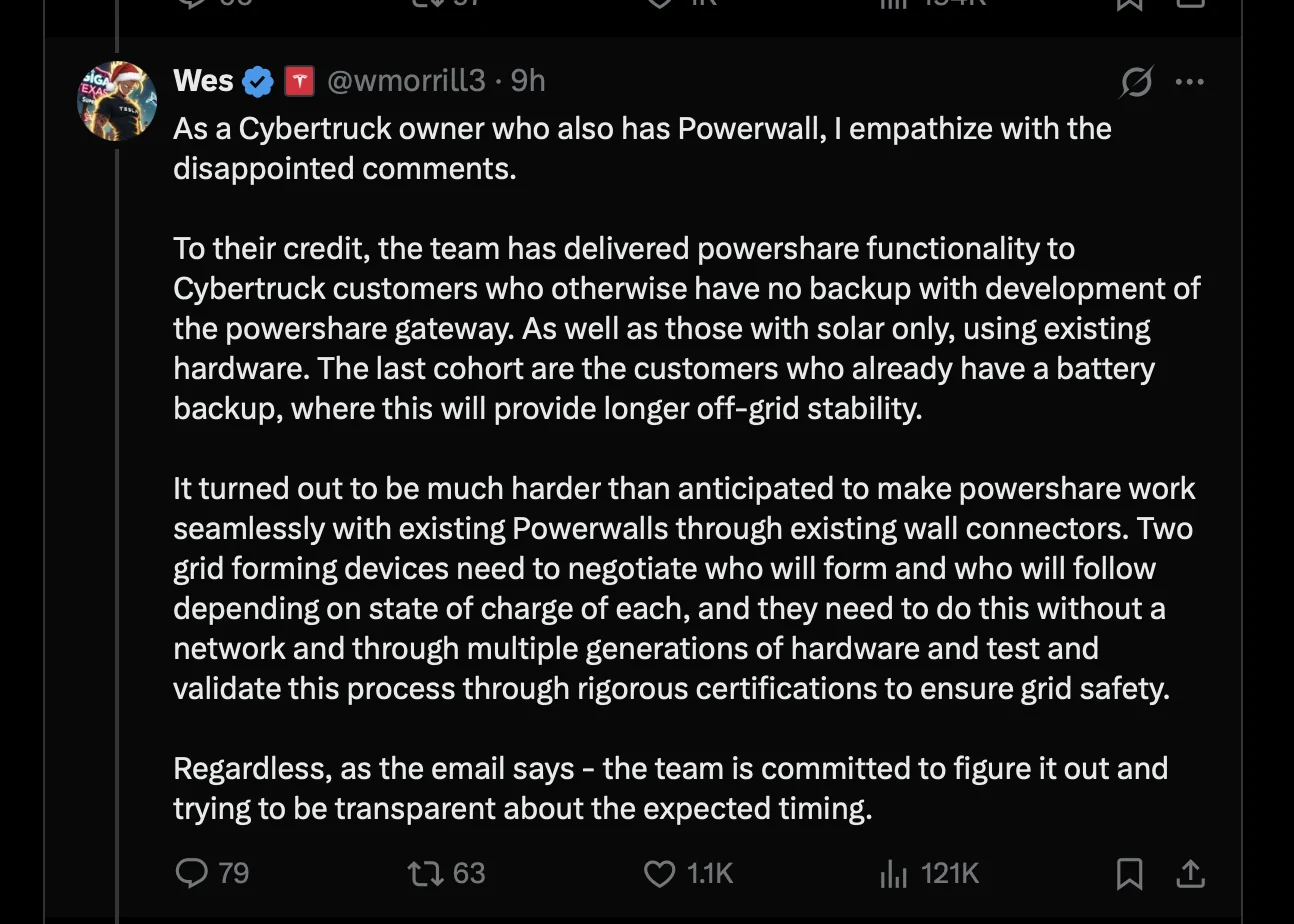

From Wes at Tesla:
Hey, I'm disappointed too. But I'm not posting disparaging comments about the team making it all happen and claiming that they are giving up. If they give up, Tesla will tell us, not say it's simply taking longer than expected. The fact that it's taking longer than expected is not surprising. Big goals require optimism to achieve.
I have optimism that the final product will be more seamless and less buggy for the extra effort. This is not the kind of hardware that you want bugs with. It has to be reliable and safe, even when the customer operates it's in weird edge cases.
Waiting patiently.

Yes that is an option. Also there is the option to use existing pWs and gateways prior to 3v. 2026 software release....I was just seeing if anyone actually had their Gateway 2 and Pws system wired already with Universal connector......
Siddhant told me that any version gateway should work. I have a V1 gateway and am really curious if it will work whenever they get this software working.
Did you also see Wes commented on this?
