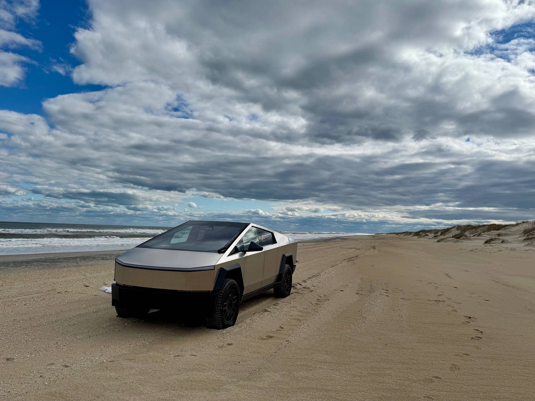

I left a heavy coating of road salt on mine for several weeks this winter and it washed right off with no noticeable effect. There were a few rust specks that also came off with a little extra rubbing. They were probably from bits of metal thrown up from the road with the salt dirt, etc. I don’t leave bird droppings on long because I can’t stand the looks. But I haven’t noticed any etching or whatever from them. Seagulls? I’ll let you know after I get back from the Outer Banks later this summer. ?. Can’t wait to drive out on the beach, sit in the frunk with a cold beer and watch the waves roll in.
You’ll have a blast! The CT is great on the sand. I’ve lived here for 20 years, driven many vehicles on the beach and the Cybertruck is the best. Just remember to air your tires down to 36 psi, doesn’t matter what you drive you need to increase that contact patch size so that you get a float effect on the sand. Finish problems are not an issue. Just regular washing is fine.
Thx! We have gone to Ocracoke almost every summer for many years. I have driven my Chevy Silverado 4x4 on the sand with no problems BUT always air down. Had a sticker on it saying “Don’t be a clown, air down.” Have looked forward to taking the CT to the beach since I ordered one several years ago. As I said, can’t wait!
