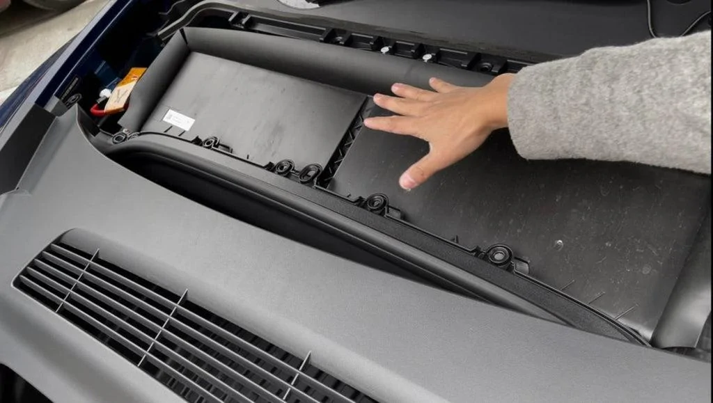

The bio-weapon defense system/ HEPA filter system is a huge filter which sites horizontal in the top of the frunk area.

Those filters don't require much airflow, unlike the radiator, and can be placed anywhere in any orientation with some ducting. I'd imagine that on the CT they will prioritise the frunk under the hood and move that tyype of stuff underneath the frunk or dash, as access to it is only limited.

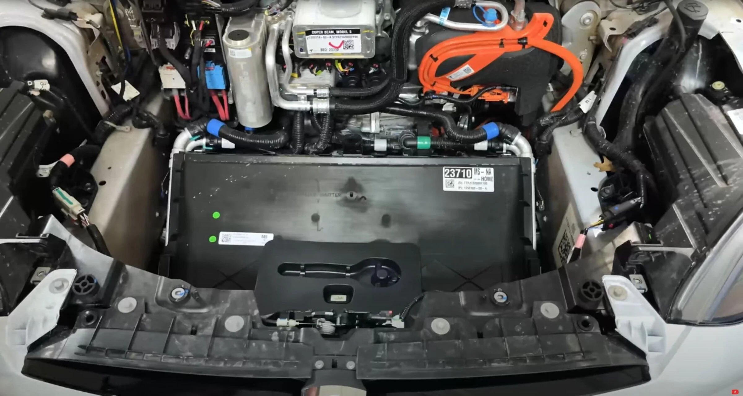

The radiator is tiny, and is diagonal to the motion of the car beneath that.
It is perpendicular to the air motion, not the car. There's no reason for it to be a plow pushing through the wind, this isn't a burning ICE engine.
It is still sizable, in fact it has two radiators back to back in that assembly, as it still needs to dissipate all the interior and motor/electronics heat which will be around 50kW, similar to a compact ICE car radiator. This is because it has some 10x the power of a compact ICE car. This is how it is mounted in the Plaid with airflow being ducted through the Plaid front bumper. It sits directly under the frunk tub.
Yeah, this is why I was saying they would tuck under the hood easily.
