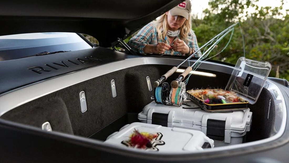

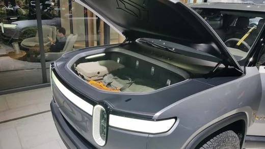

I know this is supposed to be about the side sail but since many have touched on the frunk area I'll add my 2 cents. I'd really like to see the frunk open to the bumper like the Ford. From the way the front bends, it appears that it would be possible to keep the lights the same with a slight division on each side just like Ford is doing it on their truck. Side sail storage or not, having a frunk that is more usable like a trunk would be a great thing on a pickup for everyday stuff like grocery shopping, etc as it would be providing an external storage space large enough without having to open the vault area or remove things in the bed for under bed storage access. On my Model 3, I keep things in the frunk that I want with me in an emergency but rarely access that area otherwise since the trunk is so easy and useful. On a truck, it would be just the opposite for me.
Yeah, very possible the frunk on the truck will be the more convenient/ common storage area for most stuff. Groceries in the frunk might make more sense than in the vault for example.
On the Model Y/3, the frunk is quite flimsy though, having an L shaped lid like on the F-150 would mean they would have to make it a much beefier lid. Particularly if there is going to be 3mm steel and a light bar across the front too.

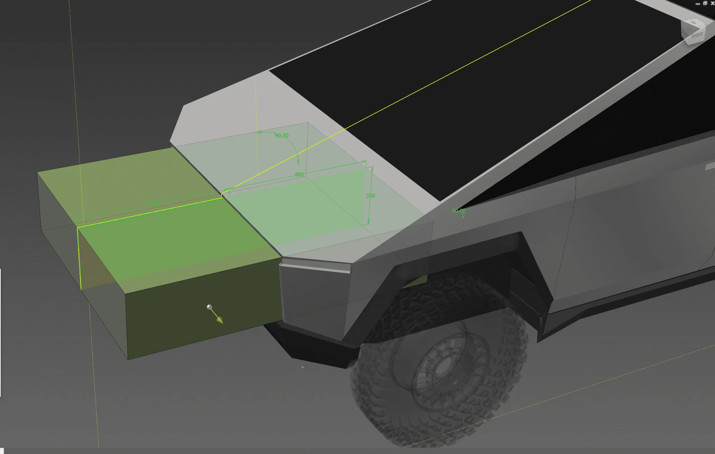

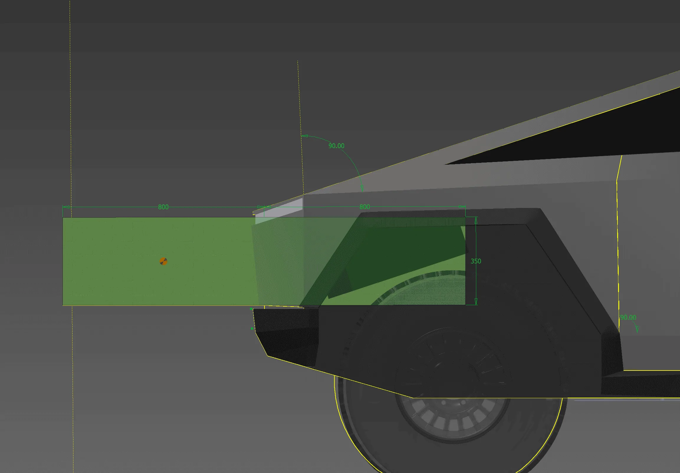

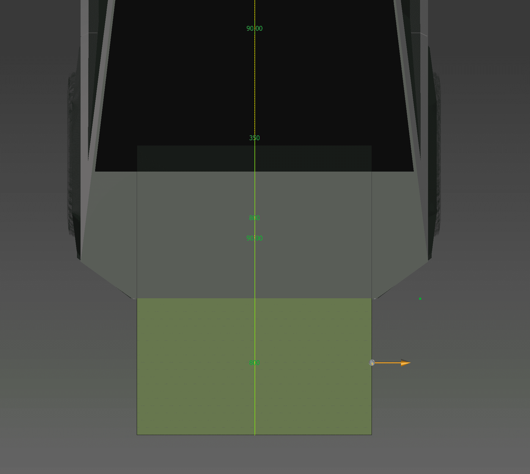

Here you go, just something to get your bearings on, I didn't make it pretty.
The drawer box as drawn is 280L (10cft) and you can see how much space it takes up in the frunk volume as well. An opening frunk lid will probably give it another 100L of volume on top.
"If" the frunk hood takes the grill with up this drawer will be available as an add-on accessory by myself (and probably others) if it doesn't come with it. It's likely that with a frunk hood and grill lift there will be a space under the lip of the bumper and the drawer. Ideal for outdoor camp kitchen or tool storage etc. It might need to taper in a bit for wheel arch clearance. Plenty of space underneath for HVAC and drivetrain suspension etc and the passenger footwell just makes it past the front door hinge, so not problems there either.
