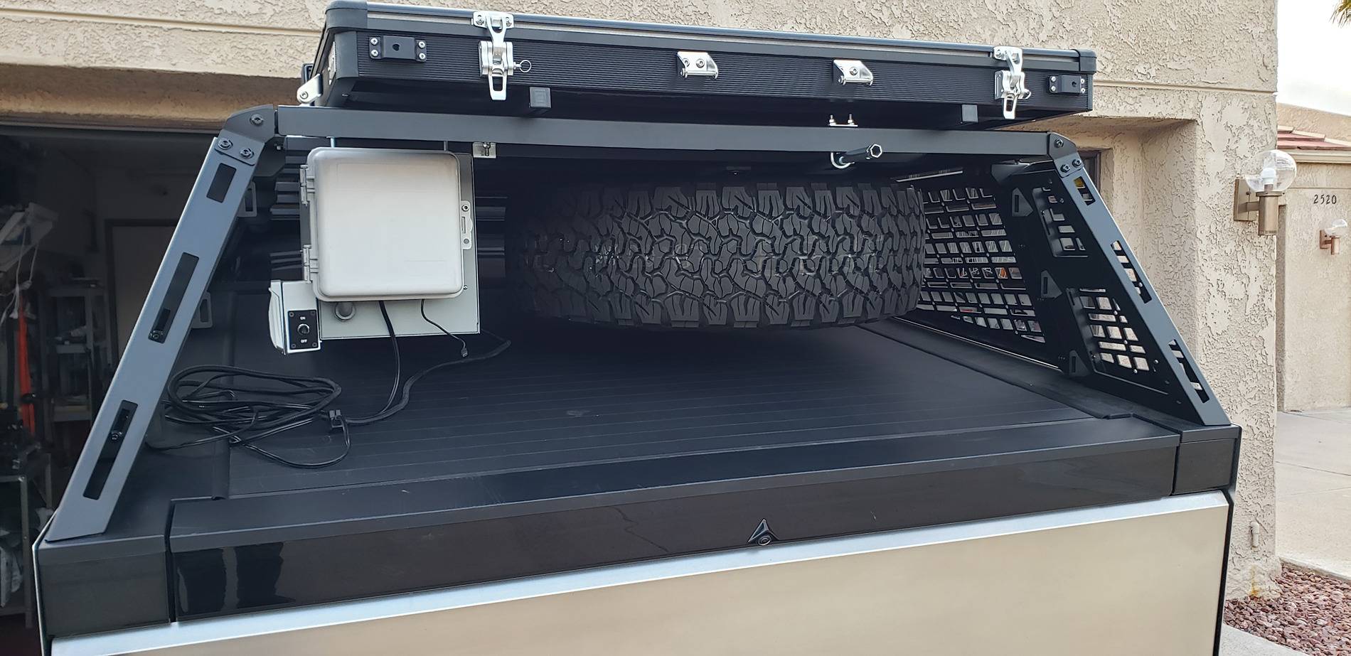

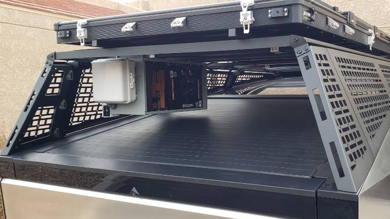

This approach requires a bed rack, of course. Urander makes this one. I mounted the solar power station (batteries, charge controller, inverter) inside the bed rack in a ventilated metal enclosure. The plastic box on the back is where 12 and 24V connections are made (refrigerator, A/C, Starlink, USB connections, etc), and there's a 120V outlet on the side (for electric blanket, CT charging, etc). The total weigh of the bed rack, tent, and solar system came to 450 lbs. My efficiency dropped from an average of 532 Wh/mi to 566 Wh/mi (-6%). I have removed the side mirrors.
Tesla Cybertruck Solar panel that cover entire back half of the truck - any interest Solar power box

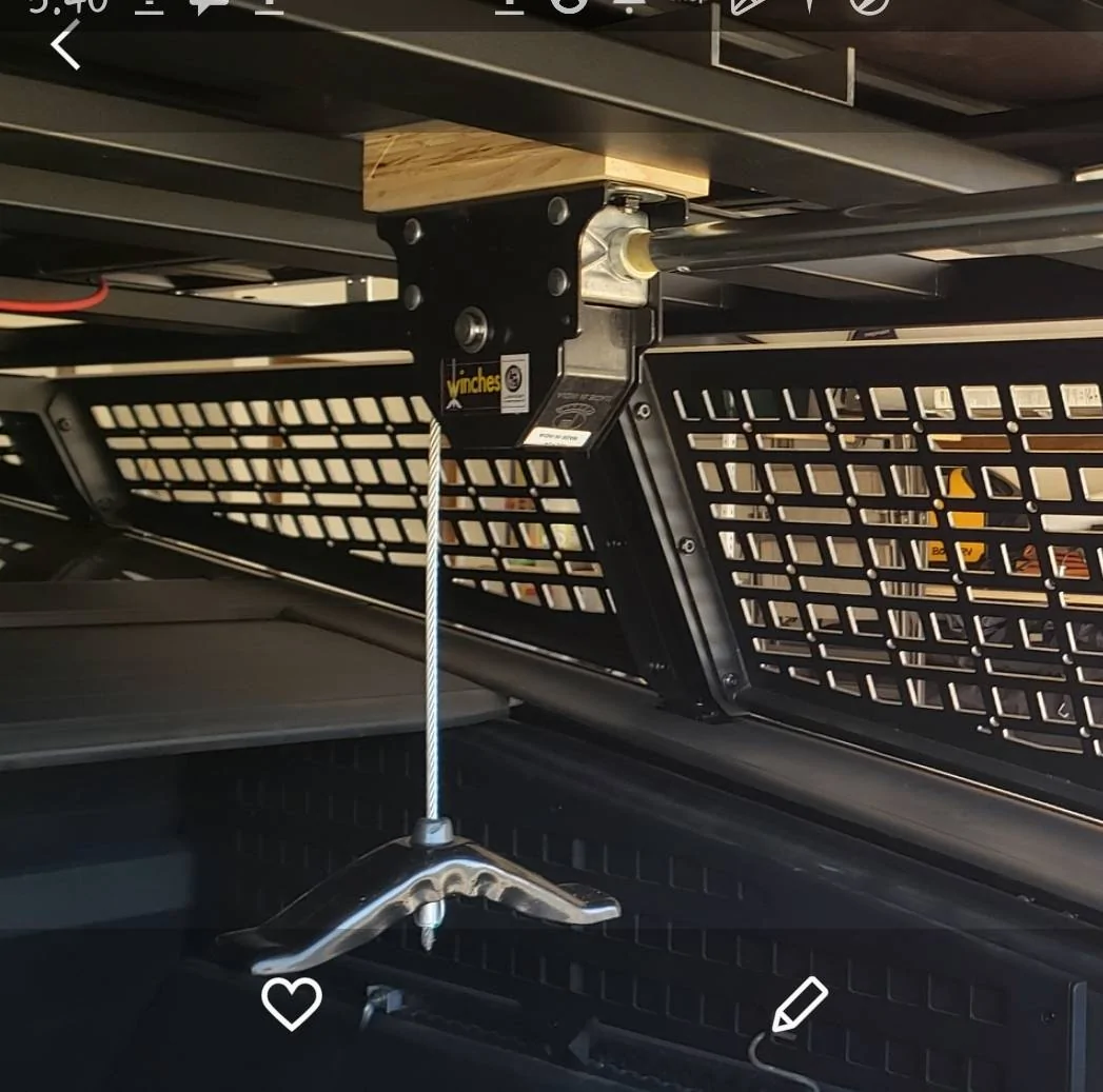

The spare is placed beside it. It's raised and lowered on a Lippert winch (commonly used on RVs). The vault is completely free for other cargo.
Tesla Cybertruck Solar panel that cover entire back half of the truck - any interest Spare Tire Mounted
Tesla Cybertruck Solar panel that cover entire back half of the truck - any interest Lippert Hoist

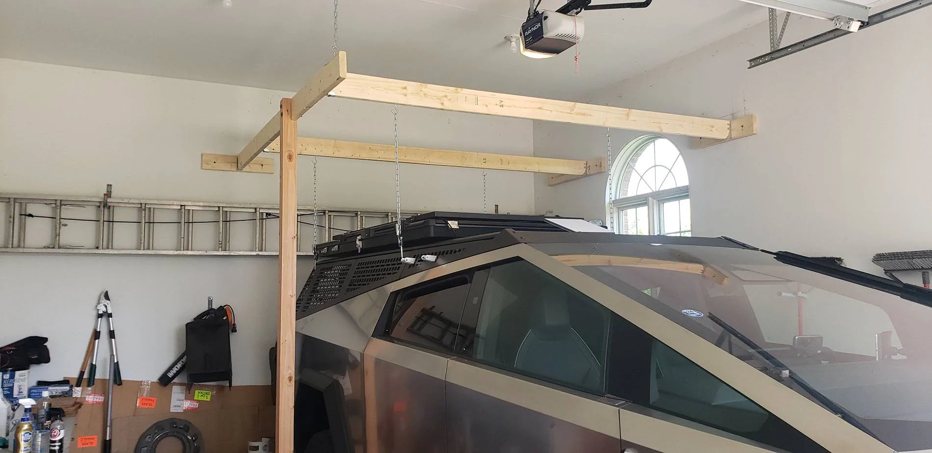

We constructed an overhead support frame in the garage for removing the bed rack when a vertically unobstructed pickup truck bed is needed for hauling. It's also best to remove the bed rack, tent, and solar system over the winter up north. I have to remove the 8 bolts that attach the bed rack to the truck, raise the truck to 'extract height', back under the support frame, hook the bed rack to the overhead support frame, lower the suspension, and drive out of the garage. The rack hangs from the support on four chains. It's not a quick and easy procedure to remove and reattach the bed rack because the two 17mm hex head bolts at the windshield are hard to get at to remove and replace. The vertical post can be removed when there's no weight on the overhead structure.
Tesla Cybertruck Solar panel that cover entire back half of the truck - any interest 20250608_114418_001
