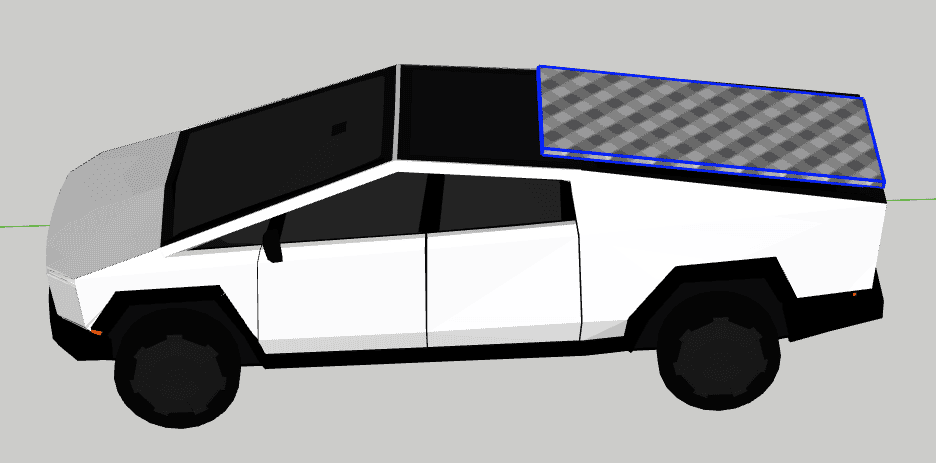

This is a fun game, I will play. I am aiming for a self contained, no "deployment" solution. It would just pivot up like a tonneau cover to use the bed.
  • Canadian Solar TOPBiHiKu7 700w
  • EG4 6000XP | 8000W PV Input | 6000W Output | 120/240V Split
  • EG4-WallMount Indoor Battery | 48V 280Ah | 14.3kWh
  • ~$5,000
The solar panel is about 94"x51". The battery could hold about ~30 miles of charge. With 700w it gathers around 3.5kw per day, or ~5 to 7 miles in ideal conditions.
Tesla Cybertruck Solar panels and battery to get unlimited range ... 1718652489052-y2
Your numbers seem a bit optimistic to me.
This is in the post you're quoting:
Of course, panels aren't perfect, nor is the angle, and you're left with not a full footprint.
Maybe, I don't know, read the entire post before calling it 'optimistic'. I was pointing out why off the shelf wouldn't work - but why there's a chance for it to do more.
  • ~$5,000
Over a 5 day trip, this would allow you to only go about 10 miles further into the boondocks.
How many more places do you get between 150 and 160 miles away from the last charge point?
Oh, and you can't use the truck during the day. It needs to stay pointed at the sun.
