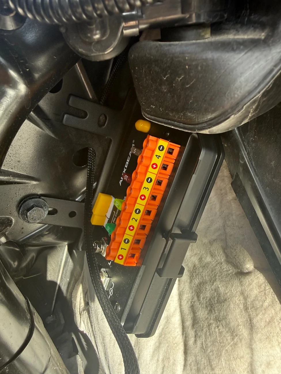

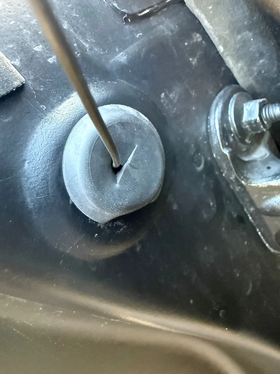

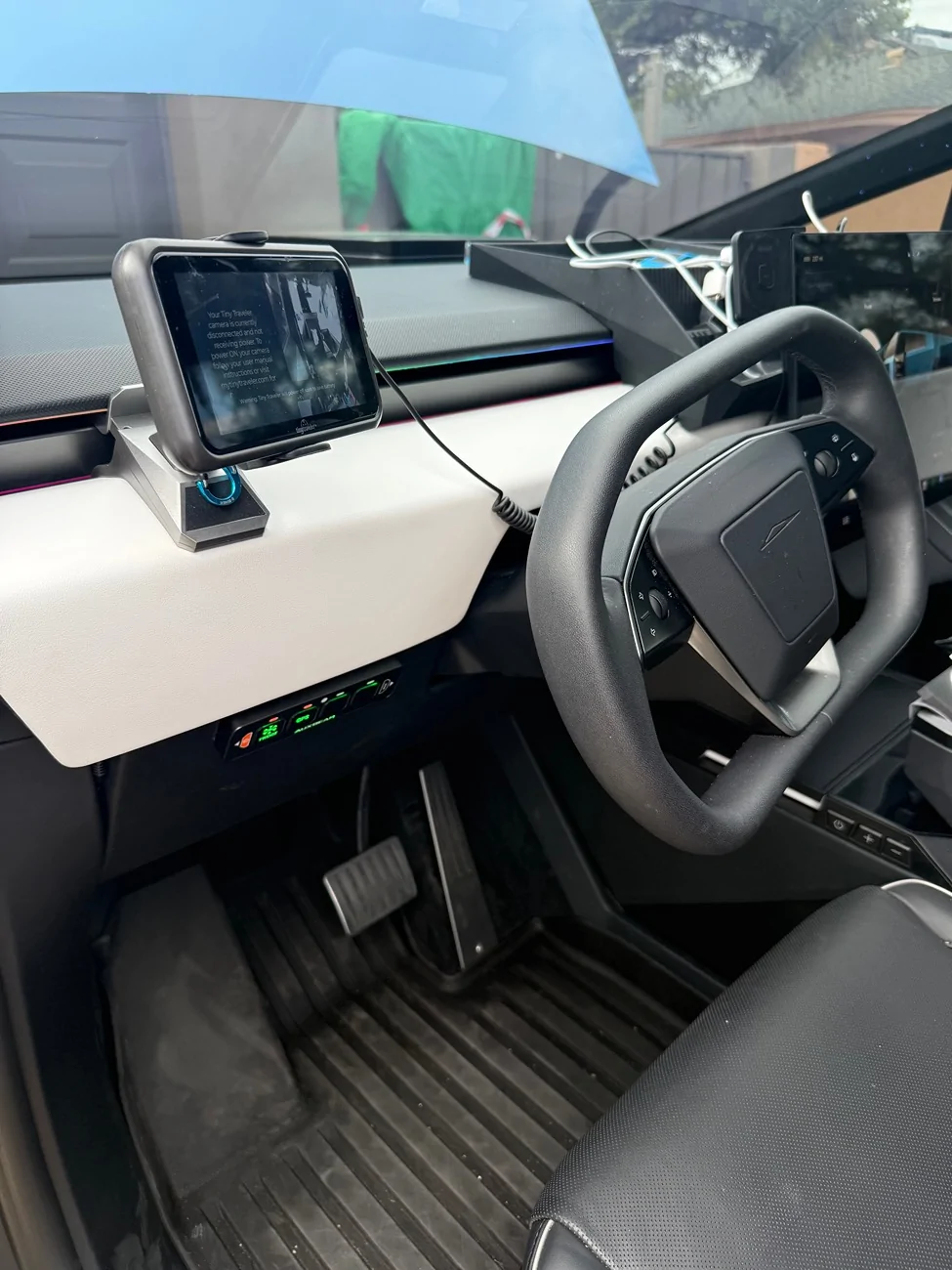

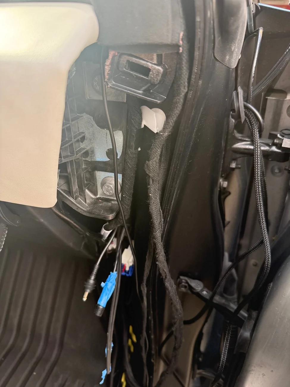

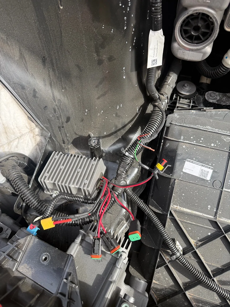

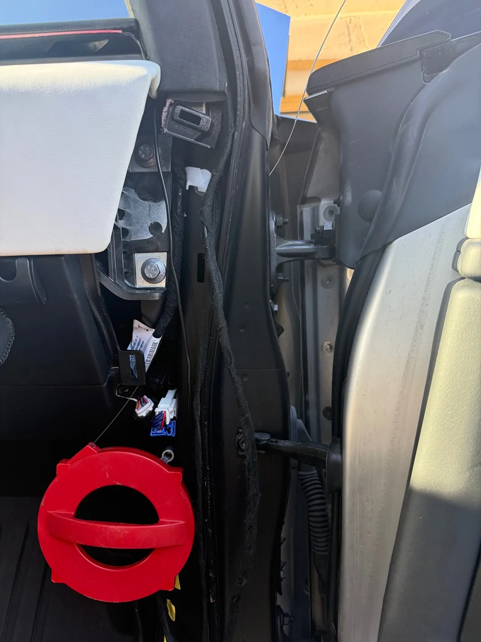

Jay and I redid my wiring together today. Happy with the outcome. Installed an aux beam switch for control of the cabin fridge, Starlink mini and smugglers den fridge. Also powered my small power station in the frunk for any electrical needs there. Have a leftover 12v source capped in case I was to add anything else.
Tried your method but still ended up going through the grommet. It’s a good approach but I don’t like how the wires sit on the sharp edge under the rubber door seal.
Tesla Cybertruck Split the 48v power line to a 12v socket in frunk. It now powers the console fridge INSIDE cabin 😎 IMG_7324
Tesla Cybertruck Split the 48v power line to a 12v socket in frunk. It now powers the console fridge INSIDE cabin 😎 IMG_7325
Tesla Cybertruck Split the 48v power line to a 12v socket in frunk. It now powers the console fridge INSIDE cabin 😎 IMG_7334
Tesla Cybertruck Split the 48v power line to a 12v socket in frunk. It now powers the console fridge INSIDE cabin 😎 IMG_7327
Tesla Cybertruck Split the 48v power line to a 12v socket in frunk. It now powers the console fridge INSIDE cabin 😎 IMG_7328
Tesla Cybertruck Split the 48v power line to a 12v socket in frunk. It now powers the console fridge INSIDE cabin 😎 IMG_7321
The last one is of the fish tape following the wire path. A picture wish I had grabbed the first time.
Thanks again for the inspiration.
