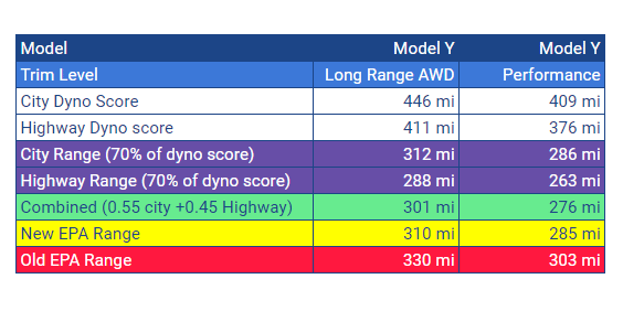

Saw this yesterday and it appears they do do both. I think this was related to when the EPA does the test at a lower speed dyno (hence the 70% factor)
Tesla Cybertruck Tesla lowers range estimate on Model S, X and Y (due to new EPA calculations) EPA testing efficency TMY

Do you have a similar table for the Model X? Or can post a link? Thanks.
