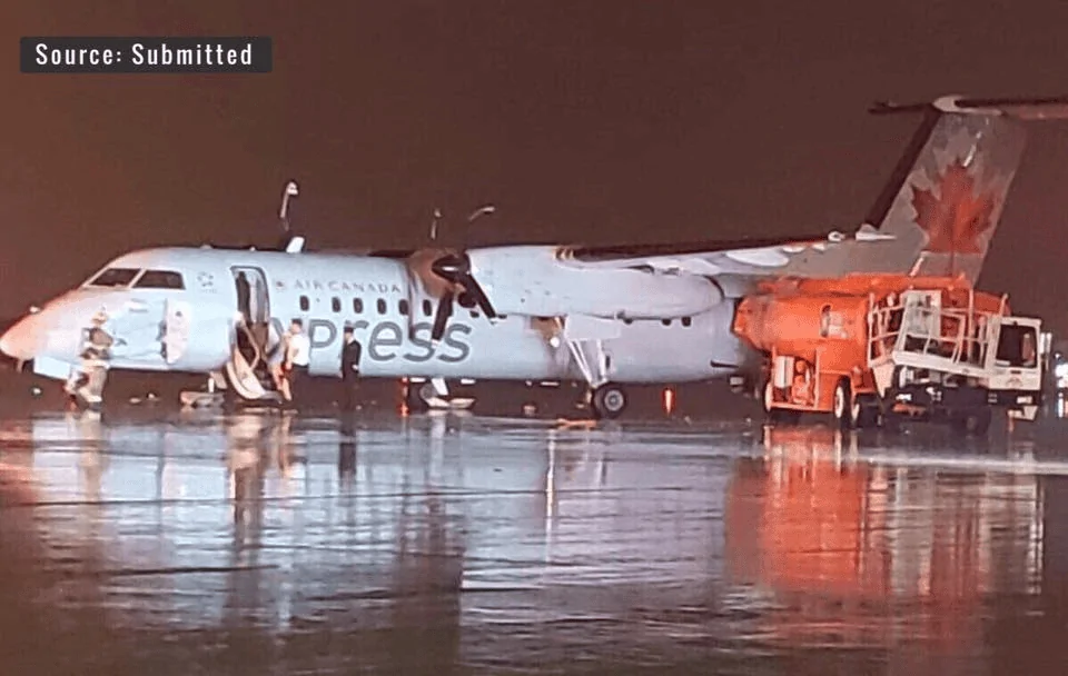

Consider that Elon refers to aircraft often when he's talking about the exoskeleton concept. What he doesn't talk about is that when the exoskeleton is damaged on an aircraft, it's often catastrophically so. And, this gives no helpful information as to how much it's going to cost to fix, what a simple fender bender did damage-wise. There is still so much yet unknown. And, we aren't hearing what we aren't hearing. peace
I actually work in aviation and I can tell you that any meaningful damage to an aircraft fuselage is often cut off and replaced. If the damage is extensive enough that it has weakened the entire structure of the aircraft, it is totalled.
I also worked as a safety coordinator for a fuel company for a couple years before my current job. Here is a photo from an incident a few years ago that I responded to in Toronto.
Tesla Cybertruck The Exoskeleton 1624627547542
That fuel truck, which was nearly full, which carried about 33000 liters when full, hit that plane going about 40km per hour (Max speed for that truck). That tanker and plane was not moved at all after the crash, the video that I watched showed the truck hitting the plane so hard that it pivoted on the back wheels and swung around and hit the back of the tanker. Initial reports were that the plane was going to be totalled, but a couple months later I seen them working on it at an Air Canada hanger and found out from the maintenance guys there that apparently it could be repaired.
Now if we look at a Cybertruck, it is sectioned off, it's not just one big piece of metal. I don't know if it will be welded or bolted, but I don't see Tesla making a vehicle that is likely to be to totalled easier than other vehicles on the market. If the front end is damaged, I would suspect that they would remove the damaged parts of the exoskeleton and replace them; just like how they would cut a section of aircraft off and replace it. It's more common than you think, if you ever see an aircraft with a random square on the side that looks like it's newer than the rest, that plane was probably struck by lightning and they cut off whatever part was hit.
