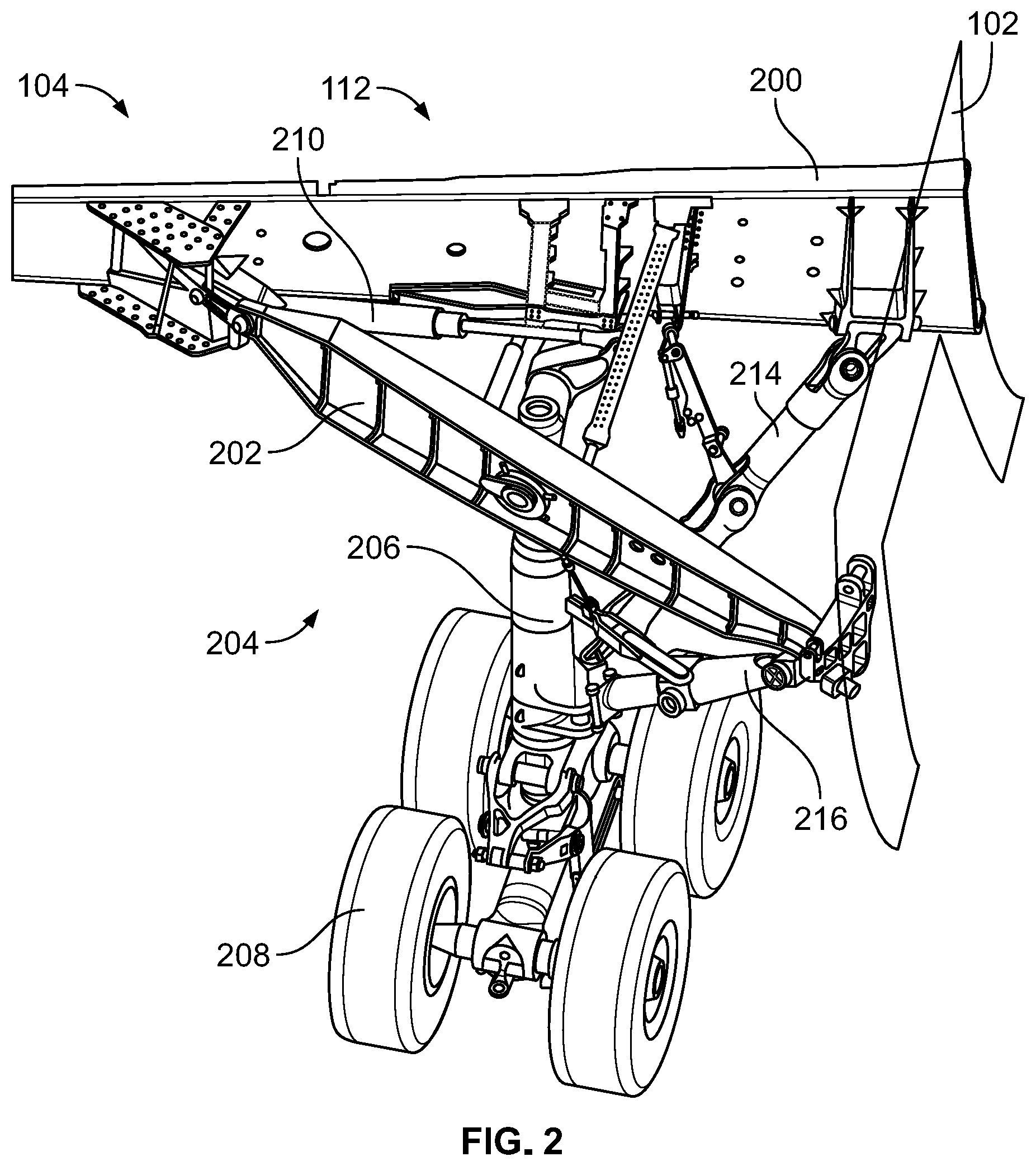

Fellas, ladies, I'm detecting a distinct lack of aerospace application.
Figure 1 (2...):
Tesla Cybertruck No Exoskeleton US20200324882A1-20201015-D00002
Aircraft landing gear must be attached to the fuselage using large, trussed (giga)cast, machined or framed members, yes?
HOWEVER see Figure 2:
Tesla Cybertruck No Exoskeleton TpWYH

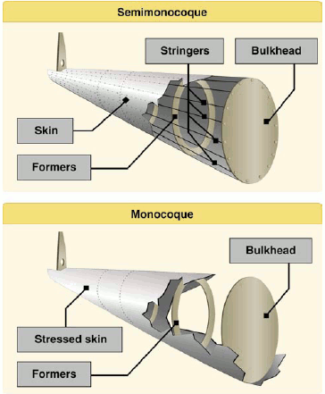

Aircraft also use the skin as a structural member in the fuselage (body), more so in a monocoque design, but even semimonocoque too.
The "landing gear", colloquially know as wheels/ suspension for the CT will still have members and castings to attach it all to the body but that does not derail the idea that it also will have a stressed skin and a form of exoskeleton.
Do I think it will be all stressed skin and no substructure? No, CT is not a soda can. But in press "exoskeleton" sounds a lot cooler and is more digestible than "semimonocoque", so don't get your coque in a knot.
But in short, yes. Exoskeleton!
Also Cybertruck is now not just a boat but also a plane.
Any questions?
yes exactly, though I think at bottom the “disagreement” going on here is whether whether and how those members are attached to the stressed skin in a manner similar to an aircraft. In an aircraft those members are adhered to the skin to a degree to make the unit. In a, eg, Model Y, they are merely “hung” upon the member.
@JBee keeps insisting he knows they are attached in a way dissimilar from how members are attached in an aircraft, and instead like a model Y. Similar assumptions and assertions as Cory Steuben at Monro and Associates (who do aircraft engineeeting)
Others (me) hypothesize that if instead the members are attached to the stressed skin in a manner similar to aircraft, Tesla has a colorable means of correctly describing the CT to have an exoskeleton - unlike @JBee I dont claim to know it, instead just trying trying to understand how Tesla may be thinking
