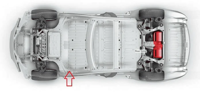

I'm not sure what answer is you're looking for, but Crissa didn't come up with those points, tesla did. We just listed them in one place from what we have seen and have been told.
Heres some pictures from them:
1. Exoskeleton safety cell
Tesla Cybertruck The Exoskeleton 1624844874109
2. And 3. That sits on structural battery pack and front and rear castings shown on battery day
Tesla Cybertruck The Exoskeleton 1624845218766
4. And tesla crash aborbing structures front and rear (disregard the arrow)
Tesla Cybertruck The Exoskeleton 1624845532798

I'm not sure what answer your looking for, but Crissa didn't come up with those points, tesla did. We just listed them in one place from what we have seen and have been told.
The crash absorbing structures are fine, but this is not a Cybertruck. So, even if this was whatever model is most closely related to the CT, this is still not a picture of the CT underbody. So, it's not hard fact that the CT will have any of this, though maybe some. I'm also not saying it absolutely won't have it, just that this picture is not a "if/then" case. Seeing it in other models that aren't exoskelton in design, and even if they were... not a truck, meant for off-road as well as being prepared to protect in an accident.
So, maybe, but not absolutely is all I'm saying. People take stuff like this and start touting it as fact, and it's not. It is for that car, and that model of car, but not necessarily for all Tesla's, and certainly not necessarily for the Cybertruck. peace
Well, I'm just describing what already exists. I can't know how specifically it'll be arranged, but I know the broad strokes.
I'm getting the 'cut off the damage and bolt on a repair' from Elon, actually:
https://insideevs.com/news/448213/elon-musk-repair-concerns-new-body-structure/
The other parts are from how cars are built today and Munro's examinations (boy he can go on and on but the real keen bit is that he's able to take so many cars apart and points out failure or cost points)
