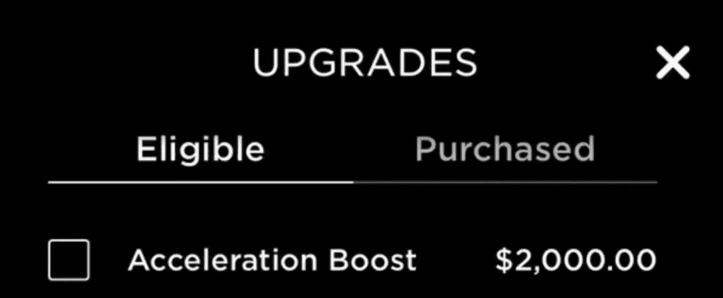

The reason is precedent. Prior Tesla vehicles were thought to be at the limit only to receive firmware updates improving performance. No reason to believe Tesla has no room for improvement here.
The acceleration boost option had nothing to do with the limits of the battery and motors. Both the motors and batteries are the same as the MY Performance, in that case they were just software limited.
This whole software neutering thing is dumb anyway.
I don't have a problem paying for extra software functionality, like buying a new program for my PC, or FSD, but intentionally reducing the performance of already existing hardware, that the customer has bought, like Apple made popular, is a big nono in my book.
However, if through collected operational data they see that more performance is available without impacting reliability, then sure I would be happy to see incremental improvements over time as the data becomes available and things get dialed in.
In this case it's pretty clear that the AWD is software neutered to 113MPH so the CB has a "perk" with a higher 130mph limit. This has nothing to do with the extra power available from the third motor though.
