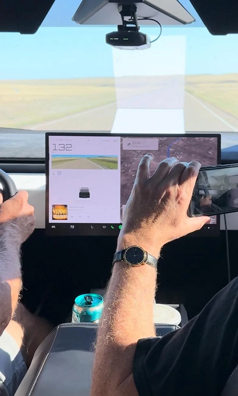

Just a point of note, I never had any drive unit replaced, my Cyberbeast was delivered on May 4th, built sometime in April 2024, it was able to achieve this speed as delivered from the factory.
