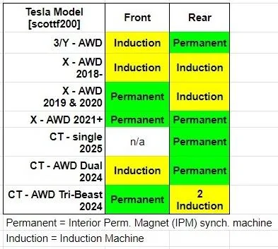

As he's said, the Cyberbeast is basically a front wheel drive truck until you really punch it. That's probably why it spun the front tires until he engaged enough for the rears to really start putting down power. The AWD Cybertruck is the opposite, a rear wheel drive truck until it's needed...
Until I see instrumentation I won't believe the 'punch it' comment.
I use ScanMyTesla on my '17 TMX (2 induction) and in 'Range Mode' where it favors the rears but
it reacts instantly to the slightest accel pedal movement as I recall.
Regardless of what you believe, the Tri-motor Beast is primarily a front-wheel drive vehicle at steady cruising speeds. When you climb steep hills requiring more power, punch it on the flats, drive at high speed or tow something heavy, then power is dialed into the rear wheels. The rear wheels will also take over if the front wheels are having trouble getting traction. The front motor is used whenever power application is light, and the front wheels have sufficient traction, because it provides the most efficient cruise and induction motors can be efficiently coasted without having regen braking happen.
Because towing loads the rear wheels and unloads the front wheels, the dual motor is the better option for towing efficiency, especially climbing those steep gravel grades in Kyle's towing test loop in the Rocky Mountains. That's because the more efficient permanent magnet motor can handle more of the work if it is on the rear axle, as it is on the Dual Motor Cybertruck.
The Beast has more towing power, but I think that's kind of a moot point because the Dual Motor has all you need to tow up to the rated limits.
