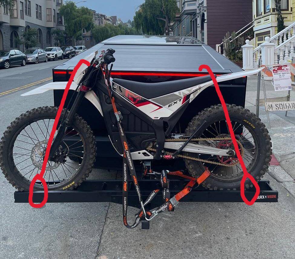

If I were you, I would attach a tie down to each side of the carrier. Pull them over the tailgate and secure them into the bed at an attachment point. That should give you the piece of mind to have this setup safely while in motion. Don't give up on your dreams because of some wussy vertical load limit.
Behind the wheels, despite my illustration.
You are probably the first person out of 100 that has actually used critical thinking when I’ve asked this question, you’re giving me hope.
But that’s not a bad idea at all. Totally see what you’re saying to avoid the twisting of the hitch and stabilize the corners. I’ve also considered getting this from unplugged performance but the only thing they can say is “it’s a lot stronger”
It would also reduce the maximum downward force on the hitch when you hit bumps. The carrier would pivot down and then meet the tension of the tie downs. There by keeping you within the documented load limit. If you put a 2x4 on top of the tailgate that would spread the load so its not baring down on two 2" inch sections under the tie downs.

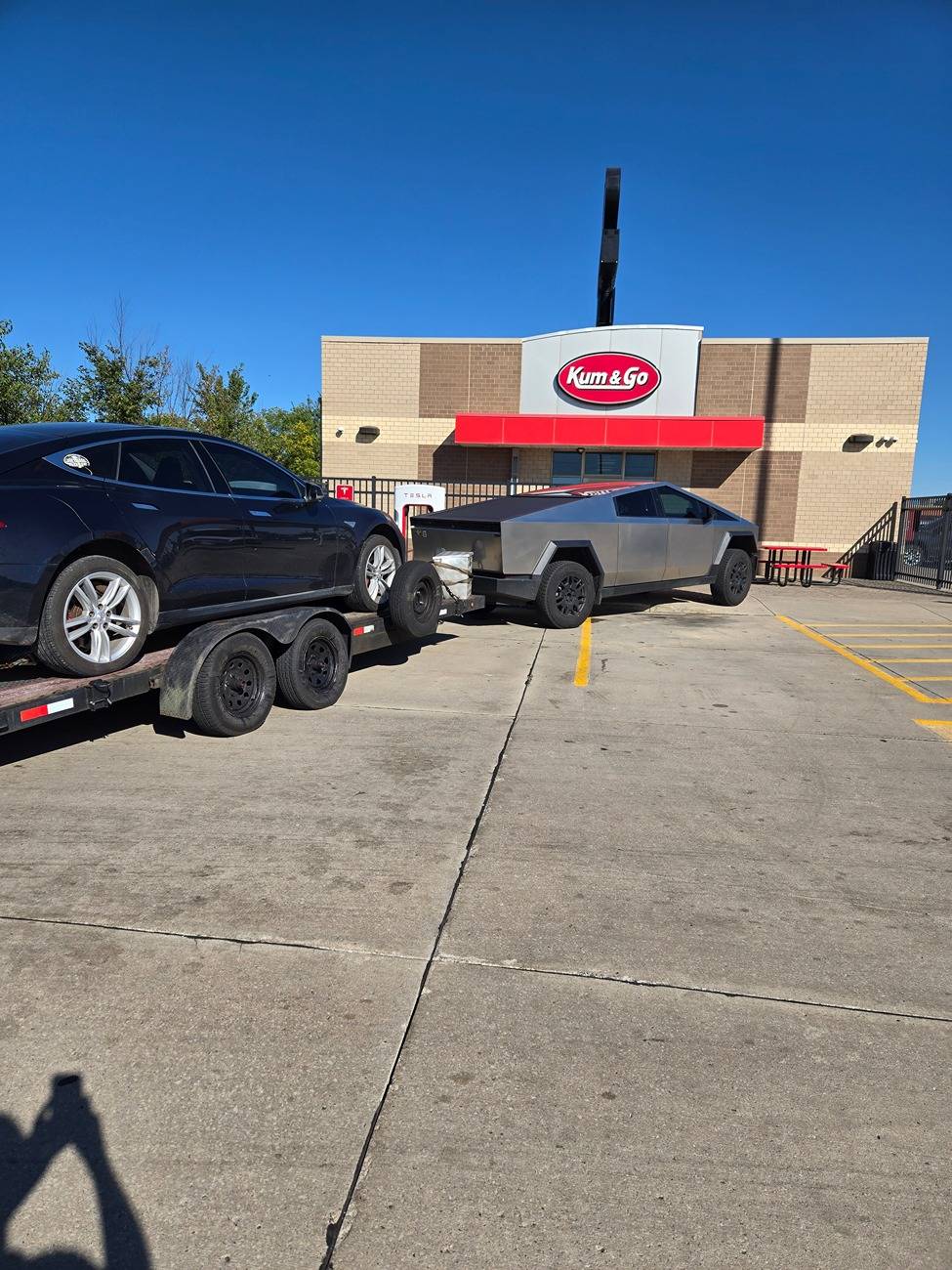

11,000 towing capacity would equal about 250 minimum tongue weight depending on axles under trailer. I'm towing 7500 today. 2 axle trailer.
Tesla Cybertruck Vertical load limit vs. tongue weight limit 1000007069

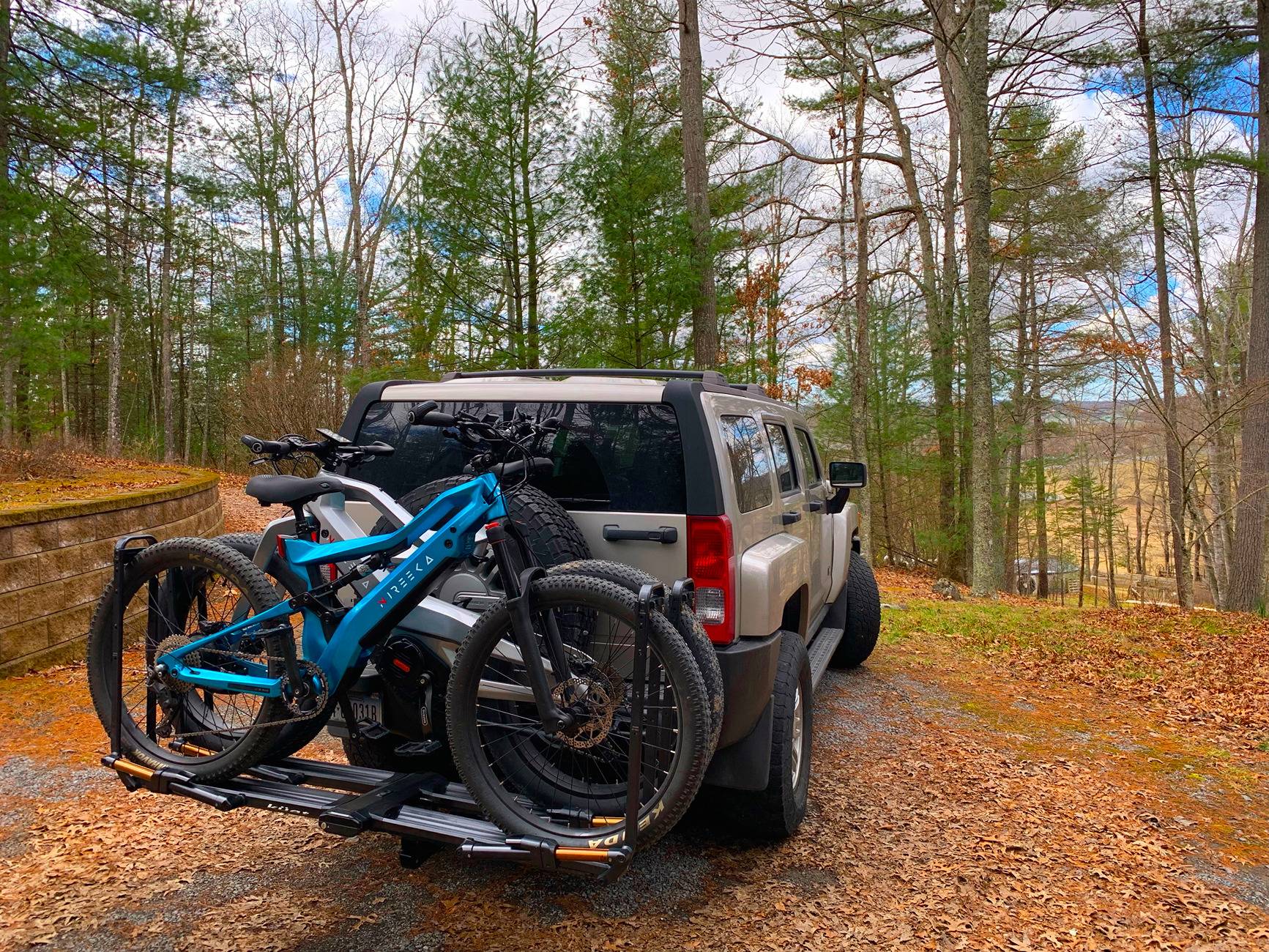

So this configuration with two 63 pound e-bikes and a 60 pound rack is too much for a Cybertruck?
Tesla Cybertruck Vertical load limit vs. tongue weight limit IMG_2327

Supposedly from the owners manual, yes.
That's a shame. I guess we will need to develop an upgraded hitch system to hold more weight for these types of applications. :unsure:
