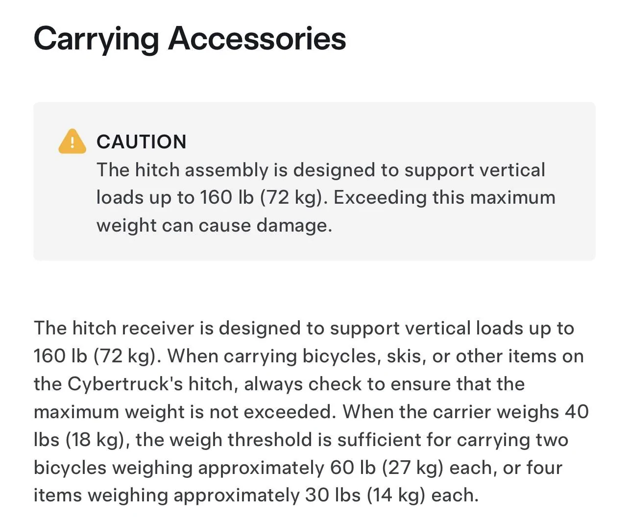

Explain how 1100 lbs maximum tongue weight equates to 160 lbs vertical load limit. That doesn't even make any sense. I guess someone needs to point out the document error to Tesla.

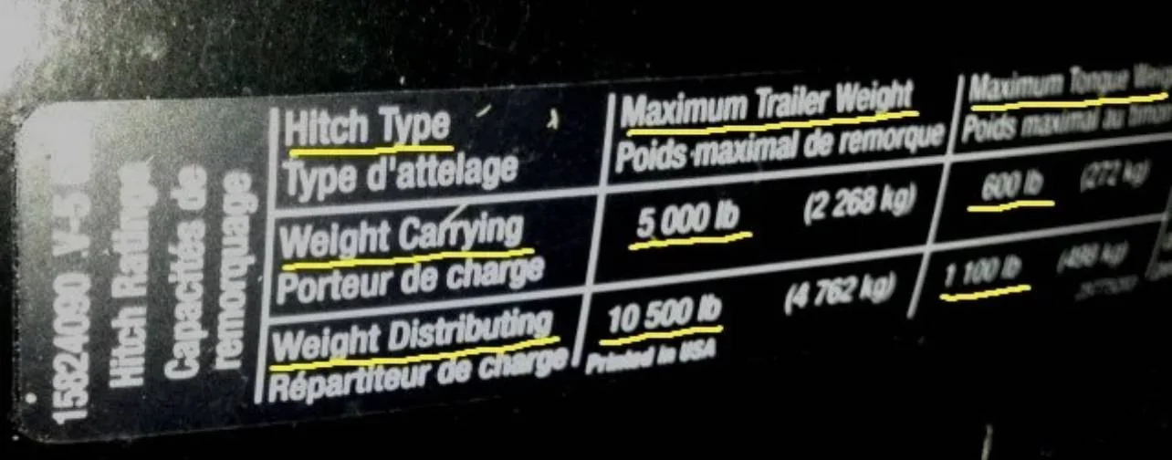

No we’re on the same page lol however, there is a difference between tongue weight and vertical load limit. Look at this tow rating from a Silverado. 1,100 tongue weight (weight distributing) and 600 tongue weight (weight carrying)
The values have nothing (directly) to do with each other.
Tongue weight is a different thing than (unconstrained) hitch vertical load.
The tongue is part of a trailer.
The hitch receiver is part of the truck.
A ball adapter allows a trailer to connect to a hitch receiver.
It's not an error.
Cybertruck was tested using the standard 160 pound weight test for hitch mounted accessories.
It was also tested using an 11k gross, 1,100 pound tongue trailer configuration.
One could extrapolate that the trailer test implies a higher theoretical accessory capacity, but that was not tested/ certified.
That's yet a different thing of a standard hitch versus a weight distribution hitch.
Neither number is a hitch mounted accessory weight value.
It's not an error.
If that hitch attachment point can handle 1100 lbs, the 160 lbs value is not the maximum. Granted it may be what they tested but not what it can safely handle.
