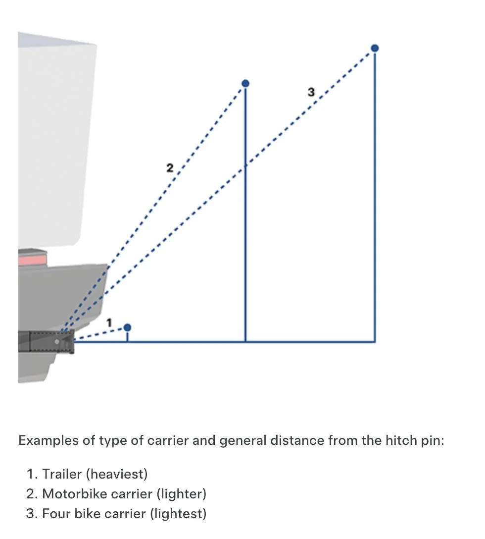

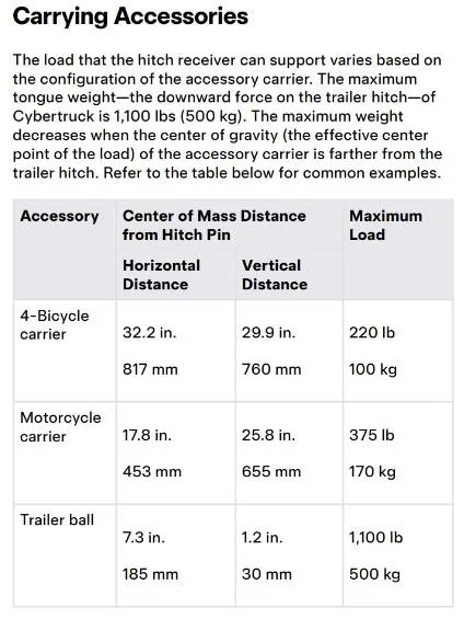

Wanted to answer tow hitch accessory questions with a few examples. There are many different accessories, but the relationship is clear.
To simplify it, when you increase the distance away from the hitch the load capability goes down. The 11,000lb tow rating isn't absolute.
You can think of it as holding a heavy weight against your chest, it's much harder to hold that same weight with your arms outstretched.
This is now updated in the owners manual online and in-vehicle to make it easy to find and clearly explains with more text and diagrams.

Nice, all of the new numbers provided in the examples are higher than the originally stated 160lbs.

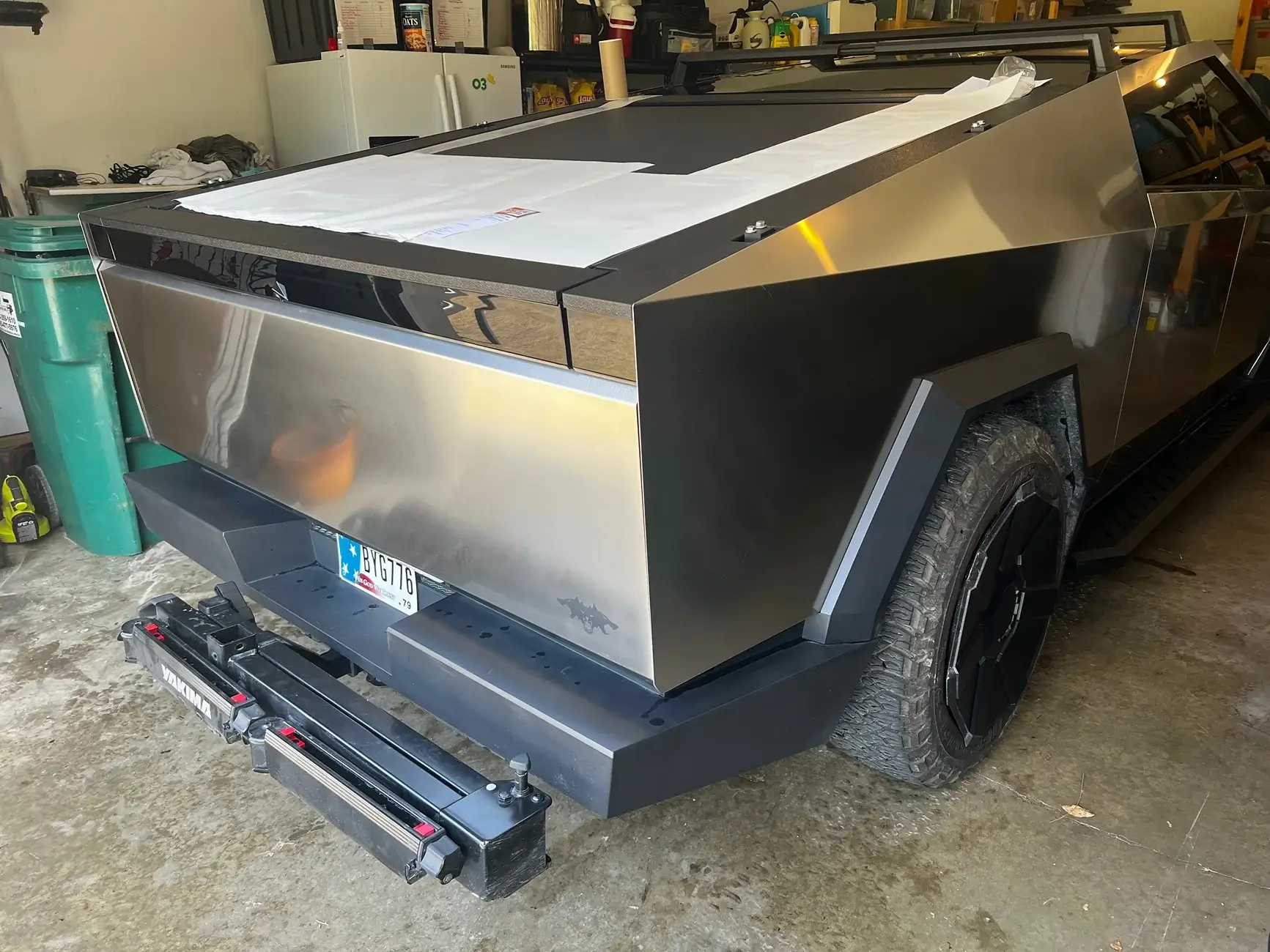

This looks like the right thread to throw another product in here for evaluation.
https://yakima.com/collections/exo?srsltid=AfmBOoqjsLSd8eek3Uw03w5IuzgTxPZ3W5bduCun7eilNrlQMwlTjW0C
Swingbase: 68.5lbs
Top shelf: 33.50 lbs
Gear locker: 27.8lbs
Snowbank: 13.25
Total weight of hardware: 143.05lbs
Reading the previous posts, it looks like this attachment will fall inline with the motorcycle carrier and allow a total weight of 375lbs leaving 231.95lbs worth of cargo. Another member shared a photo of the base attached. True or flase?
