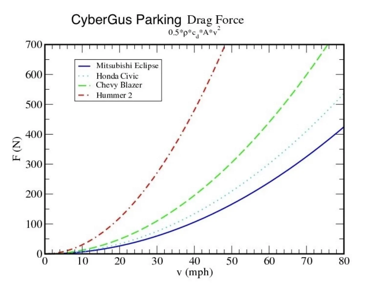

I think the underlined is possibly your error
As speed increases, the drag force on the vehicle will increase more steeply for the CT than for the MY.
Their parity in range at EPA conditions is basically an artifact of the relevant battery size as relates to their respective frontal plane/Cd.
Meanwhike, there are other factors at play, such as the power-torque curve of the engine and selected gear reduction, which can affect relevant range as well. And here, the CT’s ‘sweet spot’ is possibly ‘tuned’ different/worse ar upper highway speeds than a MY, since the CT is also ‘tuned’ for low end power/torque for off-road/towing/rock crawling.

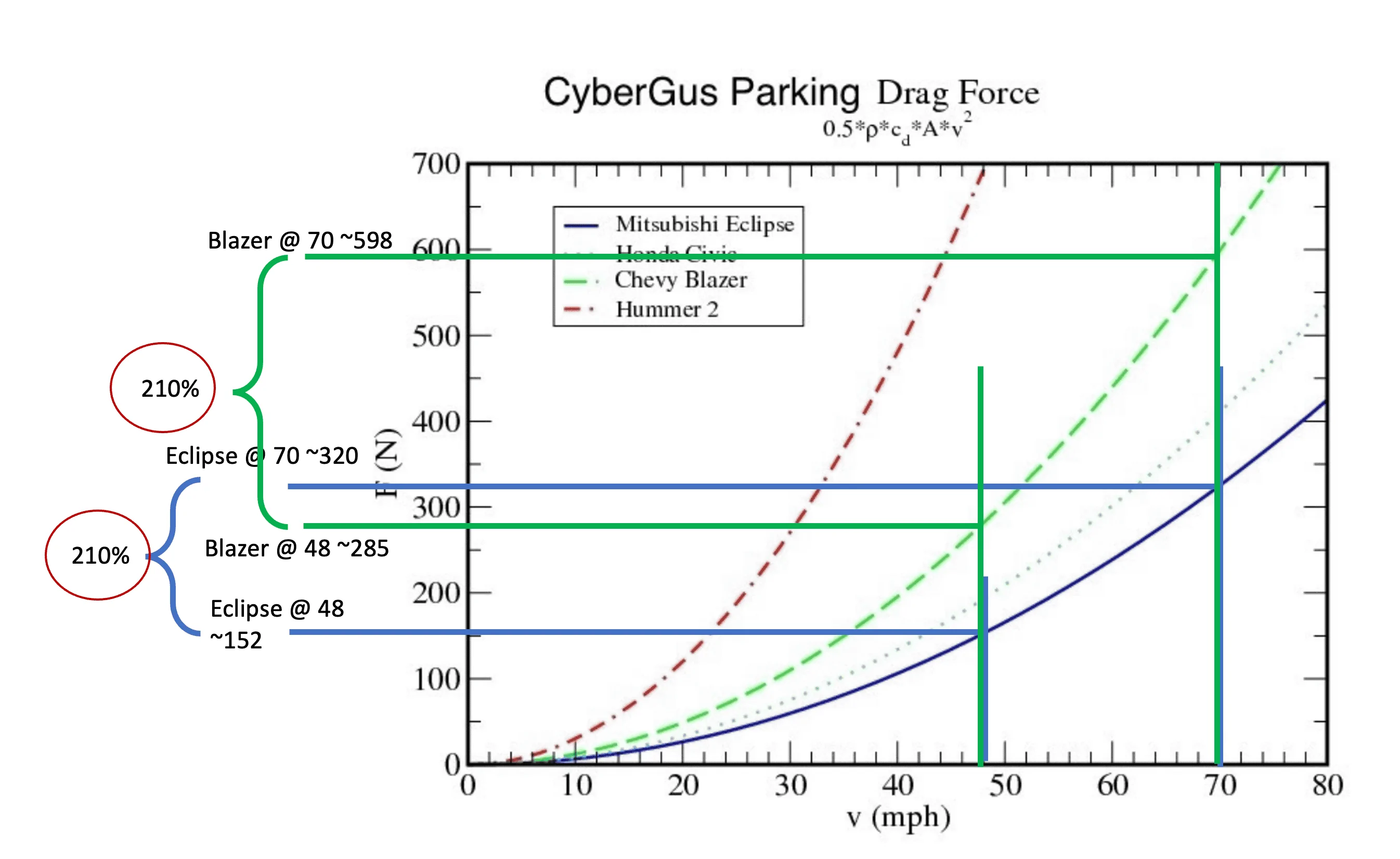

I think you will find that in your chart the percentage of additional energy required to go from say 48 mph to 70 mph is the same for the Eclipse or the Blazer. So if both start with enough energy to go the same distance at 48 mph then they will be able to go the same (shorter) distance at 70 even though the Blazer will consume far more energy in total. At least that is how I see it.

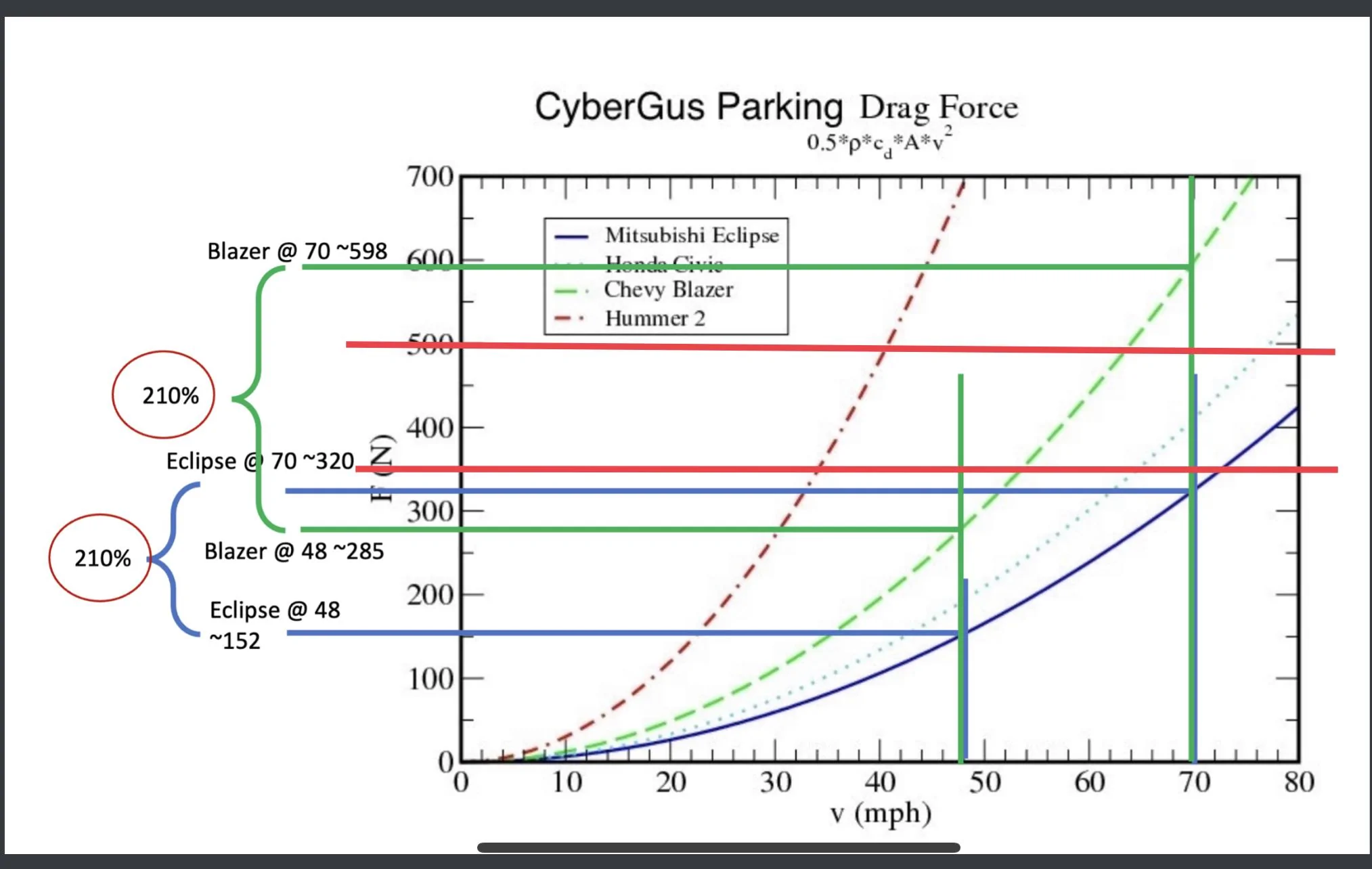

I’ll admit I only have one eye and 2 brain cells working today. Having said that, I’m not sure I’m following.
maybe another of our fine members can arbitrate/cure me of my ignorance
While I agree that when both vehicles are at 0% they’re both at 0%, the original question I thought was “how could a CT use a greater percentage of its battery/mi when traveling at [80]mph than a MY traveling at the same speed”
the answer I’m suggesting here is that it takes more energy/mi for the CT because the drag force on the CT at [80]mph is far greater than the drag force on a MY at [80]mph (then also greater rolling resistance of the tires, and differences in efficiency due to the sweet spot of gearing of the motors].
What you show in your graph basically seems to assume both vehicles have unlimited/sufficient battery to “absorb” that extra energy.
But we’re here, I think, talking about when does that energy curve run into the “end” of the battery.
in the modified chart below, the bottom red line represents the total N of energy in the Eclipse’s tank, while the top red line represents the total N of energy in the Blazer’s tank.
Tesla Cybertruck Wh/mile efficiency reported on the highway (heat on, 30°F, 85 mph) 26628F46-9B4D-4812-A458-54D9BD2917E0
the eclipse makes it the 210%, while the Blazer doesn’t

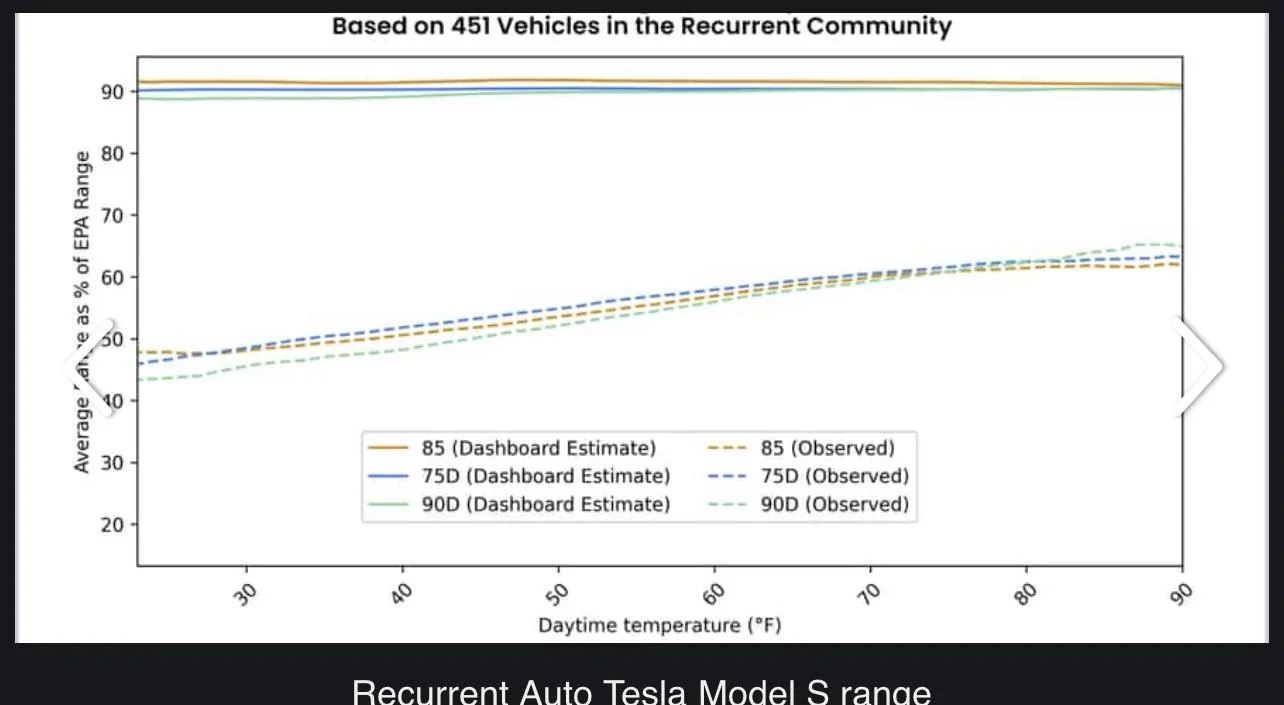

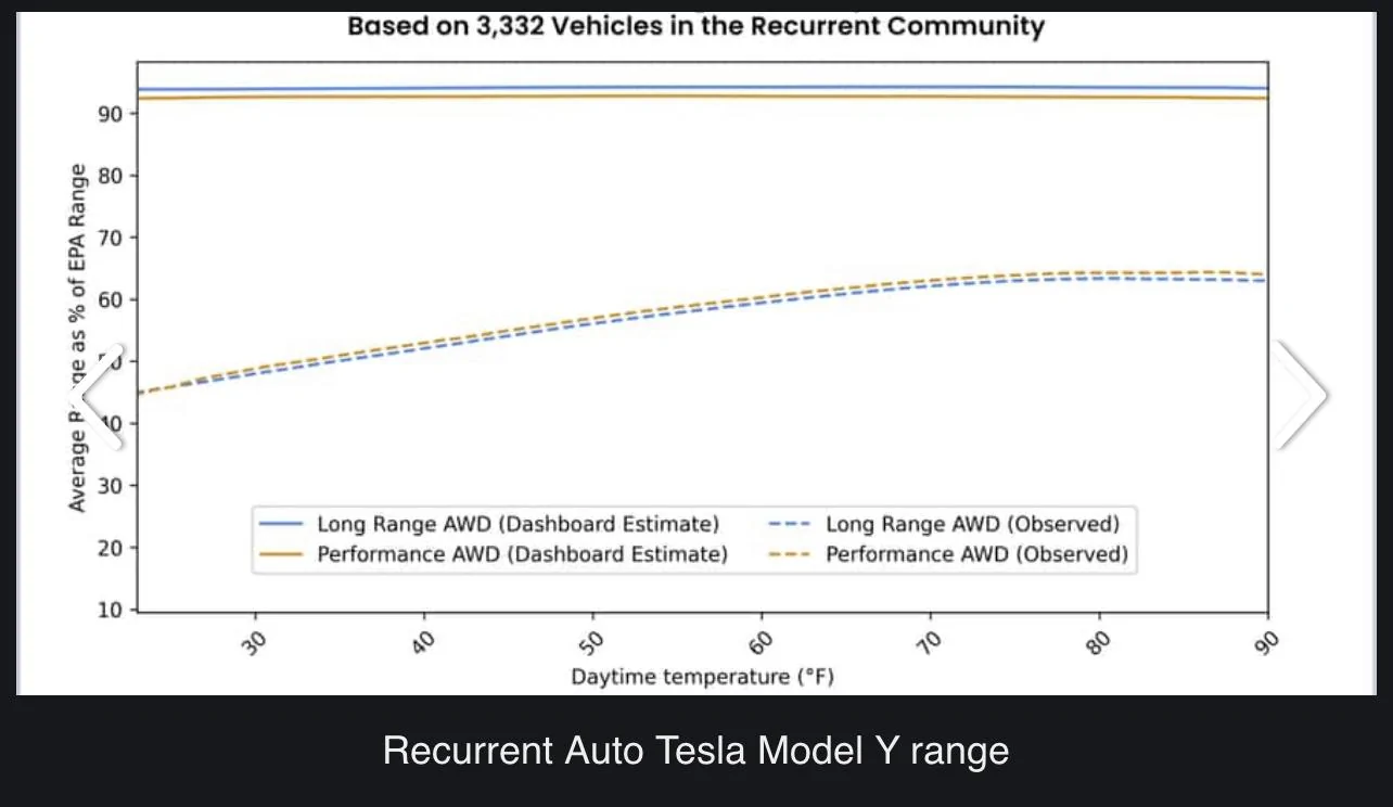

So if it is cold, like it is in most of the country this time of year, you can expect to get 170 miles or range instead of 340?
All of the cold impacts I have seen on the X Y 3 etc have been like 25% max
7,153
13,769
collected data from over 12,000 Teslas, and 360,000 charging cycles, in temperatures less than 30 degrees Fahrenheit, the Model Y had an average range of roughly 45 percent of the EPA estimate. Model S similar.
Less than 30 is pretty cold, though the big study that was done was based on national winter average of 30-50F?
done on data from the vehicles - apparently they can log the car’s temp sensor and correlate to range outcomes captured in those temperatures
Gigahorse
Gigahorse
Dec 19, 2023
2,869
3,256
AWD
Yea was saying that the sub 30 numbers were a LOT worse than the 30-50 numbers if I remember correctly. Something about getting below freezing 32f/0c started to make a really big difference in range.

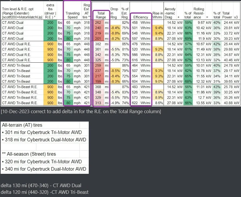

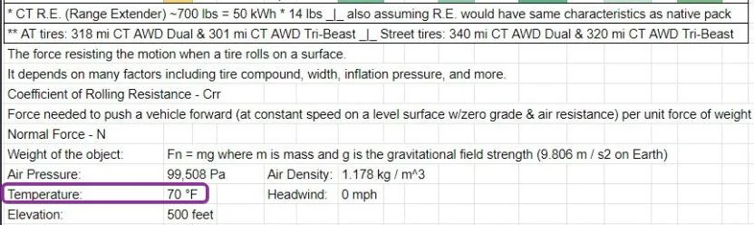

@scottf200 provided some interesting charts that should help everyone on this thread to understand the issue.
Tesla Cybertruck Wh/mile efficiency reported on the highway (heat on, 30°F, 85 mph) IMG_6068
scottf200
Jul 31, 2021
53
2,221
3,241
Western NC
X; immed family 3 & Y
Facts hurt!
In my thread that provide a couple ways to look at that speed-vs-efficiency data, the MotorMatchUp site did define their inputs ... one of which was 70F. [ @cvalue13 gave me some good feedback on that thread too]
The aerodynamic drag for the MY and CT are substantially different, and as such energy consumption does NOT extrapolate in a linear fashion.
This means that with increasing speed a CT will experience even more range loss in comparison to a much smaller and slippery MY.
This is clearly demonstrated in the graph without the annotations, between the Hummer and Eclipse.
Simply the more sensitive a vehicle is to drag, the more the deviation with increasing airspeed.
Maybe this helps compare the MY AWD and the CT AWD, and show how a more sensitive vehicle to drag, results in more air speed induced range loss:

If I'm reading this correctly at total power? Trying to reconcile this against the EPA formula of 1 gallon of gasoline equivalent of 33.7 kilowatt hours.
