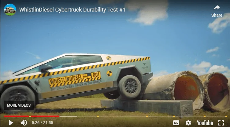

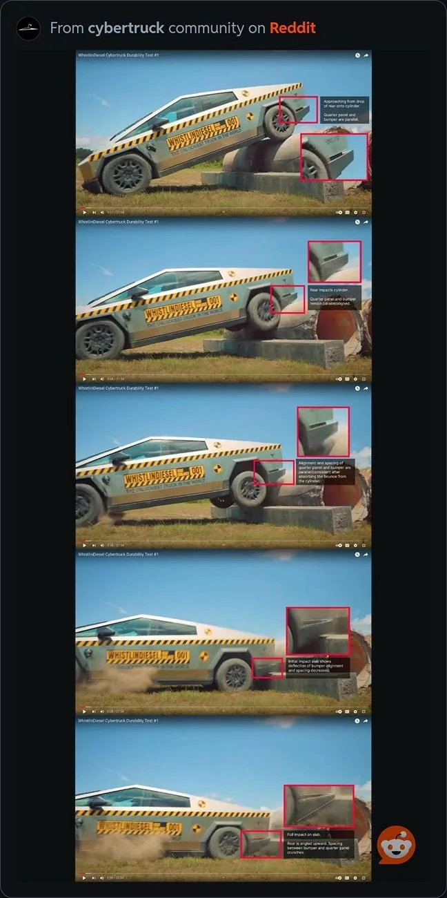

The frame didn't snap from pulling. It broke the split second after this picture:
After the frame was cracked/broken when dropping the weight of the truck onto it from that height, it didn't take much force to pull apart the remaining pieces holding the bumper and hitch receiver apart.

This is why the hitch ripped off.
Important to note… the ford couldn’t get across the pipes. It probably would have ripped the whole rear Axel and bed off the F150 from that pipe drop. Such a terrible comparison. The CT got further so it got punished more… plus they didn’t know how to activate the appropriate modes, they didn’t even know how to charge it.
