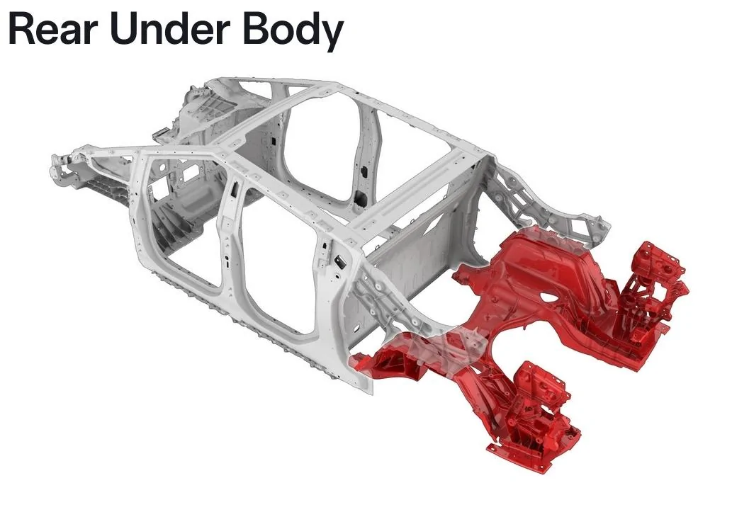

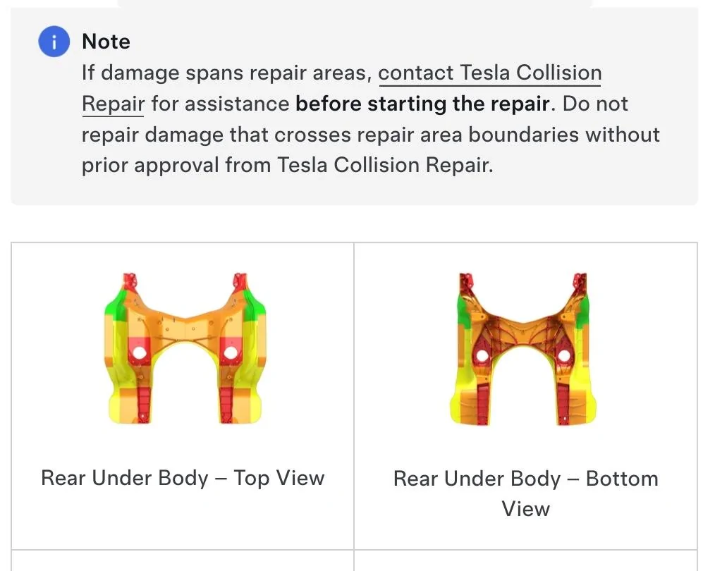

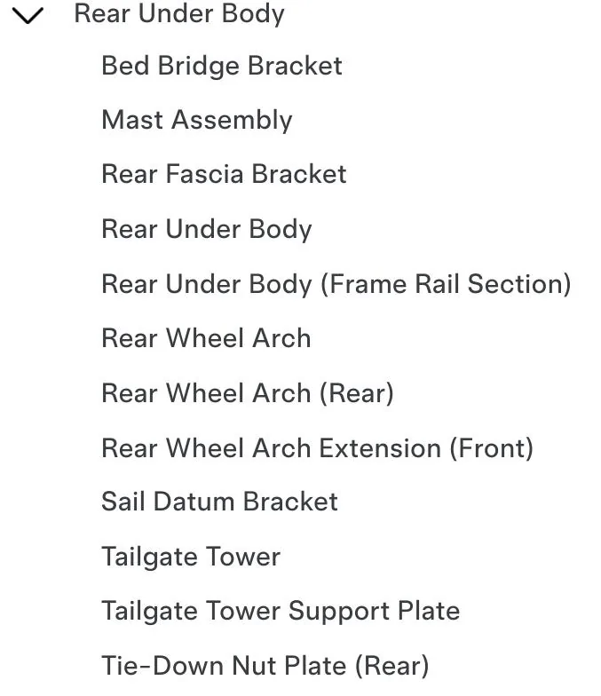

The casting isn't designed to be replaced as a single part, as the casting replaces multiple welded parts.
There's supposed to be bolt-on replacements for the crush cores that provide that rear support.
The casting is completely replaceable when damage is too severe for repair. Crush cans are mostly a front casting thing. Cybertruck has rear energy absorbers which are bolt off/ bolt on.
From the collision guide:
The criteria to determine if a cast Rear Under Body component is repairable or if the Rear Under Body must be replaced are based on both the severity and the location of the damage. Use the images and information below to determine if the Rear Under Body component may be repaired or if replacement is required.
