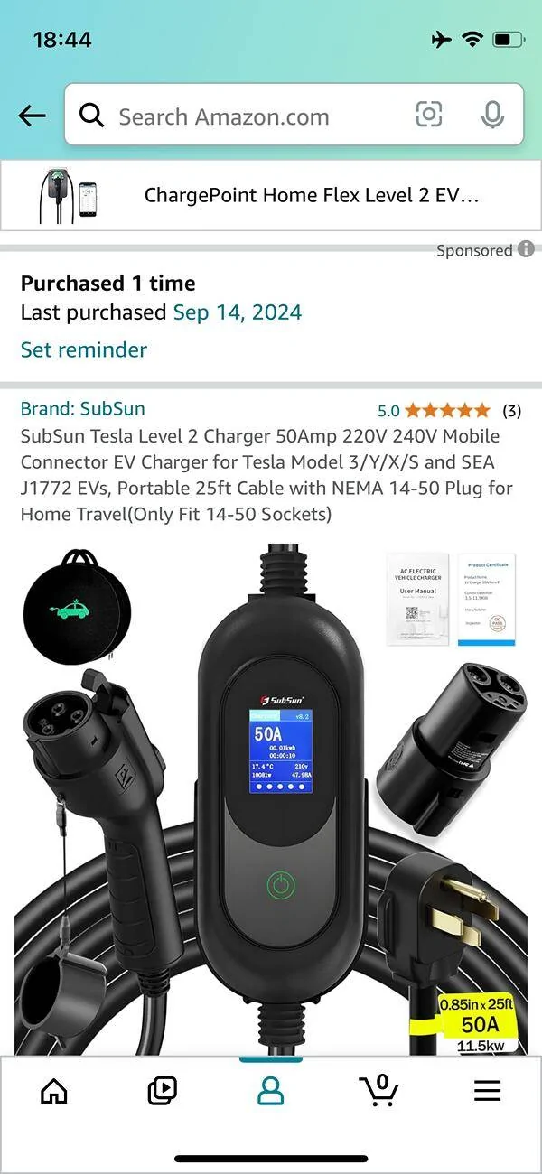

The real challenge is in the electrical work, not the wall charger. An electrician can run 48-50 A lines and on can plug in a $300 50 A wall charger from Amazon
Tesla Cybertruck Why isn’t this charger on the Tesla Website 1726443871045-vx
Tesla Cybertruck Why isn’t this charger on the Tesla Website 1726443969689-ti
I have personally done all of this and am apocalypse-ready. Pocketed the $2,500 store credit
