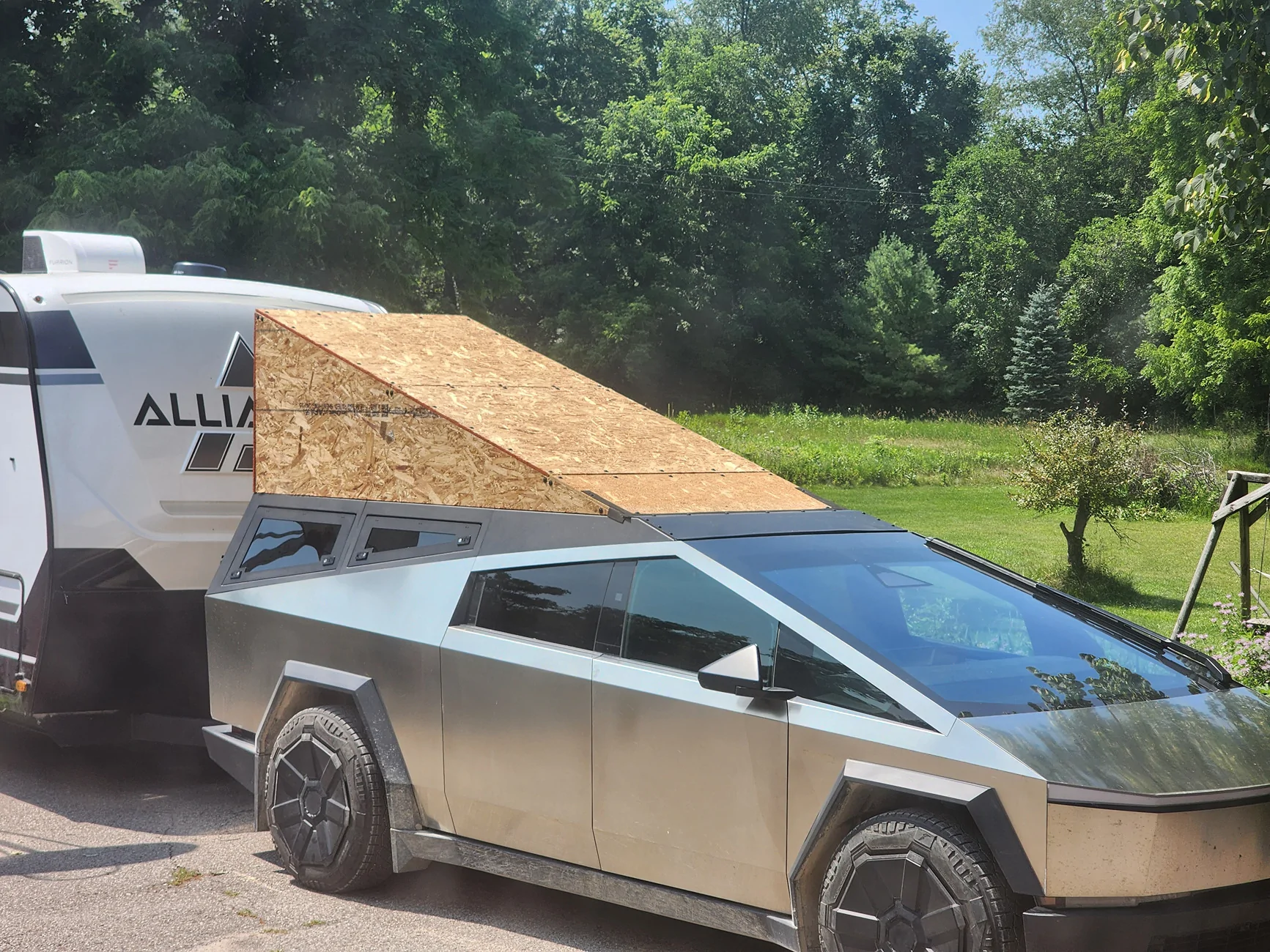

Tesla Cybertruck Wind Deflector tested for towing range improvement 20260714_151406

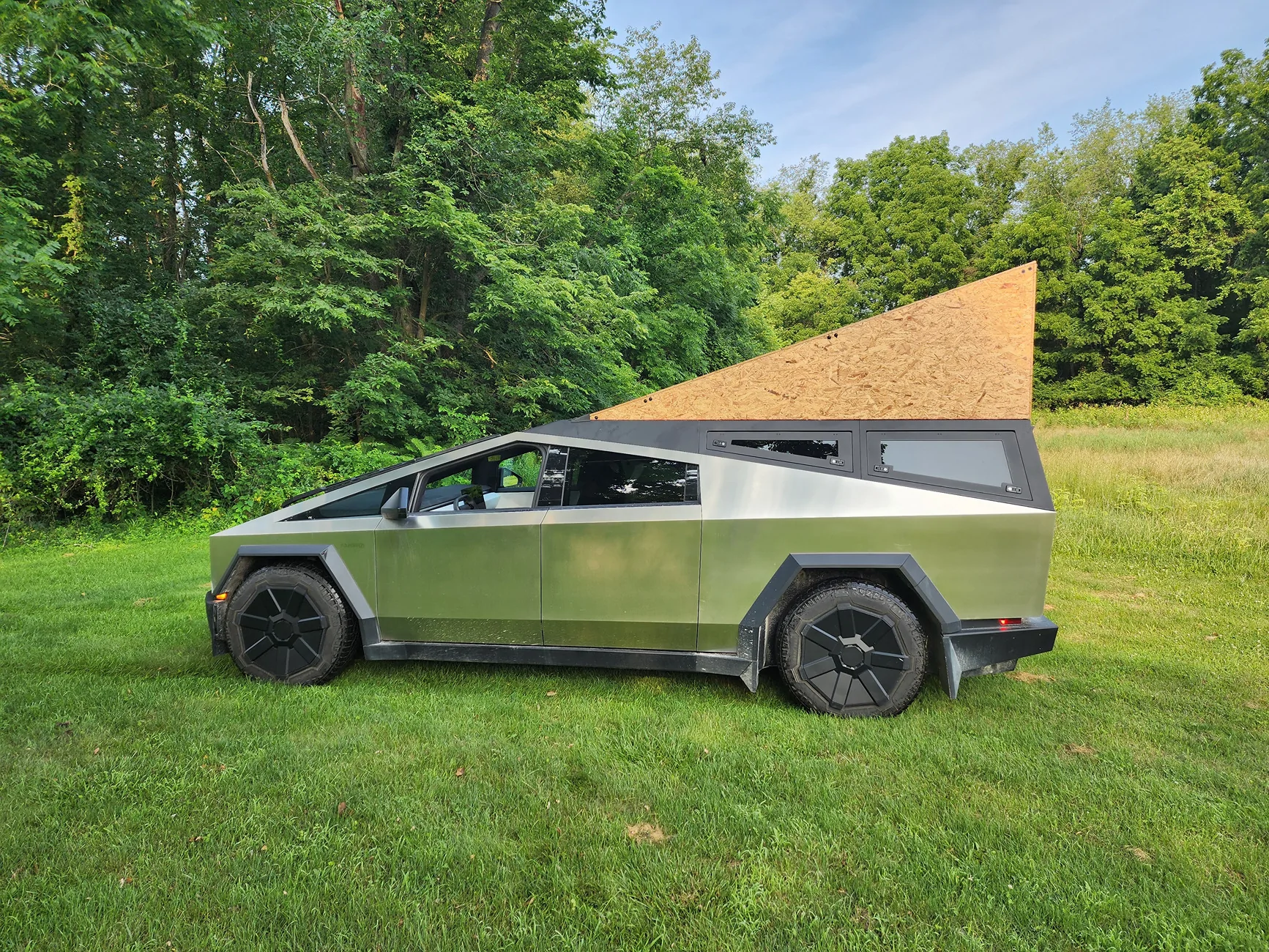

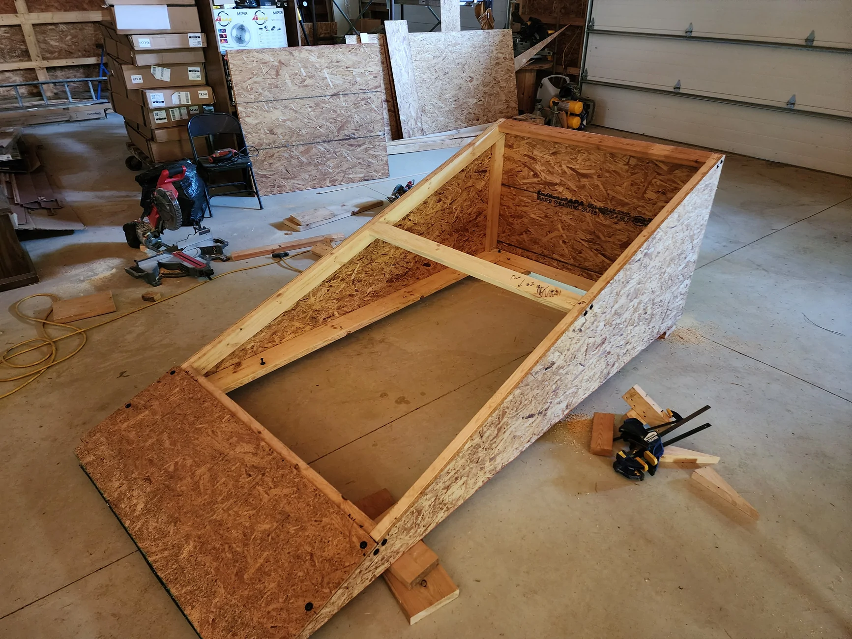

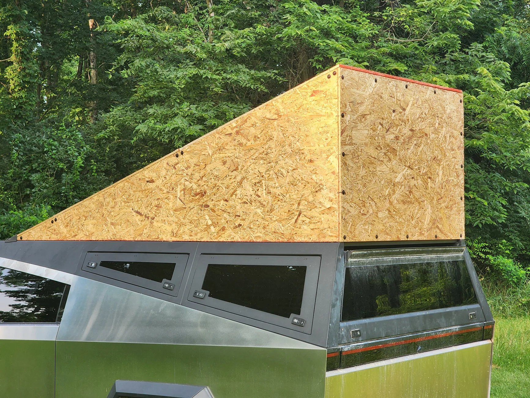

After getting the Urander enclosed bed cover installed as a base, I assembled this monstrosity we call (chesse) Wedgie.
Used OSB because Menards had 4x9 sheets and the final dimensions are 4.5'x9'x3' so only needed 3 sheets. Doing it in a more durable material will take six or so.
Seems to reduce Wh/mile by around 10% at 65MPH (1075 vs 1200), but that was only one test run. And I found out afterward that Teslamate had stopped logging 🤦‍♂️ (fixed that this morning).
Drafting (following distance of 7 in TACC) a semi at ~62MPH we were at 750Wh/mile 🤩.
Tesla Cybertruck Wind Deflector tested for towing range improvement 20260714_082957
Tesla Cybertruck Wind Deflector tested for towing range improvement 20260714_083014
Tesla Cybertruck Wind Deflector tested for towing range improvement 20260712_084816

I was thoroughly confused until I saw the last picture.
Wind deflector for Urander enclosed bed...out of OSB...on top of it 🤦

It's a prototype to see it it's worth making a pretty version 😀

Good Sir - Might I recommend a rattle can or two of black paint?
Yes, but that doesn't really seal (and would take ~5 cans just for the outer surface). Had also considered just going with rattle can bed liner. OSB needs a coat or two of oil based primer like Kilz shoved in the cracks with a stiff bristled brush followed by top coat of exterior paint.
Which I wasn't going to do until I had some actual test data. Paint costs more than the wood. It's a process, not a product.
