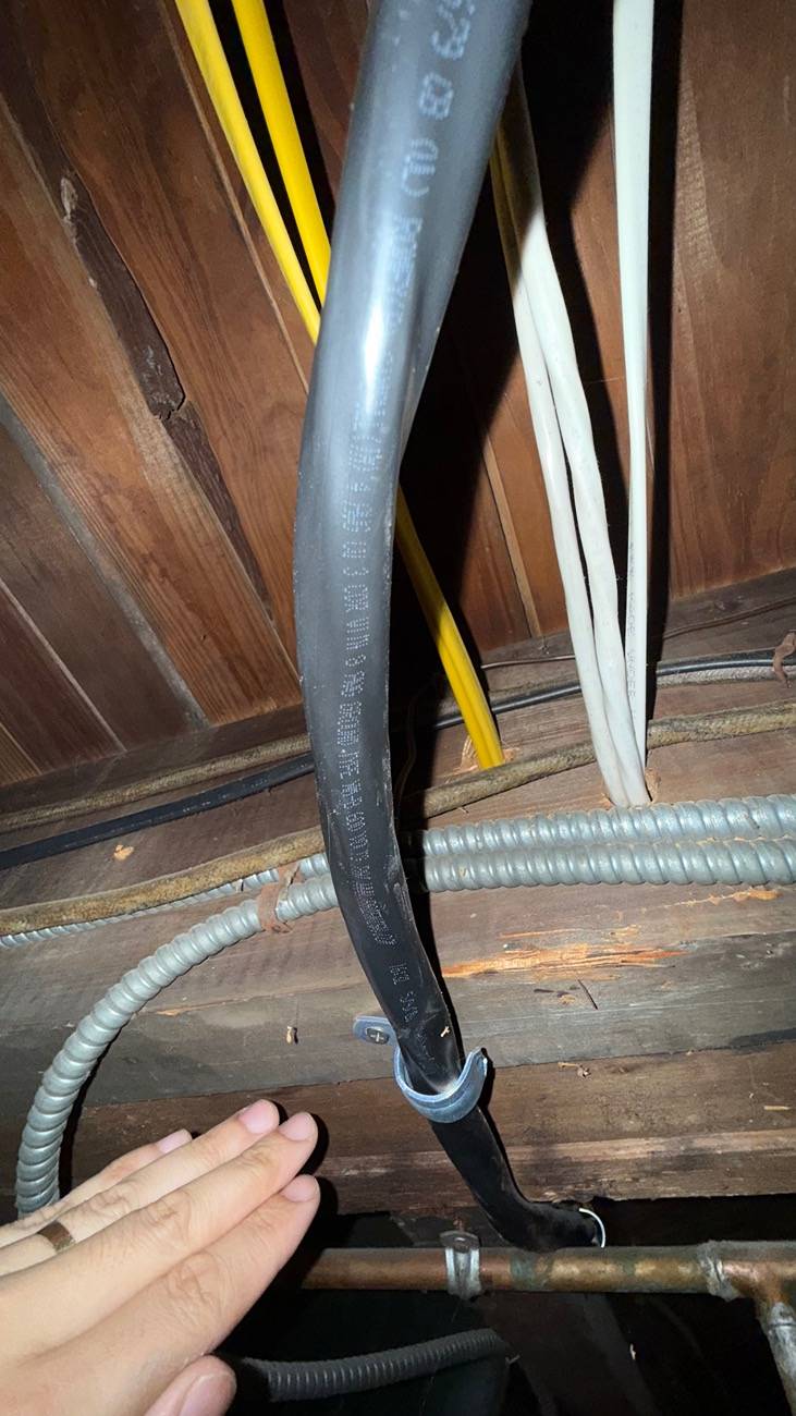

So “control wire” would be a new wire nowhere near the size/price of the pictured existing wire running from the circuit breaker to the existing first gen WC. Correct?
This control wire would enable communication from the new universal wall connector and the PowerShare gateway. (I’m only getting a partial backup install of a few circuits)
So I need a new run of 20 feet of #22 ga communication wire, NOT a new run of 20 feet of 4 AWG $1000 wire? Correct?
If the partial backup is from the Gateway or a subpanel the wall connector isn't currently fed from, the branch circuit will need relocated there.
20 feet of 3x4AWG 1x6AWG SER is only $200.
https://www.wireandcableyourway.com/ser-cable
Comms wire is much smaller gauge with twisted pair for the RS485.

Based on what people have said and what the wire looks like it says. You have 8AWG, the only think I can think of on the power side is distance. If its extremely long you might need 6AWG but I can't see any reason for 4AWG.
Personally this is what I used SIMpull 500-Feet 6 -AWG Orange Stranded Copper THHN wire ( By-the-roll ). I just bought a roll of it, and a roll of 8AWG grounding wire to go with it.
They have 4AWG now, only the ground in it is 8.
NM-B requires the use of the 60 degree rating. So to get 60A (48A continuous) requires 4 AWG. 6 in NM-B is only rated for 55 Amps.
Copper THHN at the 75C column would only need 6 AWG. 8 AWG is too small for the phase conductors.
Yeah, the comms wire is 16-24 AWG, 4 conductor (2 twisted pairs), shielded wire. Nothing too fancy, but it's not going to be the unshielded wire used for doorbells, door/window sensors or thermostats.
