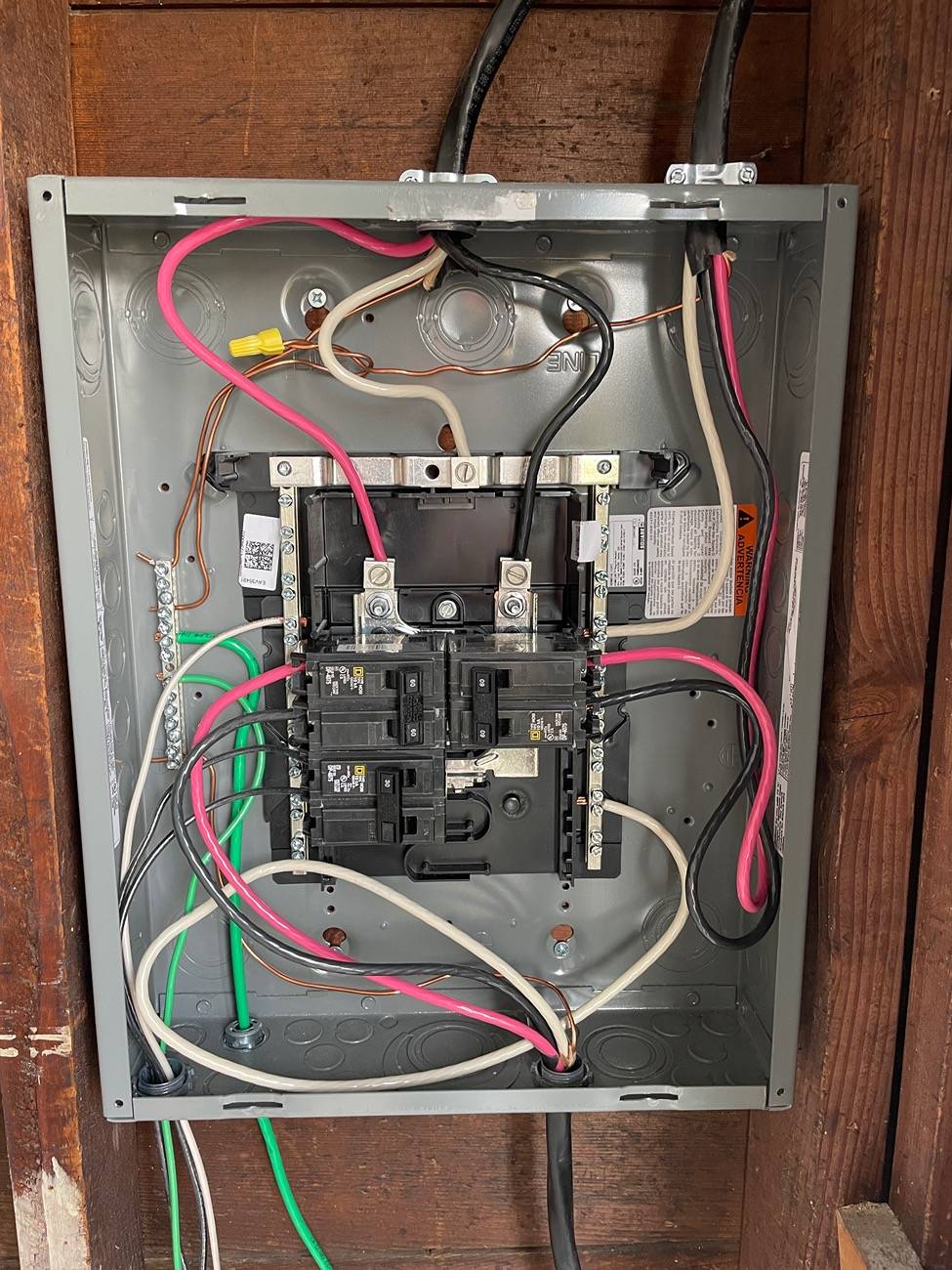

As others have said your current wiring for your WC will work for your UWC.
The comm wire also is correct, I have a 22 gauge 4 wire running to my UWC.
I have a FULL panel backup using the PowerShare.
Also Group Power Management is NOT possible while using PowerShare. I am not saying you can’t put it on your other WC, but PowerShare will not work if you have your UWC setup in the group power management system.
I have 3 WC, one being the UWC. My to WX are setup in group power management, while my UWC is just set for standalone.
ALL 3 wall connectors are using the same 60amp breaker going to a sub panel where each has their own 60 amp breaker for full power when running by its self.
The only issue is I can not charge my Truck using the UWC while any of my other cars are charging the other WC as it will trip the breaker. So I have schedule charging for my other cars using the group power management. Yes it sounds complicated but it isn’t.
Now to your PowerShare and powerwall. No you can not use this setup yet. Tesla still is waiting for an update. Just like I waited 6 months after my PowerShare install to get it working because I have solar.
Photo is before he installed the 3rd breaker for the UWC.
Cough *conduit* cough ?
