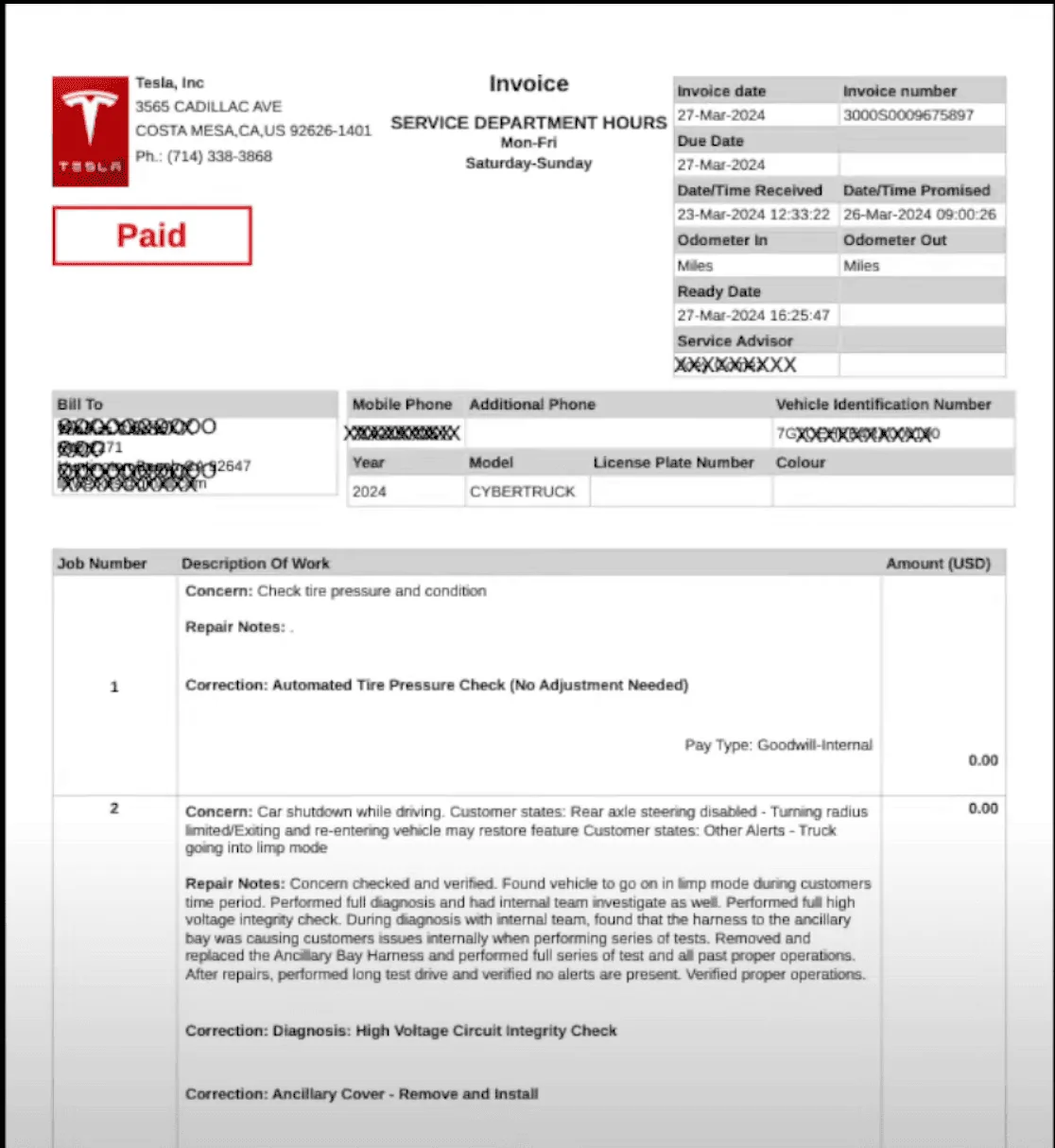

IF this is the ancillary harness power loss issue reported in January, which is at least plausible because losing 48v will shut down the steering system and put the truck into not-gonna-drive-for-ya mode, the service bulletin is here:
https://service.tesla.com/docs/Serv...Harness_To_Address_PCS2_Harness_Retention.pdf
Most of the cybertruck is maybe not so bad to work on, but replacing this harness requires accessing the high-voltage connections buried under the tonneau system and air suspension reservoir. See instructions below:
https://service.tesla.com/docs/Cybe...UID-A46728FB-7B3F-4E09-8D32-057D591326DB.html
The harness itself is simple by automotive main wiring harness standards.
https://service.tesla.com/docs/Cybe...-DC13-4049-B34D-2B3D41296589-online-en-US.jpg
This job can be done at service centers, but it isn't a fast job and removing the tonneau system requires a special jig.

something I missed, I figured I'd share..at the end of this video (time stamped to the part I'm talking about) this guy shares the service paperwork, you'll notice the car was dropped off on a Saturday and he got it back on a Wednesday, that's not bad at all for the infamous harness fix, considering service is closed on Sundays. And his error is nearly exactly the same as mine, so fingers crossed.
Tesla Cybertruck Worst delivery in my life (truck died in 5 minutes) UPDATE: FIXED Screenshot 2024-04-01 at 4.54.11 AM

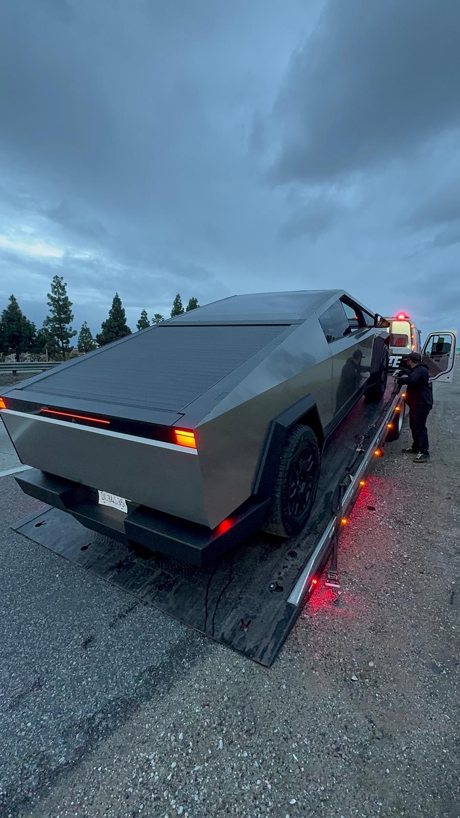

Took delivery today, AWD.. made it 1 mile down road, started getting steering error, flashing red screen, pulled off side of highway now the truck is dead and I’m waiting for a tow truck. Dealer couldn’t do anything for me. It was great for 5 minutes.. tried everything, restarting, screen is stuck black and keeps beeping
tesla really rushed these trucks out, what a nightmare.
