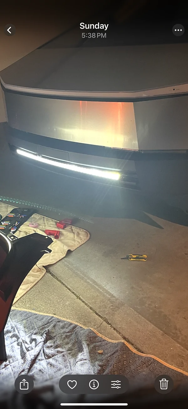

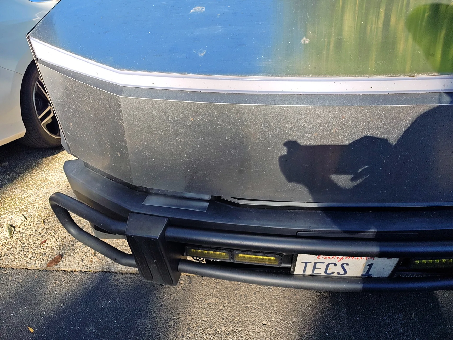

On 100+ days of skiing a year between the Sierras, Rockies and Montana, I’m usually in 5-10 blizzards a year and a good 25-35 days of typical snowfall driving. My solution was the TSportline 40” LED Lightbar Bumper insert. I’ll use either an amber or yellow lightbar cover or film over it.

Like the idea, may result in less snow pack. May need a heating element on top of the bumper though as snow would still stack up there.

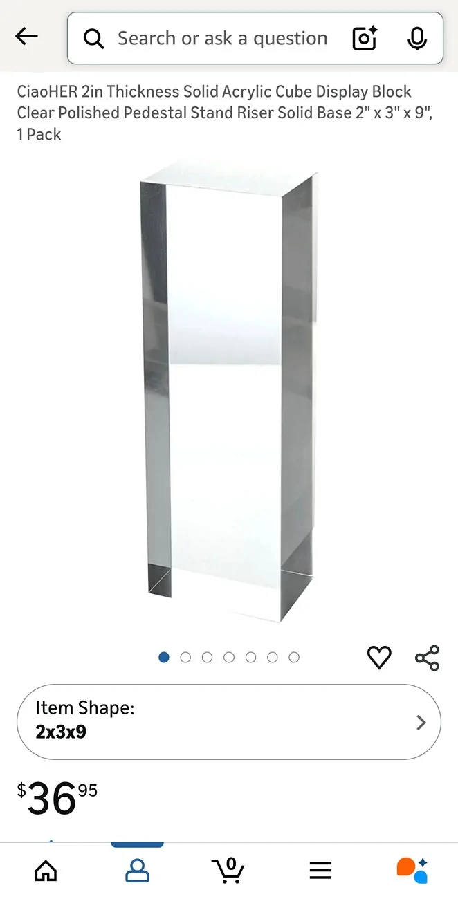

I like easy: to get, to mount, to unmount. Found and ordered 2 of these.
Will mount with Velcro, and get back to y'all
- was it effective keeping snow clear?
- does it distort the headlights?
We shall see!
Product link:
https://a.co/d/itFcpnQ
We shall see!
Product link:
That’s way cool Griz. How resourceful.

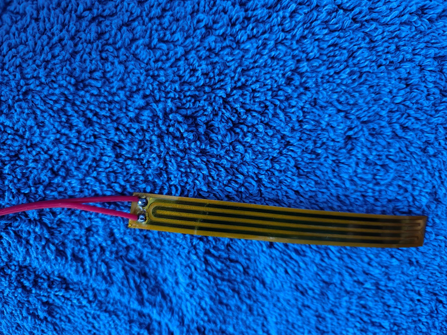

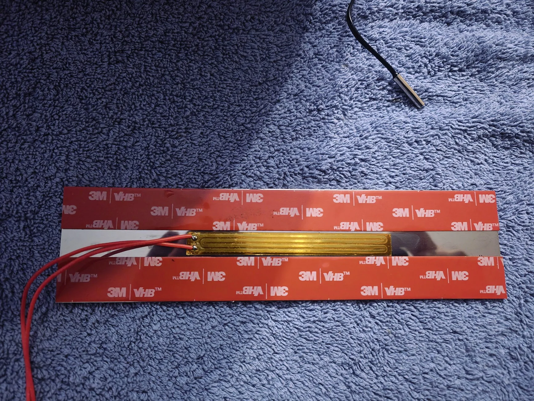

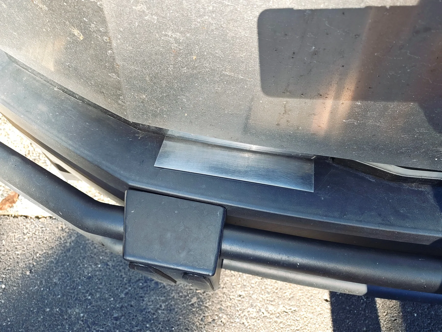

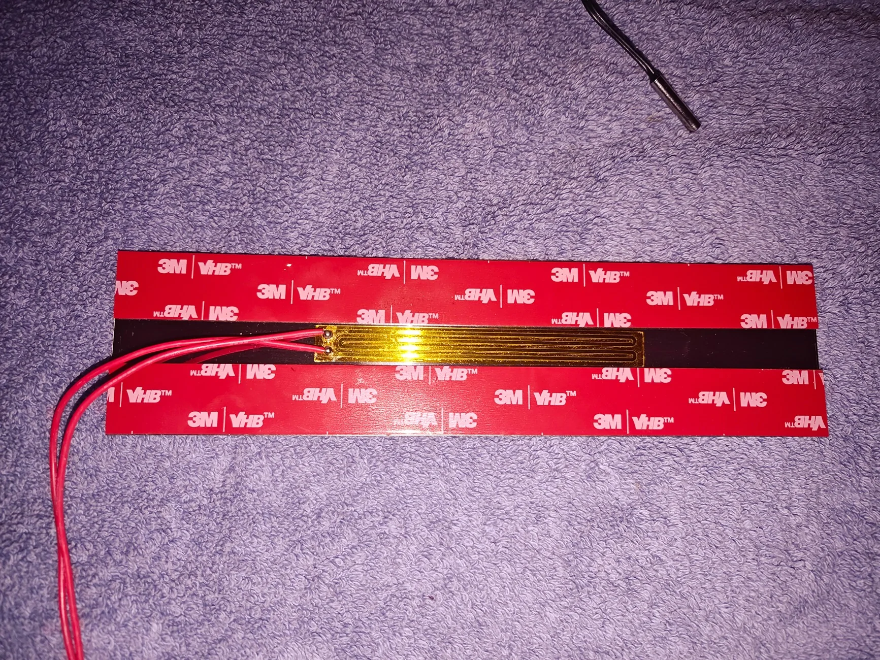

Been working on a solution for this. Not mounted yet but i'll show what i have so far. Its 2 stainless steel plates 2" x 8" with a 3D printer heater mounted below between 2 pieces of 3M VHB tape. in testing it melts ice in less than 30 seconds and reaches a temp of just under 200f. still have to mount it and do real world testing at sub zero with 80mph wind chill. but i think it's got enough headroom. I was originally going to go with black, but it's never a perfect match, and with the raw stainless i don't have to worry about paint peeling. and stainless kind of goes with the truck.
I changed the wires to black, and cut a slot in the 3M to bring them out at the corner. with any luck you won't see them at all.
